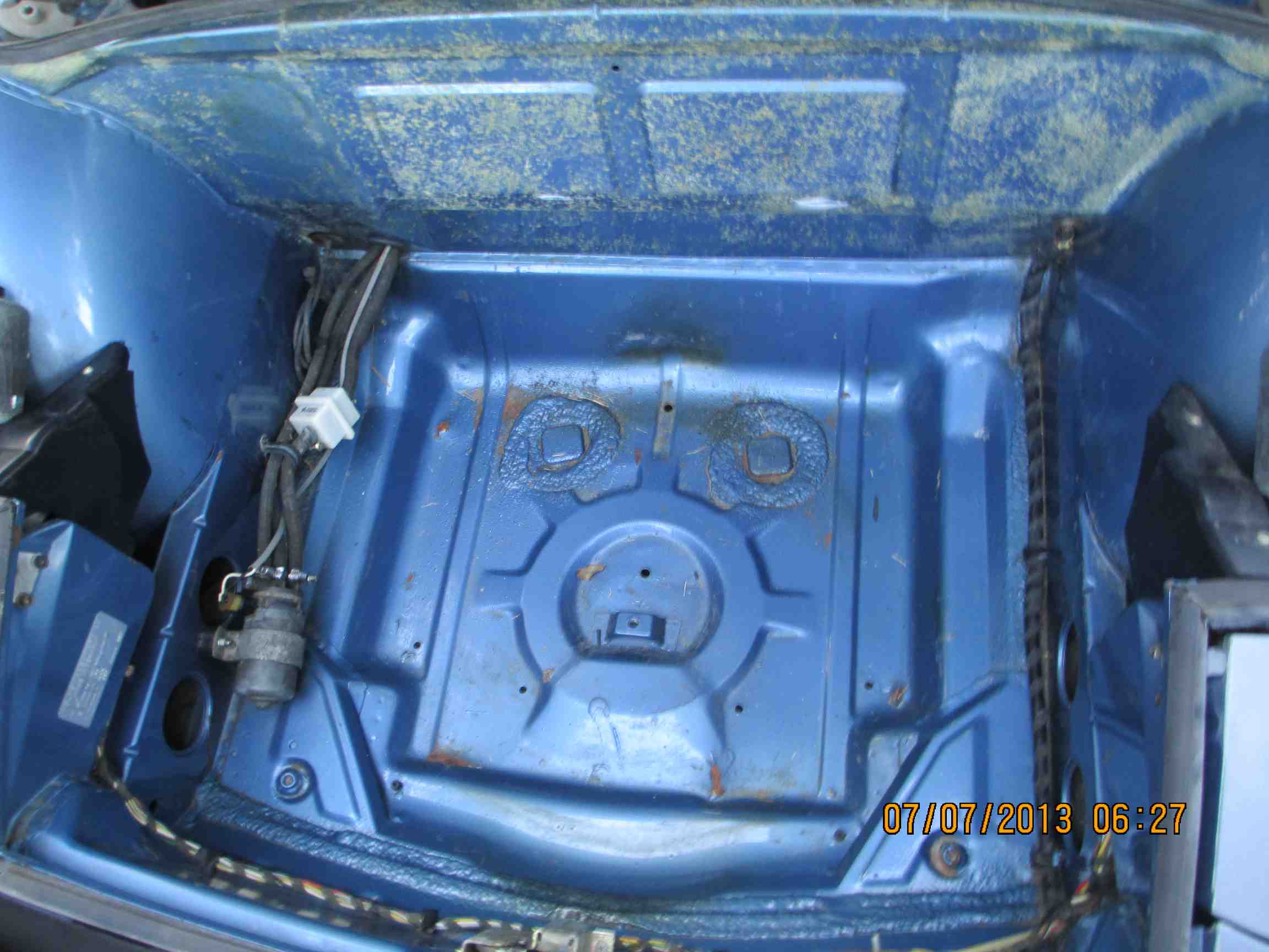

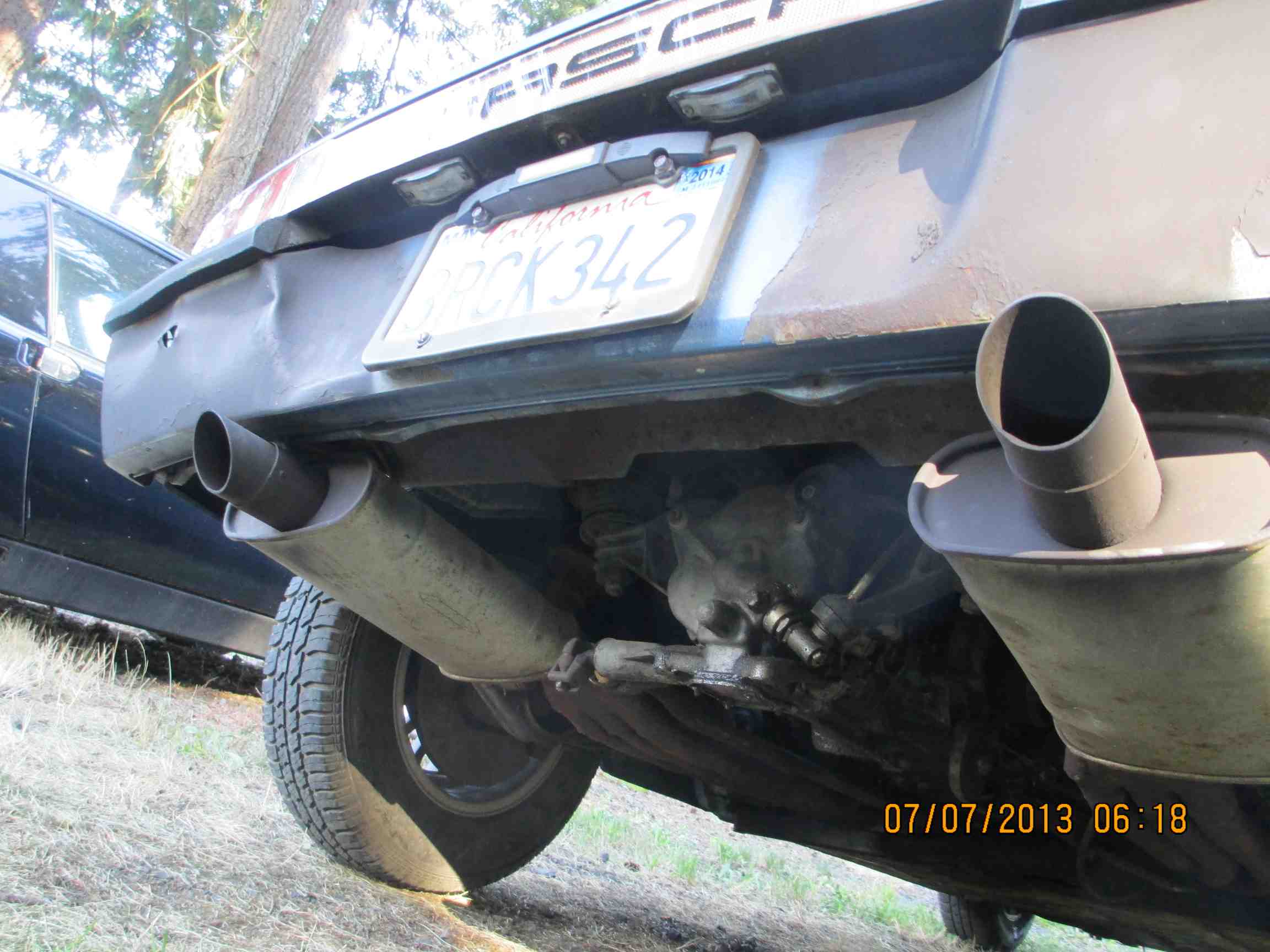

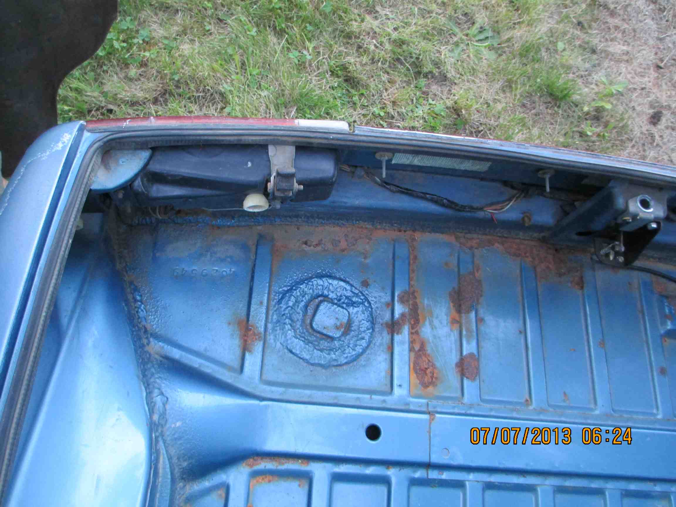

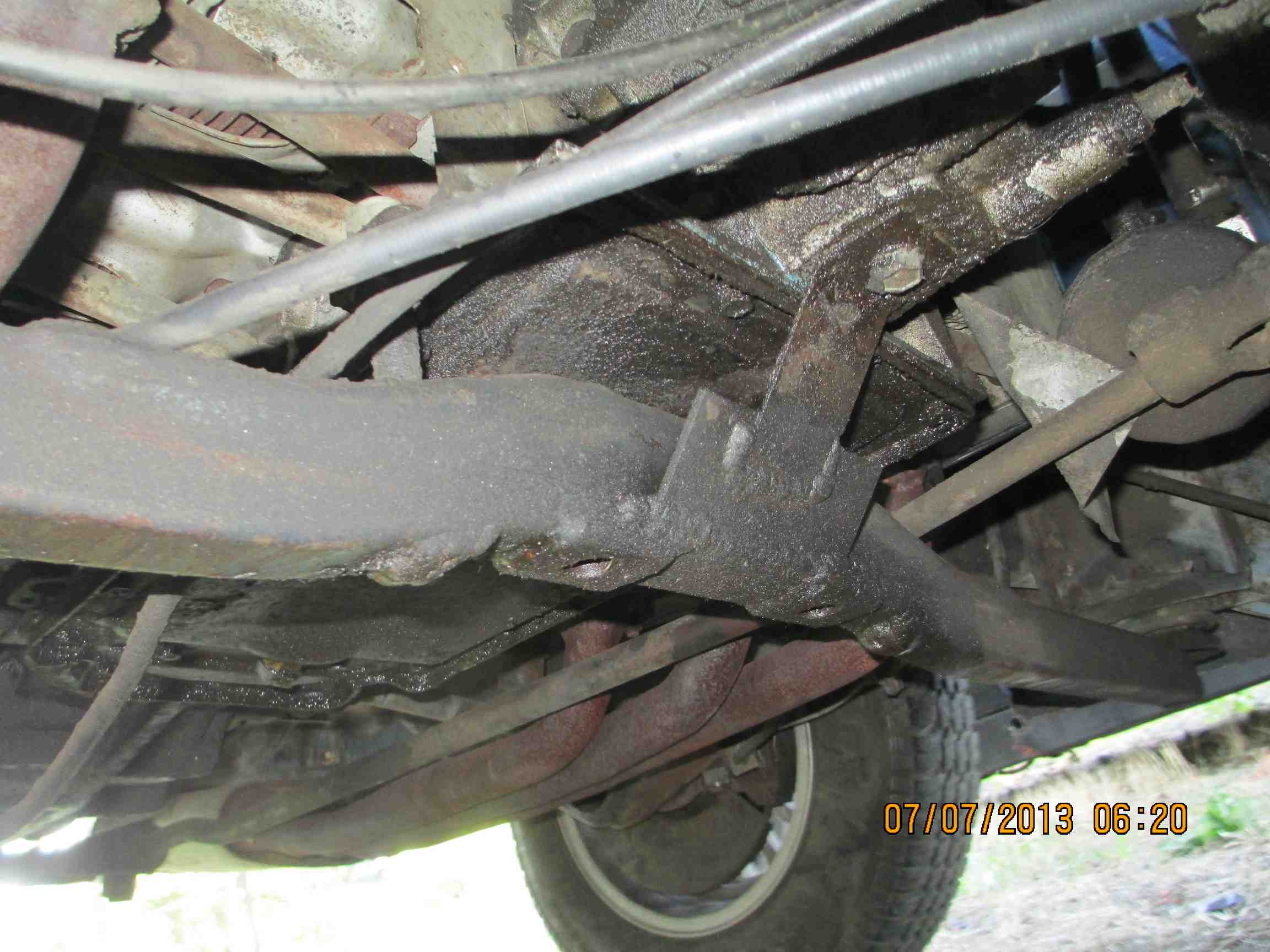

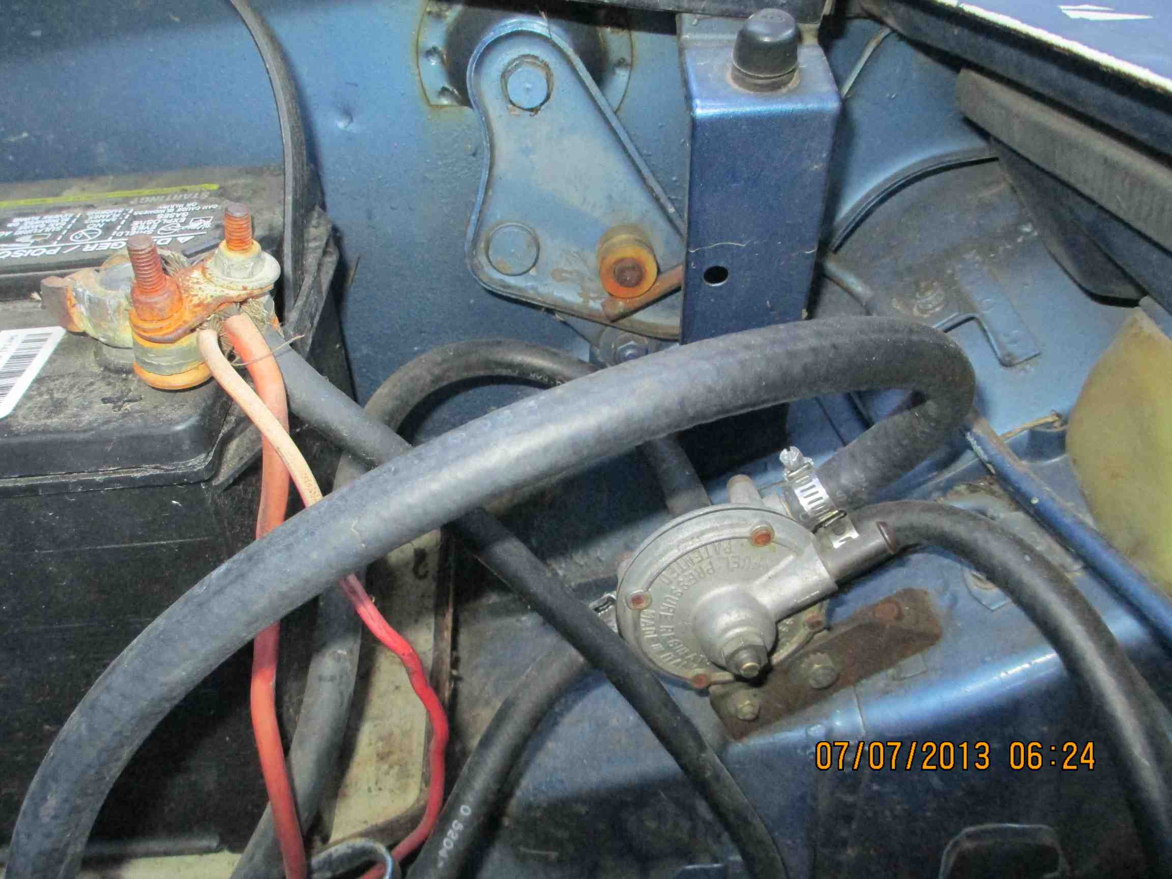

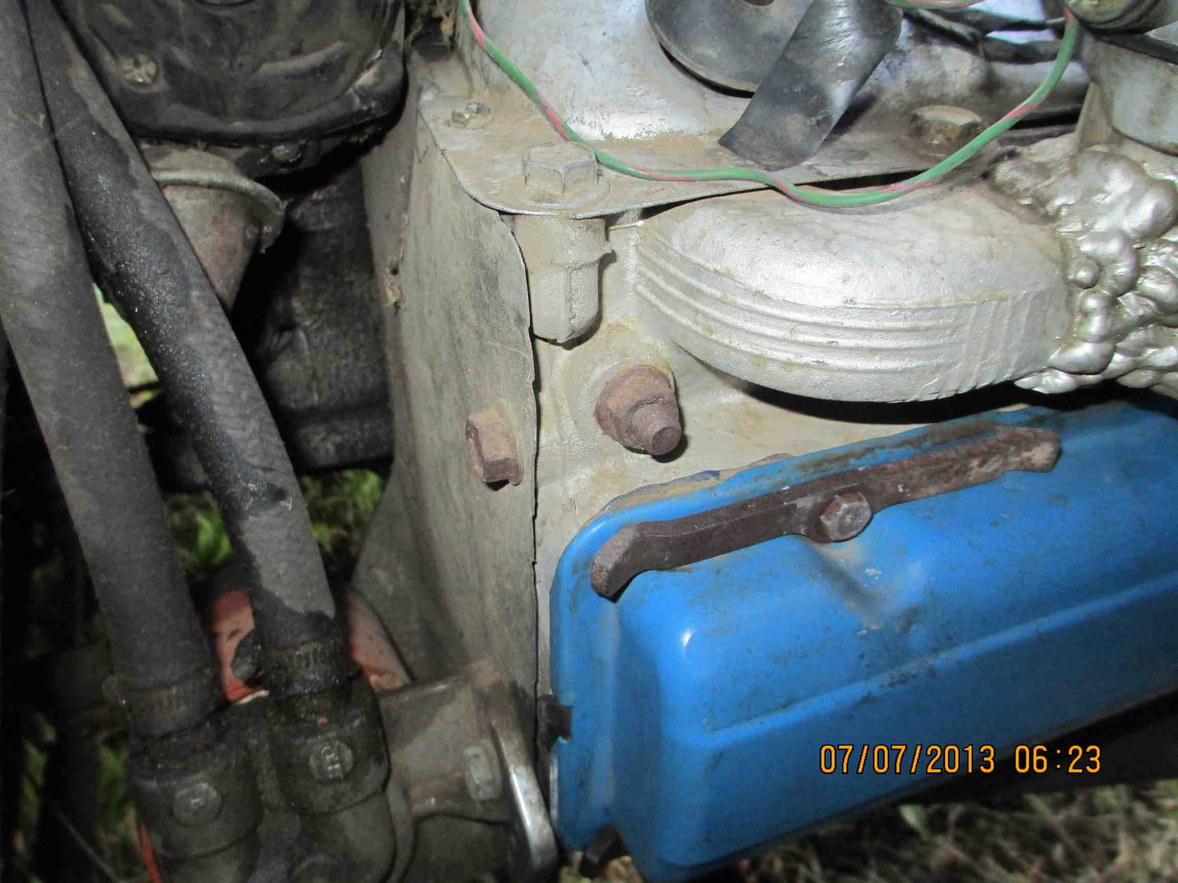

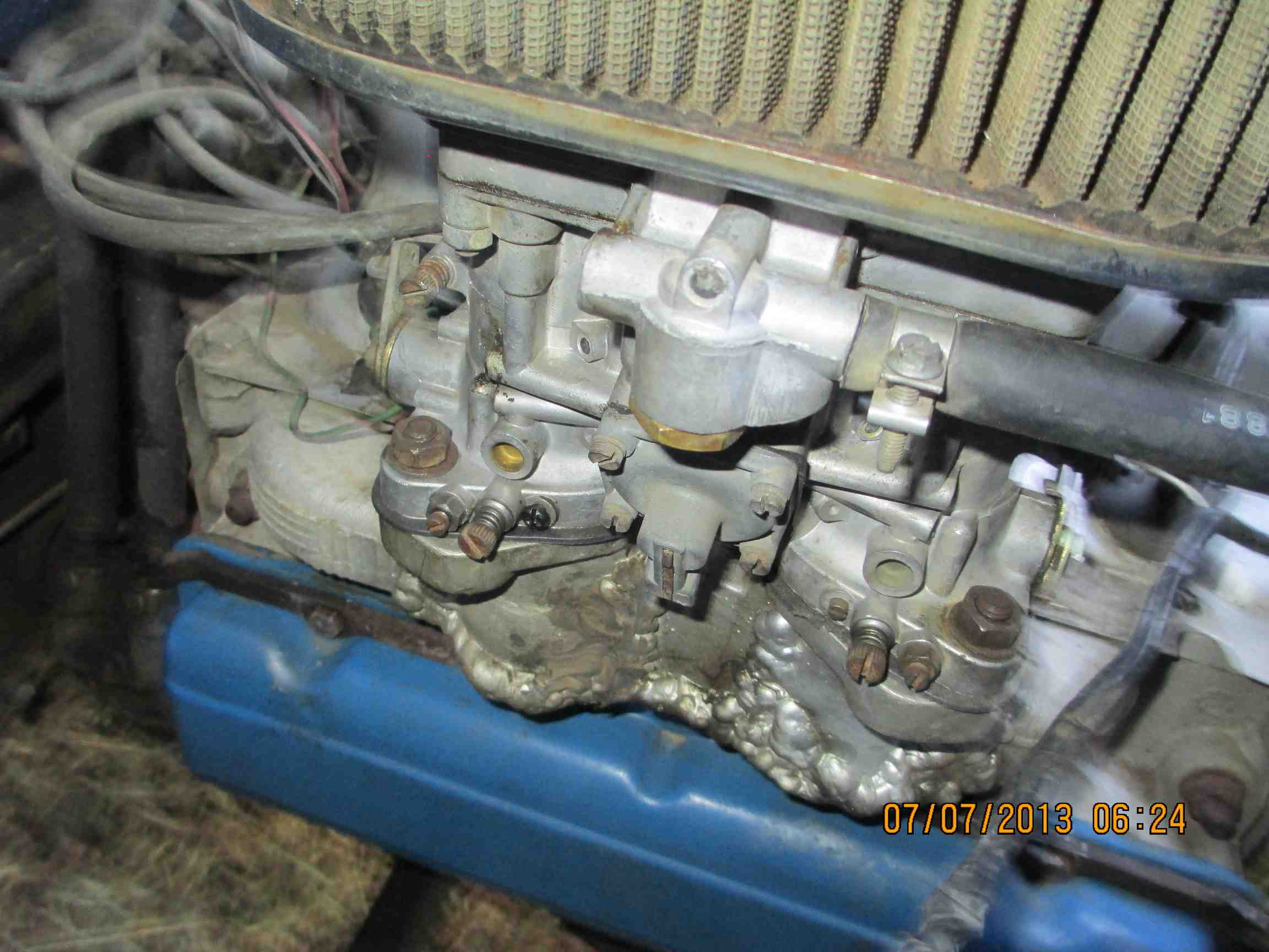

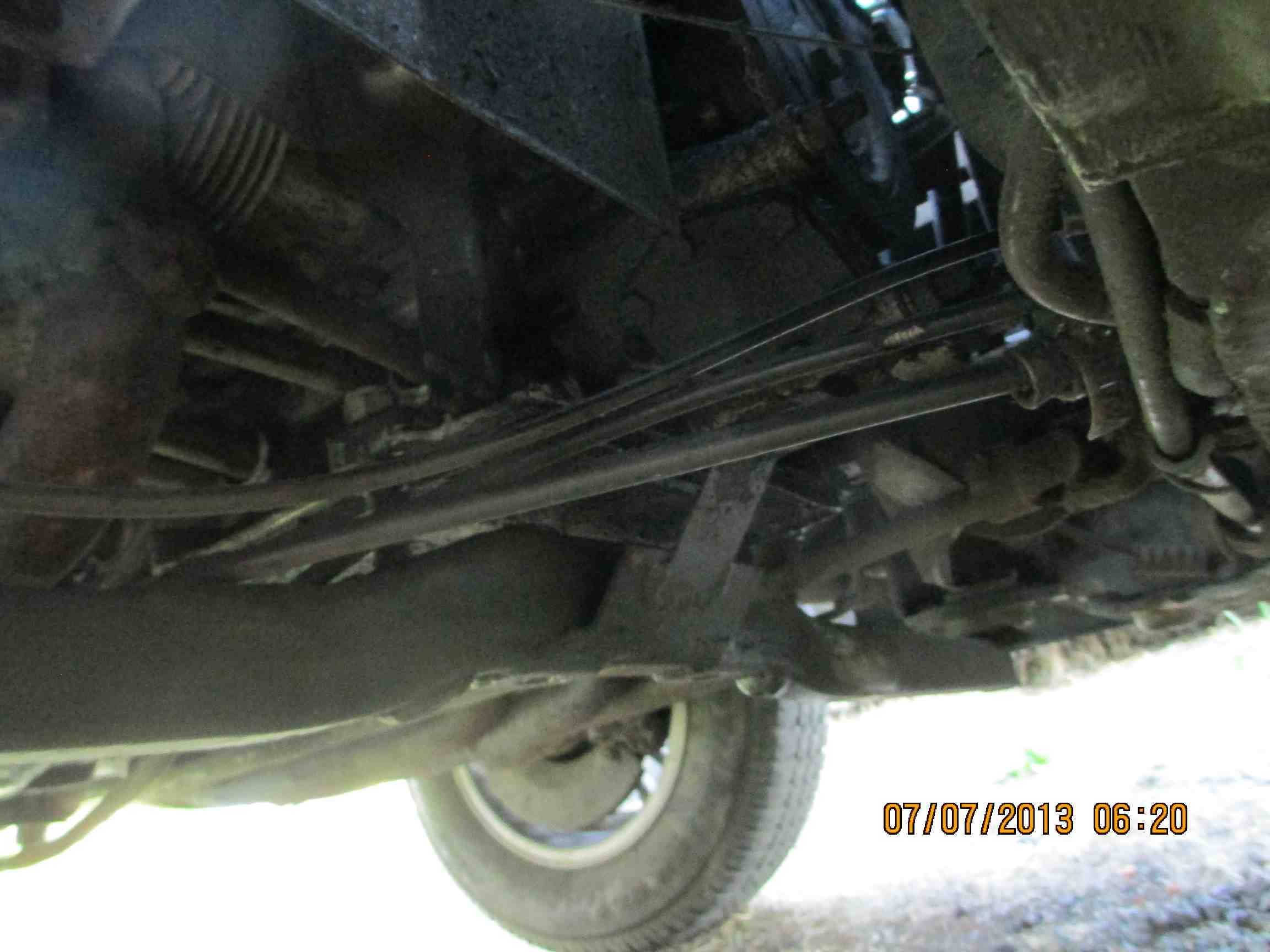

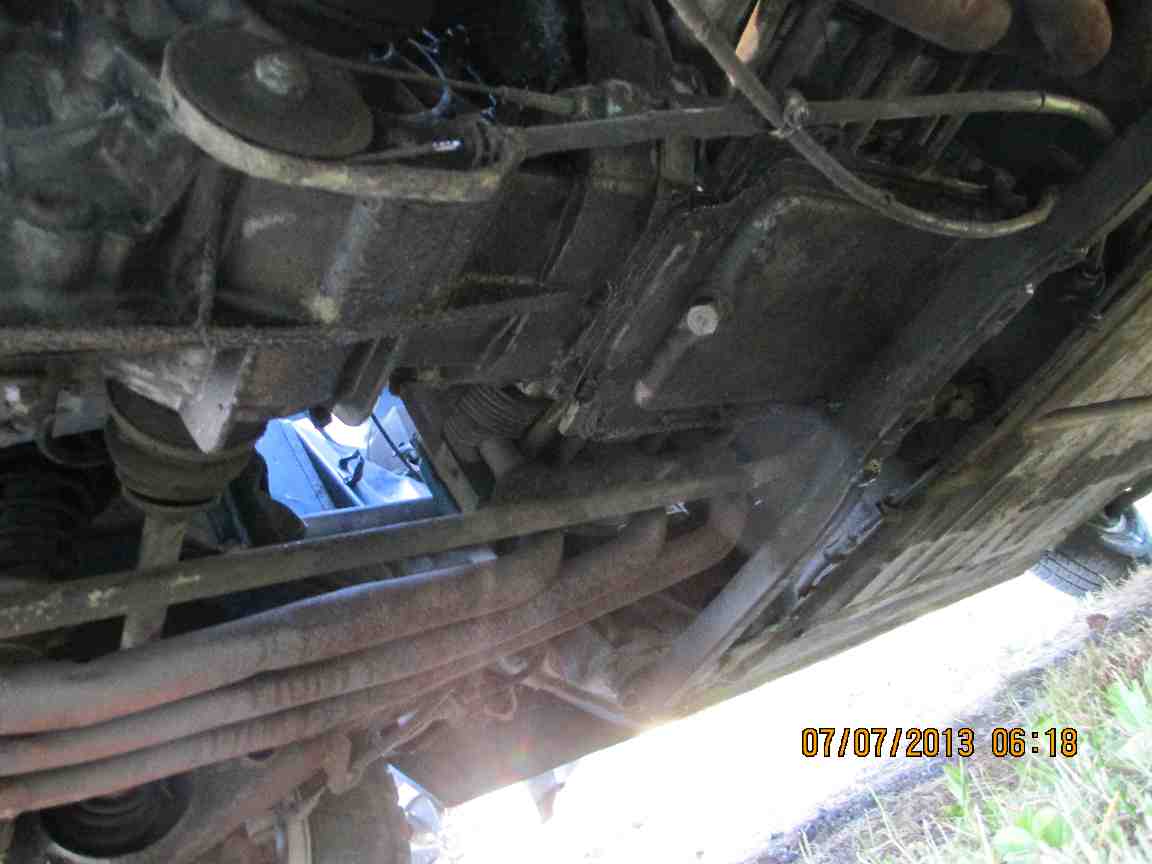

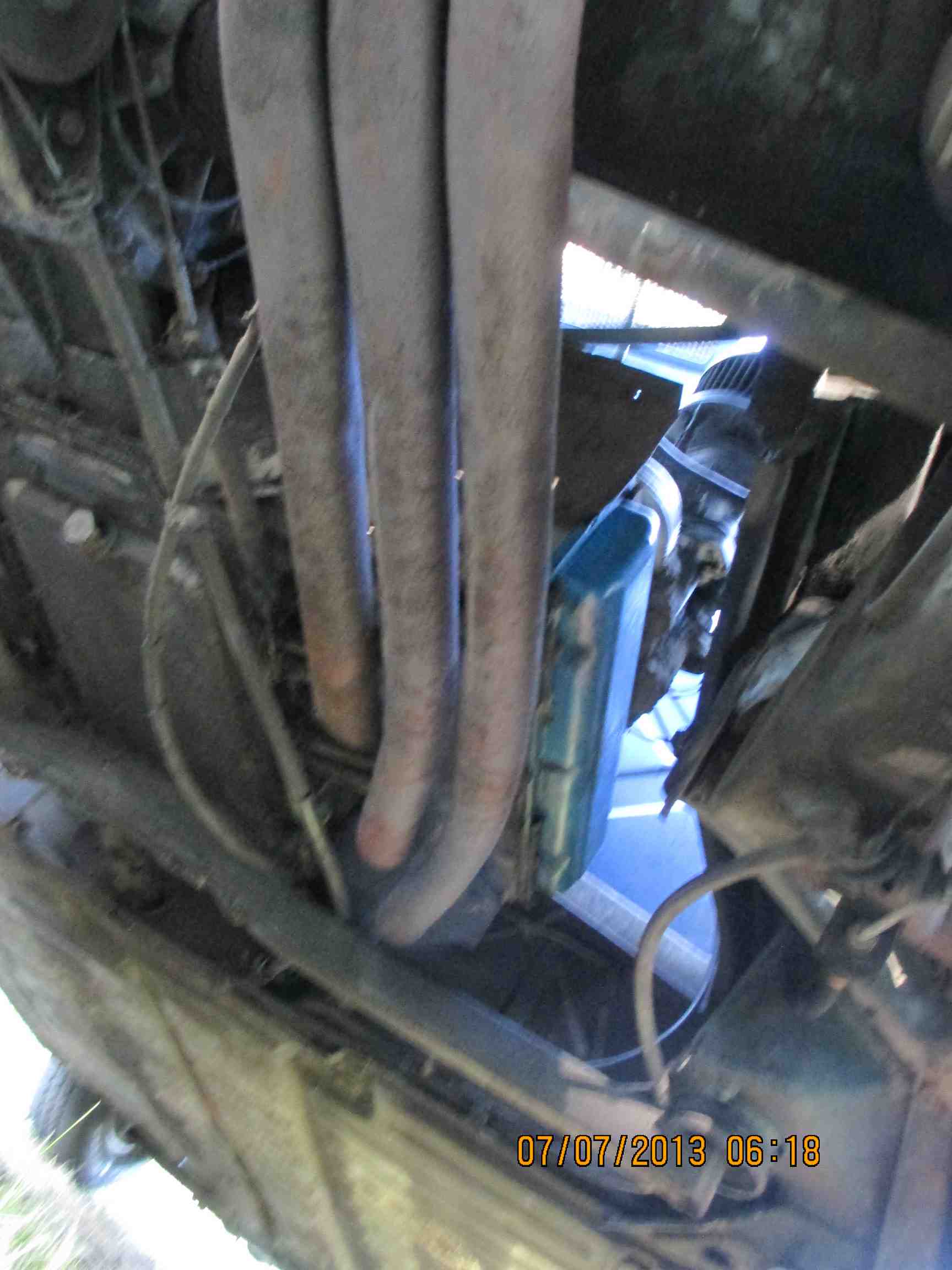

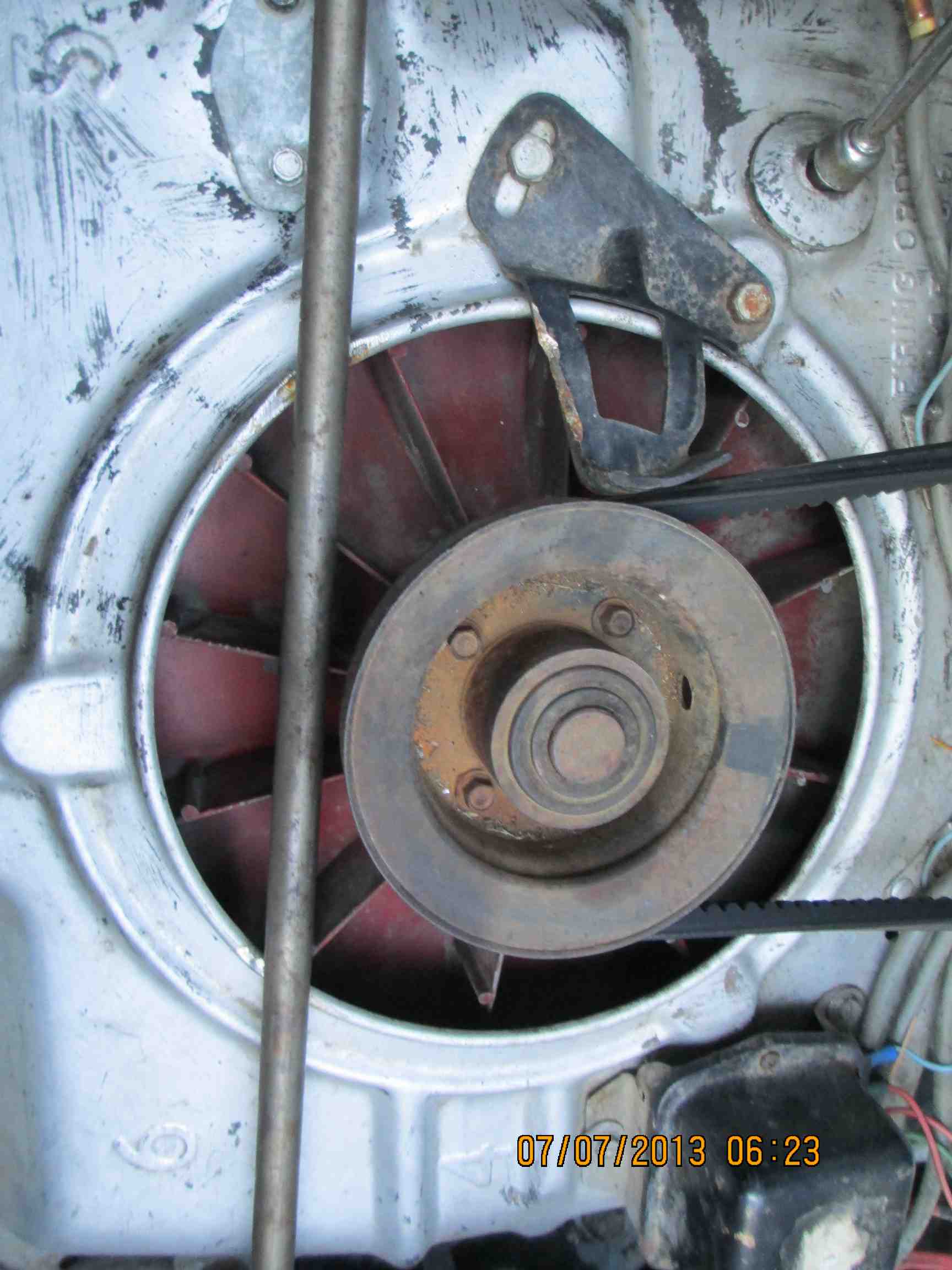

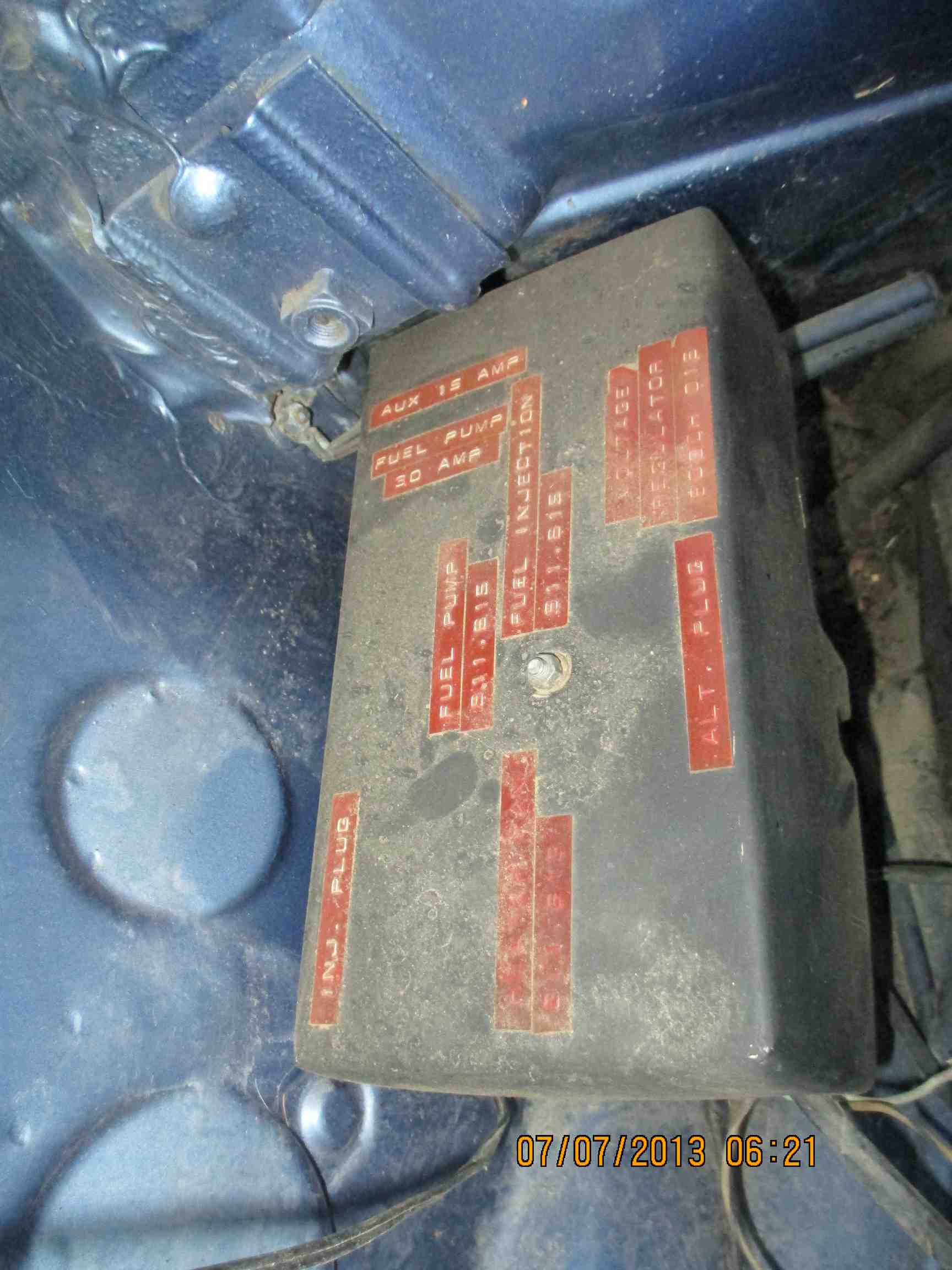

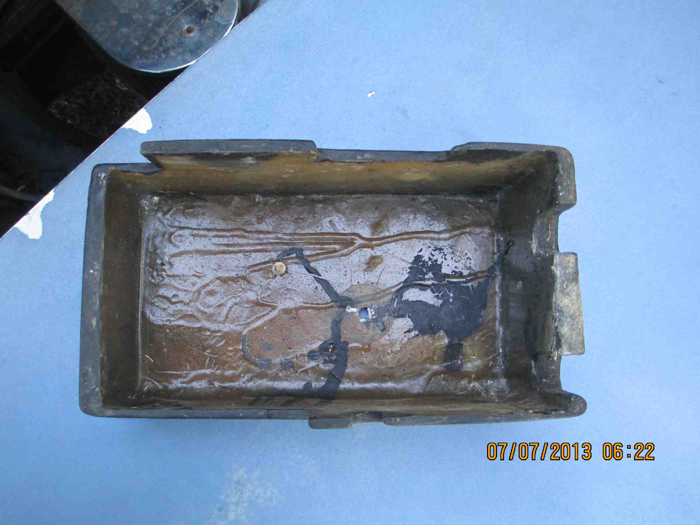

Okay more pics! I made it home with no problems & took it out for a drive. Had to fill up the tank. It does have a healthy backfire on decel. Not sure if it is the exhaust leak causing it? Actually runs out pretty good & is plenty quick. Not v8 quick of course but definitely can tell a difference over a stock 2.0 type 4. I was a little surprised to see the stock FI fuel pump in the front trunk. There is a regulator in the back by the carbs. Don't know why they didn't just put in an electric pump for carbs. No reasn to have all that pressure going back to the regulator (IMG:style_emoticons/default/confused24.gif) . It is missing all the tin but the top piece surrounding the fan (IMG:style_emoticons/default/confused24.gif) . The right rear brake is grinding pretty noticably.

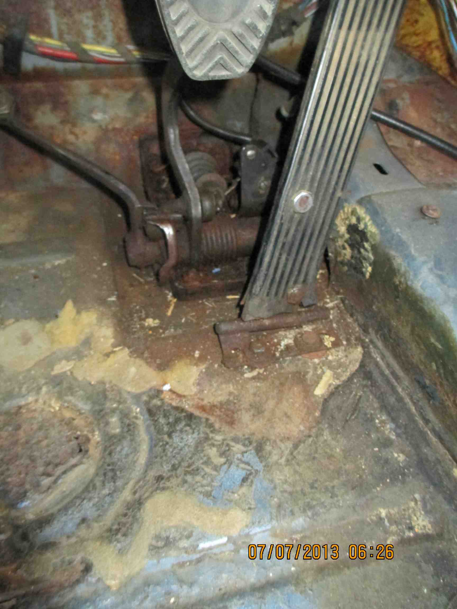

My first project will be switching out the 5-lug suspension off my black 75. The SC front end does have that huge underbody sway bar. Way overkill in my opinion but I'll leave it for now. I'll be putting on my new PMB Calipers I won at WCR this year (IMG:style_emoticons/default/aktion035.gif) . Along with new rear rotors & pads. The fronts are in good shape so no worries there. Not sure if has already been upgraded to a 19mm master cylinder. If not I'll be getting that done too. I'll also replacing the gas pedal. If you see the picture with it there is a nice gate hinge bolted into place (IMG:style_emoticons/default/blink.gif) . Another nice PO job (IMG:style_emoticons/default/icon8.gif)

boxstr   Jamie, congratulations, you have a 914 with a Corv...   Jul 7 2013, 09:19 PM
JRust   Jamie, congratulations, you have a 914 with a Cor...   Jul 7 2013, 10:04 PM
messix   Jamie, congratulations, you have a 914 with a Co...   Jul 7 2013, 10:26 PM
kg6dxn   I love the embossed label tape! Looks like it...   Jul 7 2013, 10:13 PM

rick 918-S   Evil must have been over welding on that thing... ...   Jul 7 2013, 10:26 PM
kg6dxn   Evil must have been over welding on that thing......   Jul 7 2013, 10:55 PM
Dave_Darling   Evil must have been over welding on that thing......   Jul 7 2013, 10:55 PM
boxstr   Hey, you have more than one 914. Why not more than...   Jul 7 2013, 10:42 PM
Mr.242   Evil must have been over welding on that thing.....   Jul 8 2013, 10:32 AM
Dr Evil   He missed the class on grinding down the welds. ...   Jul 8 2013, 10:59 AM
JRust   He missed the class on grinding down the welds. ...   Jul 8 2013, 12:09 PM

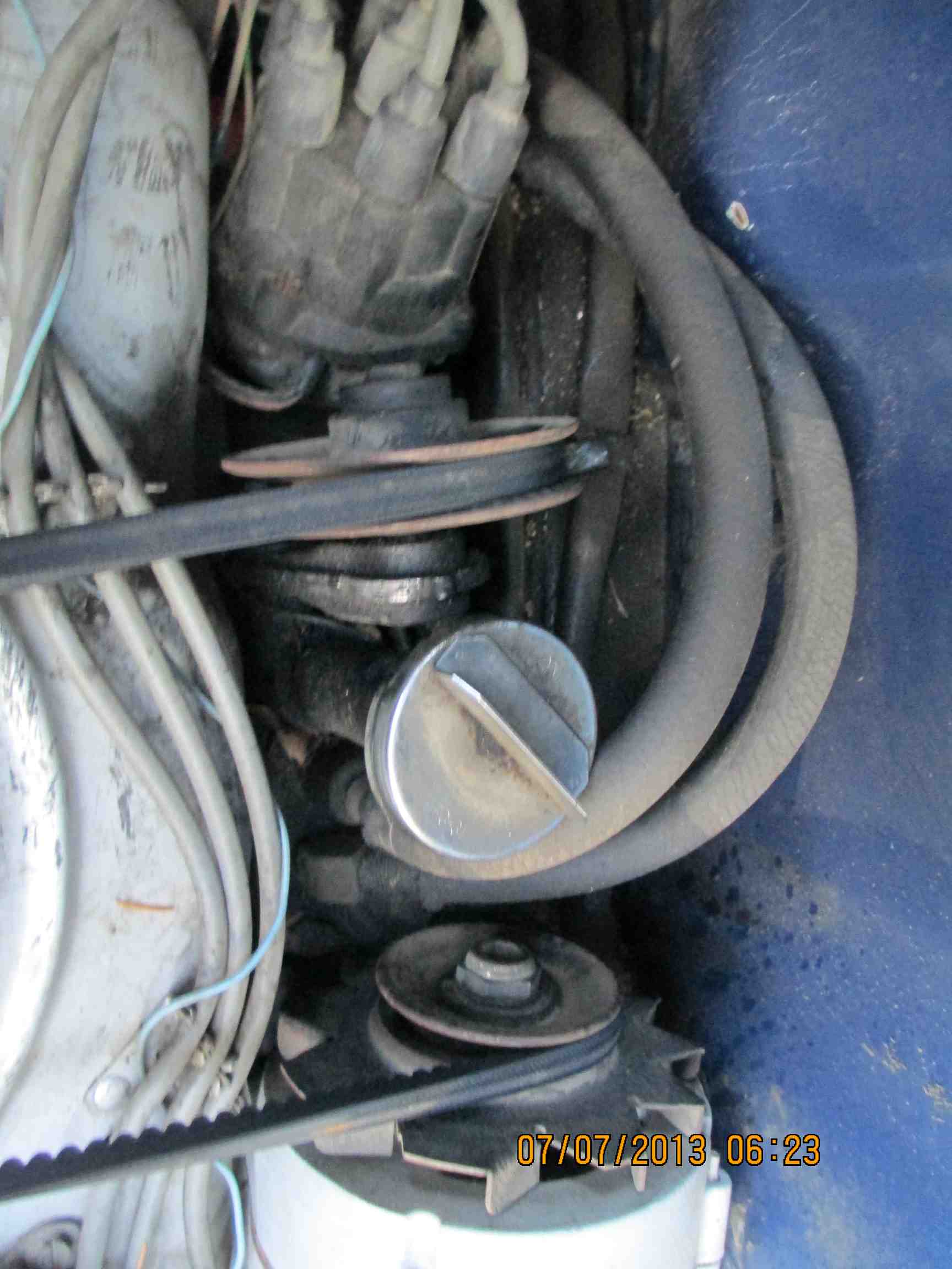

r3dplanet   It looks to have a remote oil cooler. Where did th...   Jul 9 2013, 12:31 AM
JRust   It looks to have a remote oil cooler. Where did t...   Jul 9 2013, 10:21 AM
kg6dxn   I'll get measurements. They just used the sto...   Jul 9 2013, 06:44 PM
