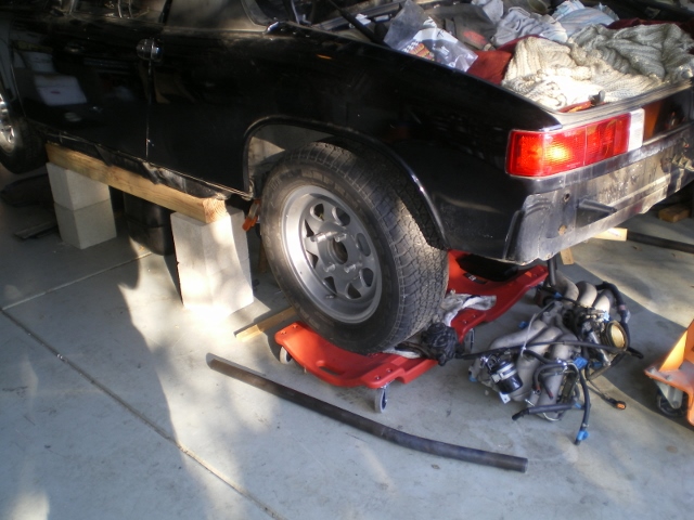

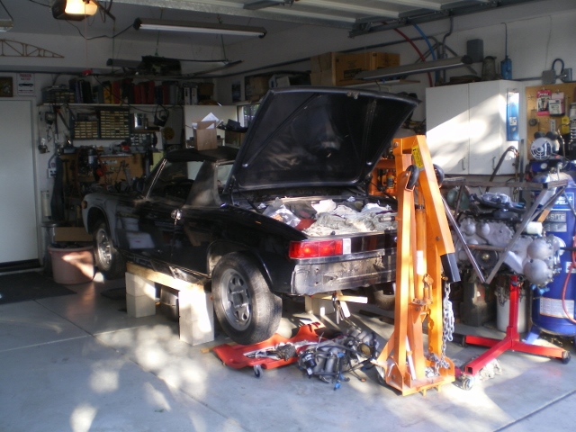

What's it been? A year since I got Blackie running. I finally get it tuned to a daily driver status and should have been happy as a Lark then but what do I do? I sold the engine (w/90 hour's on the Hobbs) on the last Dawn Patrol GMR run. So I pulled the engine and began preparing Blackie for her transformation.
Before I go any further check out my Jack Stands. Min height 19.5", 12 ton and should hold up to a 6.7 quake or direct nuclear attack.
And out she comes.

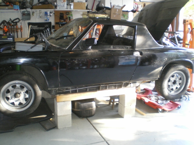

One thing you have to love about these cars is that you can remove an interior in 15 minutes. 30 min's if you have a console. This was one shot before the interior is gutted.
and an hour later I'm scraping tar floorboards.

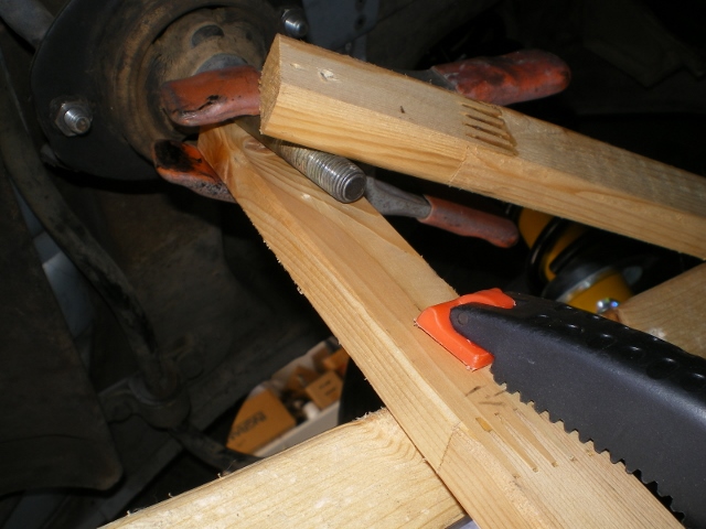

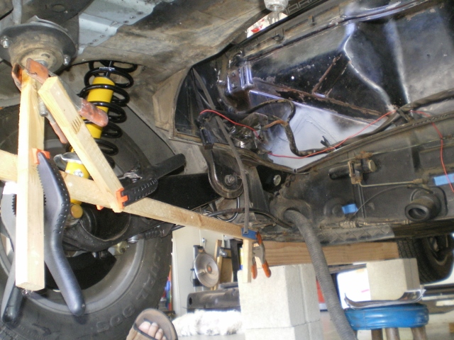

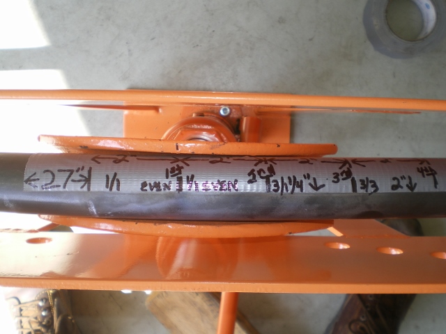

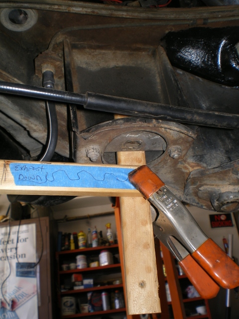

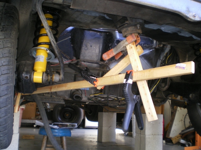

The 4130 tube arrived so it was time to get Blackie up and start with the mount. Besides I need the room to weld in the new trunk hinge when it arrives. I bought a 4x4 and ran a dado cut down it to accept the flange on the bottom of the longs. Flame on.
No, I am not making the cradle from wood. (IMG:style_emoticons/default/chair.gif) Just trying to visualize.

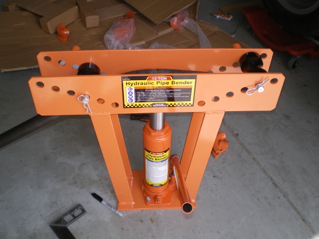

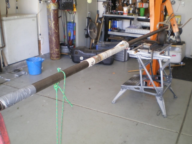

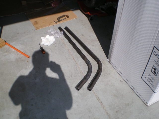

I had planned to heat bend the tube but proved to be a PIA. Too tricky to keep below 1500F and I don't have any means to heat treat so it was off to HF. With my coupon I walked out with this for $79. Out of the dark ages now.
The first pieces. Next is to locate some bushing stock or some 5/16 weld tabs (if they make such a thing).
