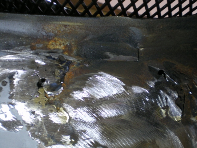

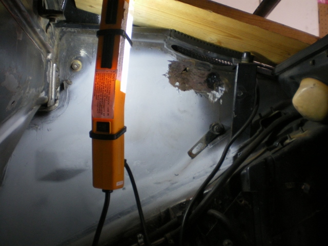

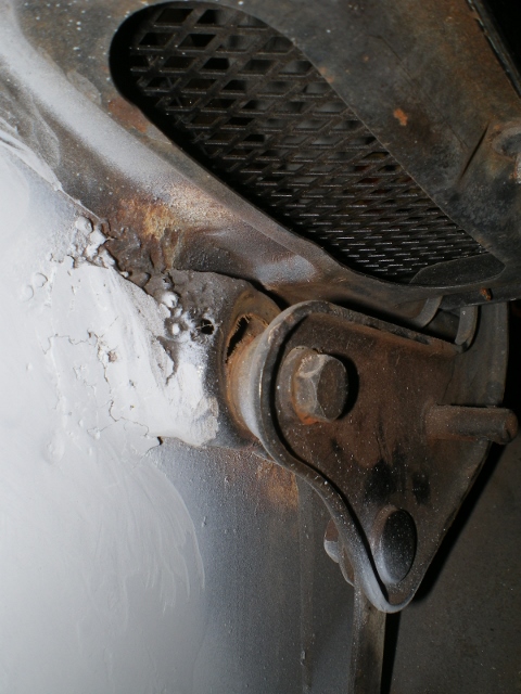

I received the trunk hinge from Restoration Design (IMG:style_emoticons/default/first.gif) so I took a break from the engine cradle to attack this.
I had noticed the mud dauber welds earlier and then found that the hinge had rusted thru also. After grinding down the old welds and removing the old hinge it looked like this

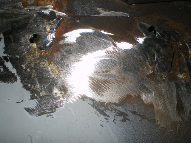

But a close up reveals a crappy previous repair as well as brazing...........
I'll need to get this area cleaned up and I'll beef up this area before welding in the replacement piece.
