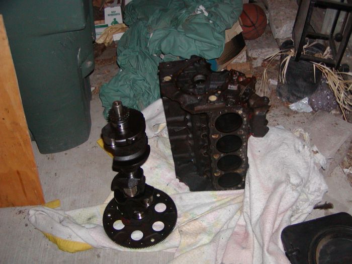

Anyways with that, I then went to pick and pull and found a 305 engine from some later car. We look all around and cant find an engine number.. Hey, its a v8, we need to pull something, Lets just do it (im very glad I said that..)
We then get the engine home and I plop off the valve covers and find that it has 350 heads(via the number), hmm.. Interesting... So I go and find the block number look it up. Sure enough, its a 350 block. Well thats not enough for me, I take it apart check the bore, theck the stroke, Yuppers 4in bore, something or other stroke, Yup its definately a 350! Whats not known is why it was in a 305 car.. So checking the pistons dad says there high compression, I wouldnt know any better.
So then talking about radiators, Mike Mueller kindly offers me his (very large) aluminum radiator for cheep. I take him up on his offer and drive to his house to see his garage packed with neet toys! Thanks mike for the walk through! We enjoyed it!
So we go home, and later in the week(yesterday) I start taking off the pistons, I get one off and clean it, trying to find an overbore number.. Cant fine one Check the bearings, they have .0005 on them. No clue what that means...
Anyways, while taking out the rest of the pistons dad stares at something for a second, laughs, and shows me that it is a 4 bolt main. So, now where very curious to why it was in a regular family car.. 84 or such.

Got the engine completely appart, took out the lifters (that was a serious job... they where in dere good)
Anyways, enough with the talk, heres the action.

Andyrew   Progress pics from yesterday. Got the engine compl...   Jul 12 2004, 08:51 PM
Andyrew   crank   Jul 12 2004, 08:51 PM
