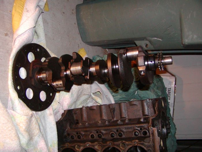

crank

Andyrew   crank wear.. gona have to overbore or whatever the...   Jul 8 2004, 07:25 PM

Andyrew   crank   Jul 12 2004, 08:51 PM
