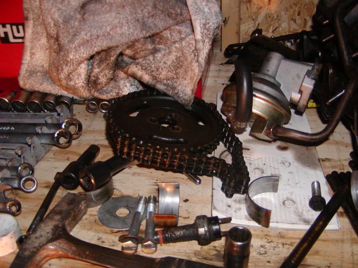

Out of curiosity, is this timing chain stock?

Andyrew   Out of curiosity, is this timing chain stock?   Jul 12 2004, 08:52 PM

boxstr   No the rip is on the front of the engine and the o...   Jul 12 2004, 10:12 PM
