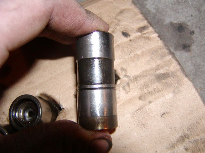

Lifter w/o cleaning, Look at the wear, Can I still use these?

skline   Ok, First off, the pistons are standard GM pistons...   Jul 8 2004, 08:23 PM
