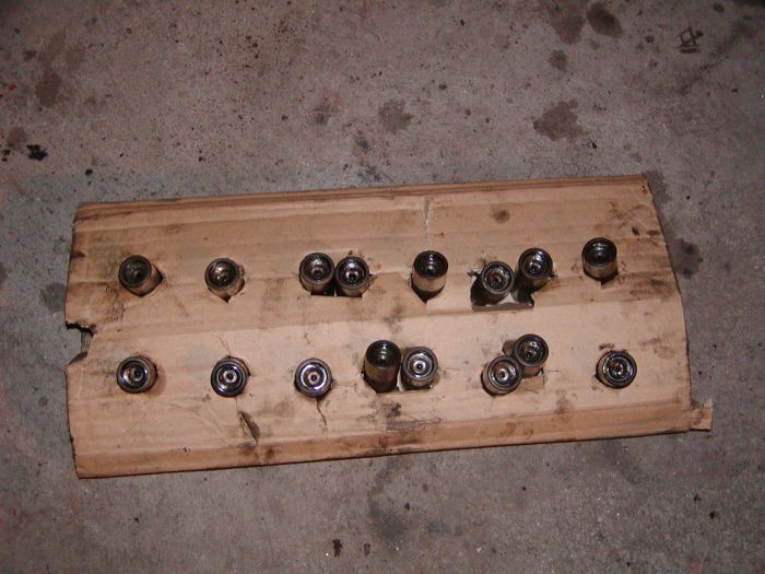

Andyrew   Bearing wear, lifter dirt   Jul 8 2004, 07:22 PM

Andyrew   Lifter w/o cleaning, Look at the wear, Can I still...   Jul 12 2004, 08:53 PM
