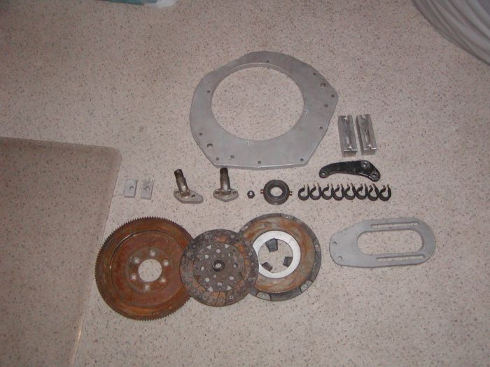

Ok, here a pic of the parts I got from scott. I will get another (amost complete) batch of parts from Steve.
Scott, let me know if there is any major parts missing here, a couple of clamps I dont care about.
Also Scott, did you find out any details about that engine?
