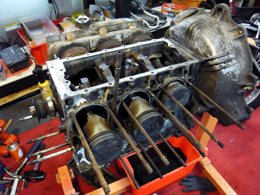

More disassembly.

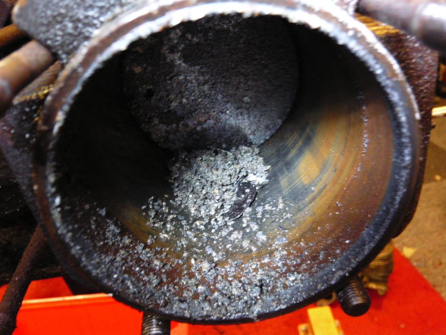

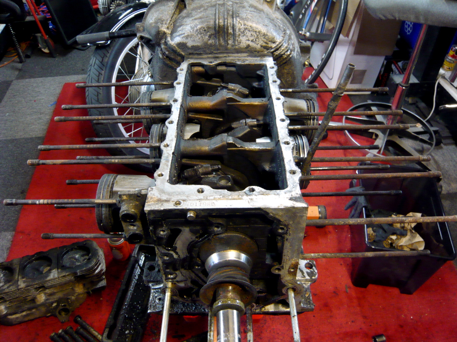

Because the motor is a touch on the frozen side I couldn't remove the cylinders, rods, and pistons as a unit. Therefore the cylinders are coaxed off one at a time. Cylinders 1-3-5 are free.

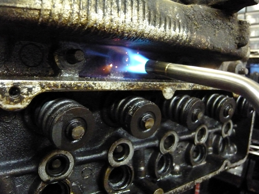

Now on the starboard side of the engine. I found that every one one of the top head stud nuts was frozen. It took two days of part-time work to torch each one repeatedly with MAP gas intermixed with drilling a 3/64" hole on either side of the nut and then splitting it with a sharp chisel. One can easily see that there's no nut where I'm torching. There was, but this is just for photographic clarity.

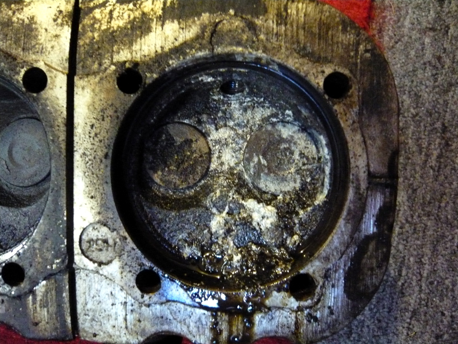

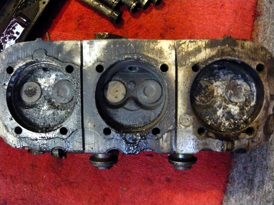

The starboard heads look even worse than the port heads. I have no clue what the hell happened on the outer two chambers to make them look so lousy.
Even more debris on the #2 cylinder.

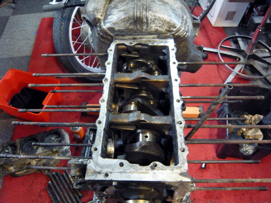

Finally free of the cylinders, the engine now spins quite nicely.

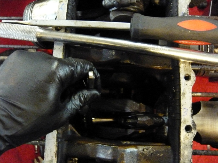

Now I can finally work out the connecting rod nuts. This actually took quite some time to remove. The bottom ones are hard to reach.
All clear.

Dr Evil   Your heads show that water and oil were allowed to...   Jul 13 2013, 12:23 AM
r3dplanet   Yeah, it was pretty damp in the slaughterhouse. ...   Jul 13 2013, 01:16 AM
