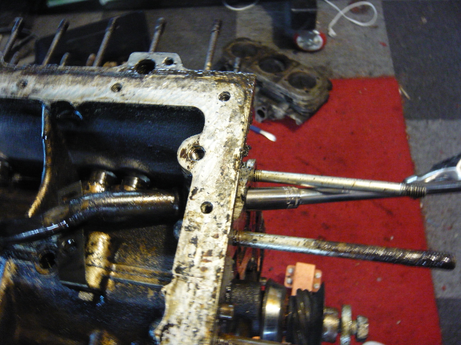

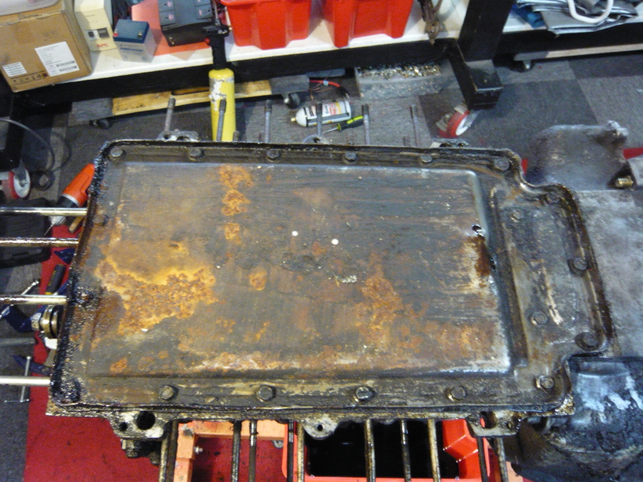

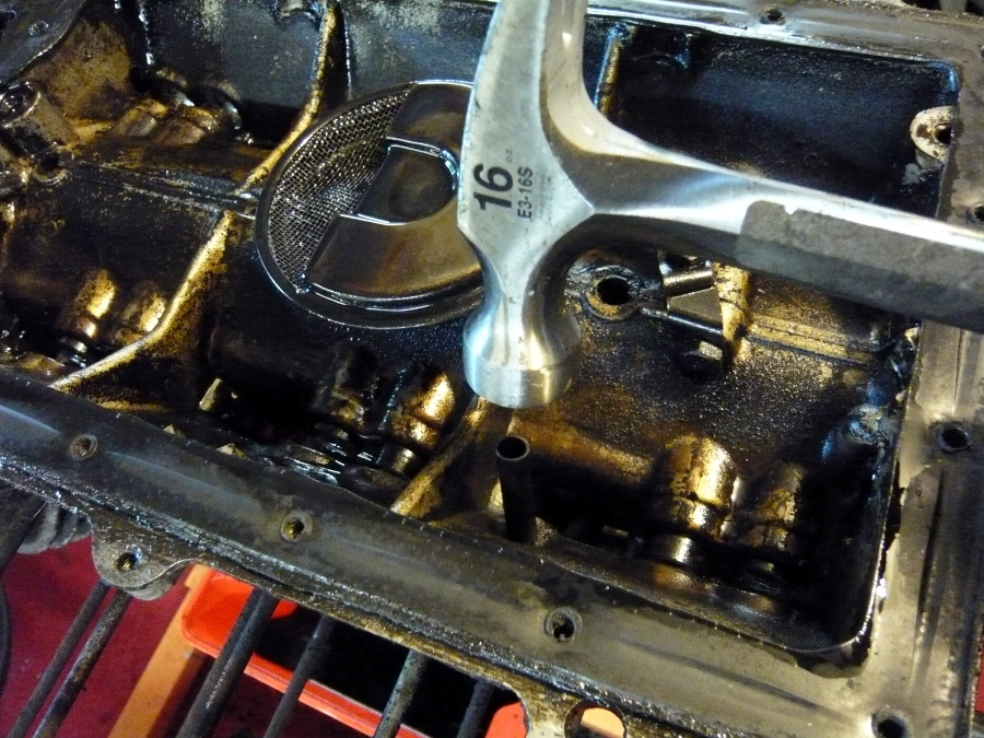

Flipping the engine shows 19 bolts to remove the oil pan. I'll discard this item also in favor a much better aftermarket aluminum unit with cooling fins.
And the oil pickup is revealed.
By CAREFULLY tapping the bottom of the dipstick tube with a 16oz hammer the case is free of one more accessory.
The oil pickup tube was really stuck. But I found that I could use a long extension and a 10mm socket to carefully drive it through the case from the outside. GM made a special tool for this job but it's completely unavailable.

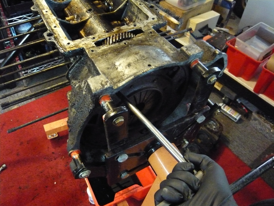

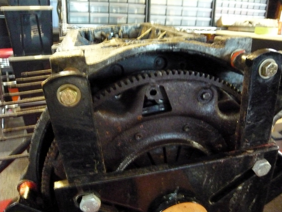

This part I've been dreading. The clutch, pressure plate, and flywheel assembly were just on the wrong side of the engine stand, and all of the bolts were super rusty. After a two day soak with Kroil, I was able to slowly draw them out.
The clutch plate and clutch disc are free. I unbolted the bottom bolts on the engine stand and was able to drop them right out.

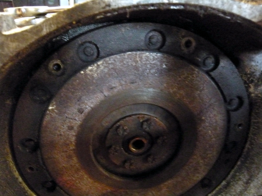

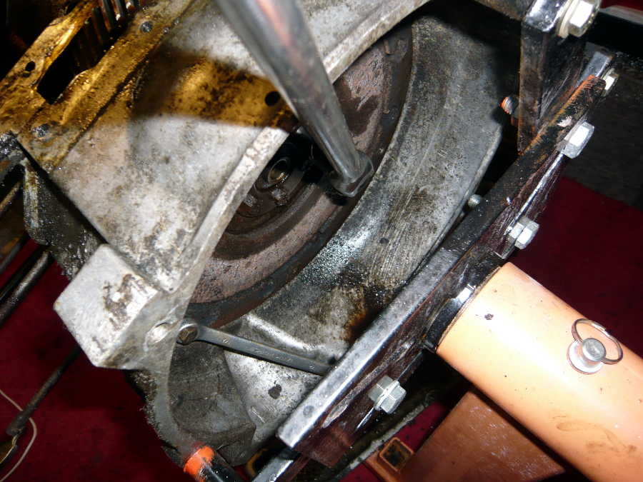

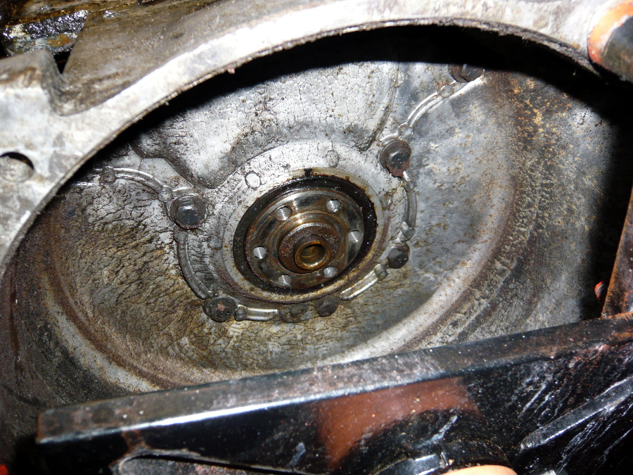

And finally the flywheel is revealed. The six flywheel-to-crank bolts looked as rusty as my high school German language skills.
I couldn't keep the rotating assembly from spinning when I tried to loosen the bolts. So I threaded one bolt into the flywheel thread and another to the case and wedged a 1/2" combination wrench in between them. With even, heavy pressure on my long socket wrench the bolts slurped right out.
Finally just the bell housing bolts remain, but I need to prop up the crank case first. That's a job for this coming weekend. The bell housing, clutch assembly, and flywheel will also be discarded since it won't be used in the 914.
