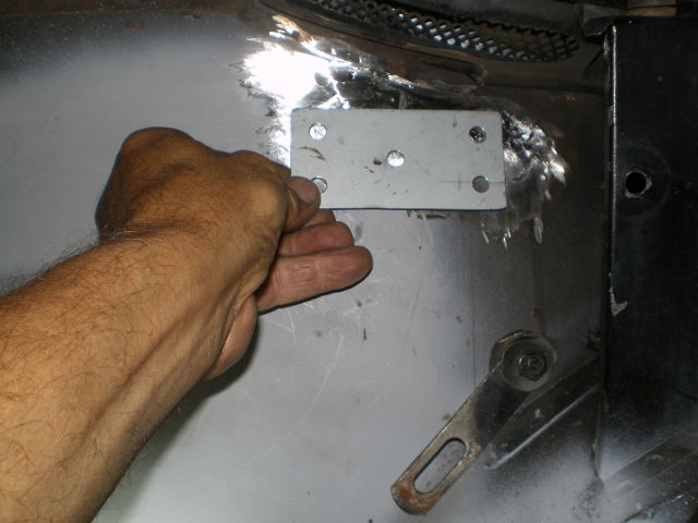

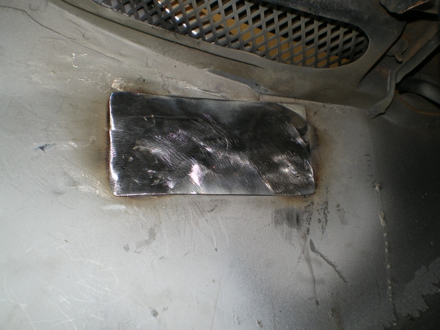

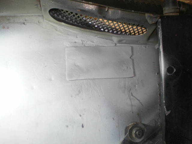

I ground out all the brazing from a previous repair then filled holes and ground them down. This is the last of the welded holes.
Ready for weld thru primer.
Reinforcement piece 18ga.

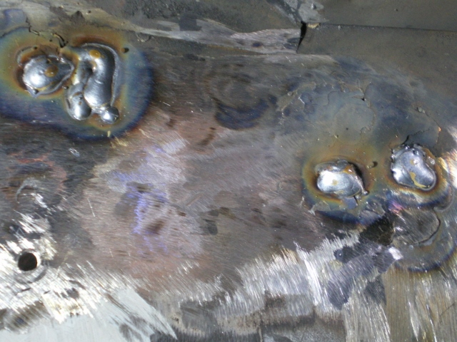

Reinforcement piece welded in
Primed with weld thru. Ready for the hinge piece to be welded to it now.

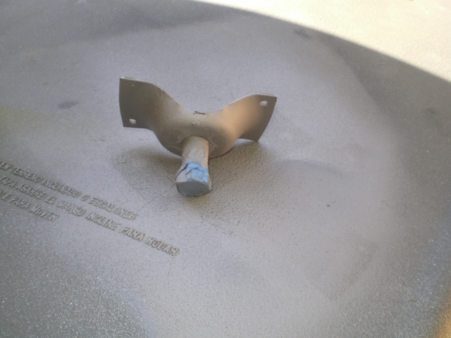

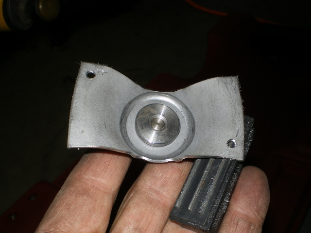

Here's the new one. Thanks Restoration Design.
Primed and ready to have the nut from the back side welded in
Welded in place. It's ugly but substantial. It's a bitch to get that tip in there. (IMG:style_emoticons/default/huh.gif)
And everything welded/primed and ready for the lid to be mounted, shocks slipped on make any adjustments necessary. The motion of the trunk lid is now smooth as a baby's (IMG:style_emoticons/default/bootyshake.gif) .

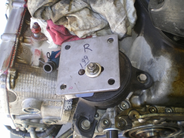

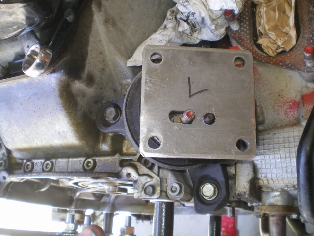

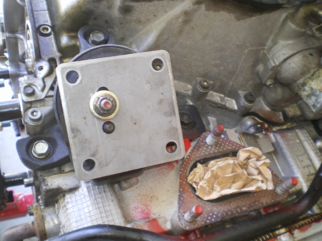

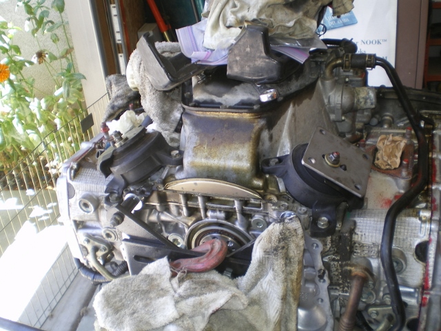

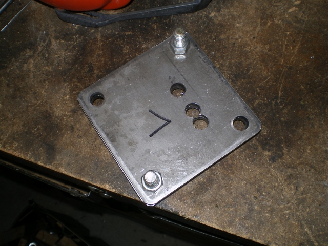

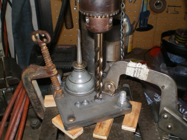

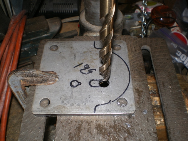

I took some 1/4"x 4" sq plates and used the Subaru piece as a guide. After I made the slots in each piece I realized that it wasn't necessary. A solitary hole would have been fine but now I have a little more wiggle room.
A quick test fit
One is the mirror image of the other so using 2 of the 4 bolt holes the plates are bolted together and the 1st piece is the template for the other.
The plates in place

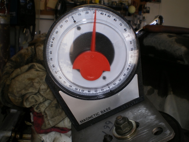

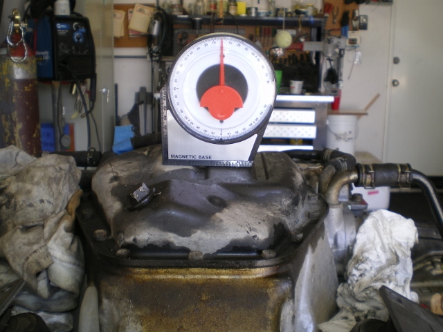

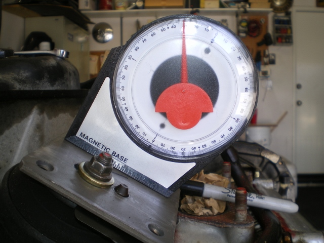

I need the engine level to get these next measurements.
Right & left motor mounts are at 32 degrees.

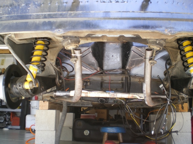

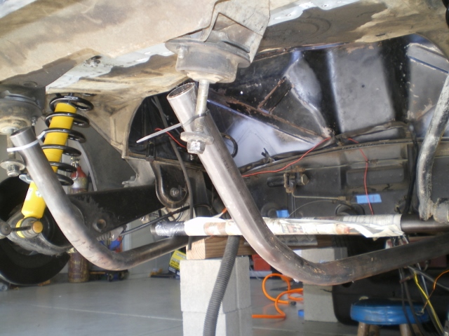

Well I'm at the stopping point again (IMG:style_emoticons/default/headbang.gif) . I need the exhaust flanges before I can go any further with the cradle so I stuck some pieces up just for shits n grins. (IMG:style_emoticons/default/hissyfit.gif)
