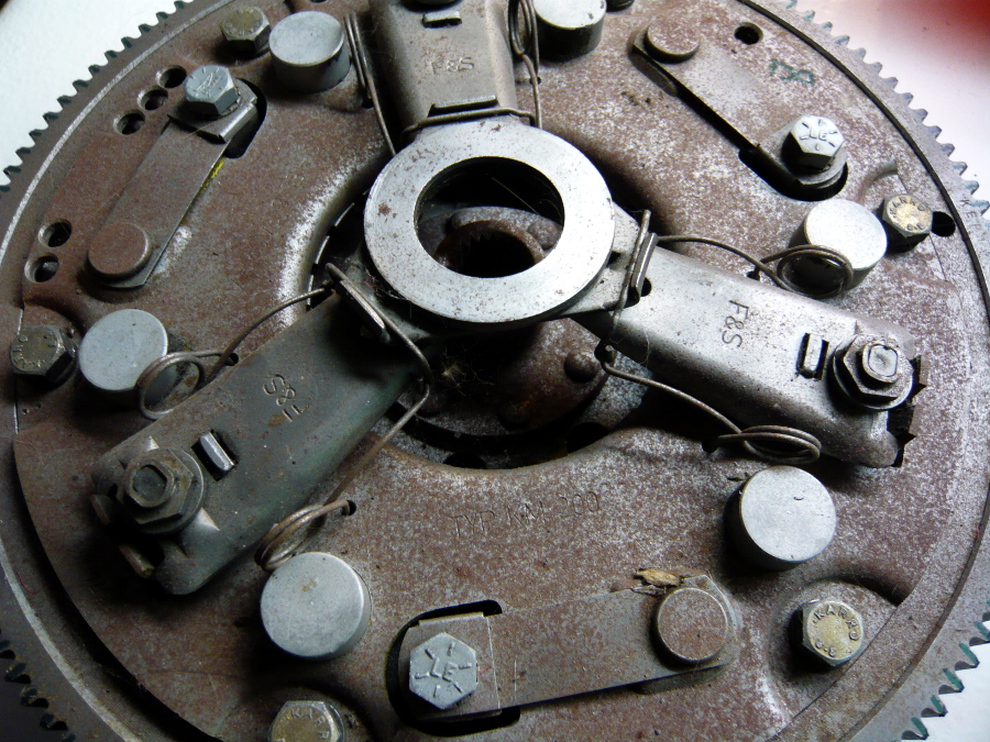

Okay, I have to admit that I'm a little confused but I'm sure that this challenge will be met and solved. To solve the curiosity for rick_cv, myself, and perhaps others I disassembled my crusty part.
The flywheel assembly is a sandwich made of the clutch disc, flywheel, and pressure plate. The pressure plate is bolted right to the conversion flywheel with the clutch disc kept inside. Here's a closer pic. I know these parts are rusty, but they'll be cleaned and balanced before being put into service.

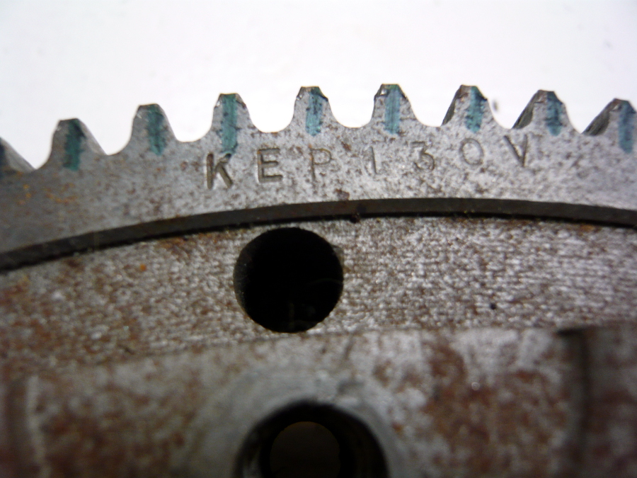

Apparently, this flywheel assembly is from Kennedy.

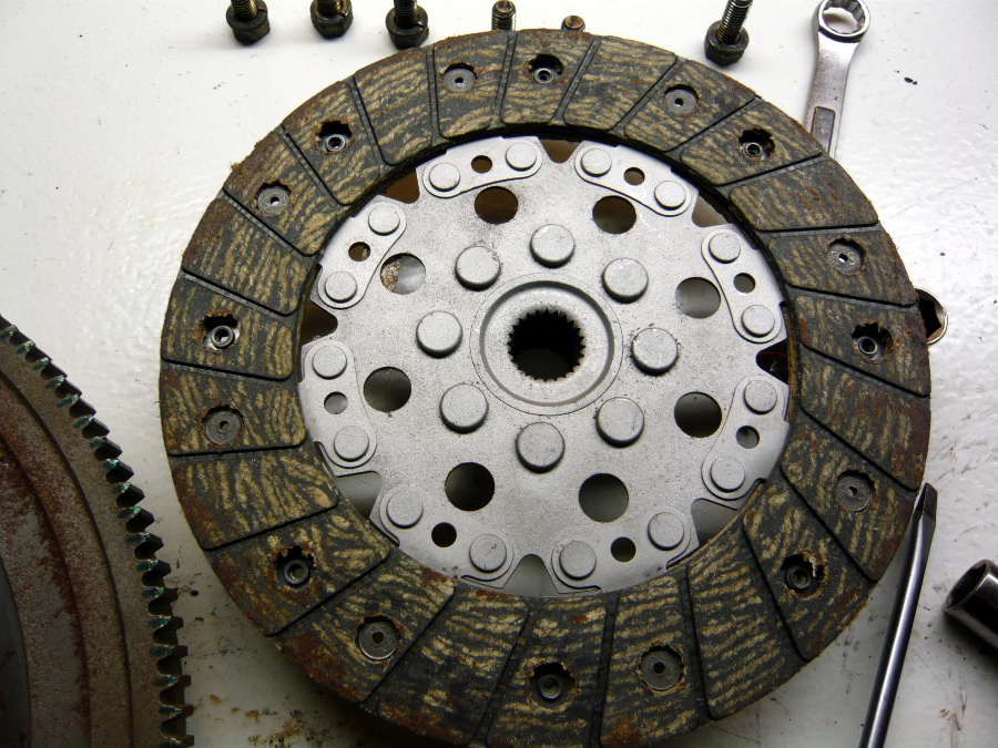

The clutch disc is also F&S (which is just Sachs now, isn't it?) and measured 180mm, quite a bit smaller than the 215mm 914 clutch. Hopefully that won't be a hideous issue. But the 180mm size tells me that this is a standard VW part - not a 914 part. Clark's sells three clutch discs. A standard VW clutch, and high performance clutch, and a racing / high hp clutch. I'll probably replace this clutch disc for one of the racing ones.

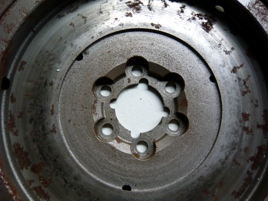

Finally, here's a pic the recesses for the flywheel bolts.

rick_cv   I see 127 tooth, 130 tooth and 215mm flywheels. I...   Jul 15 2013, 02:55 PM
r3dplanet   You certainly want the 130 tooth flywheel. I genui...   Jul 15 2013, 05:17 PM

Dr Evil   That is a bus pressure plate. Possible a bus flywh...   Jul 16 2013, 07:25 AM
Dr Evil   Here is Clarks catalog for the conversion flywheel...   Jul 16 2013, 07:27 AM
rick_cv   That is what I thought when I first saw your image...   Jul 16 2013, 01:45 PM
r3dplanet   From what I've read the adapter plates should ...   Jul 16 2013, 10:57 PM
