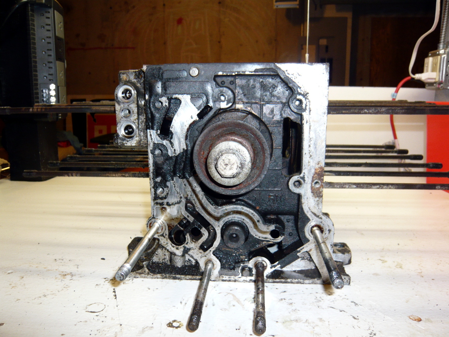

Here's a front view for no reason.

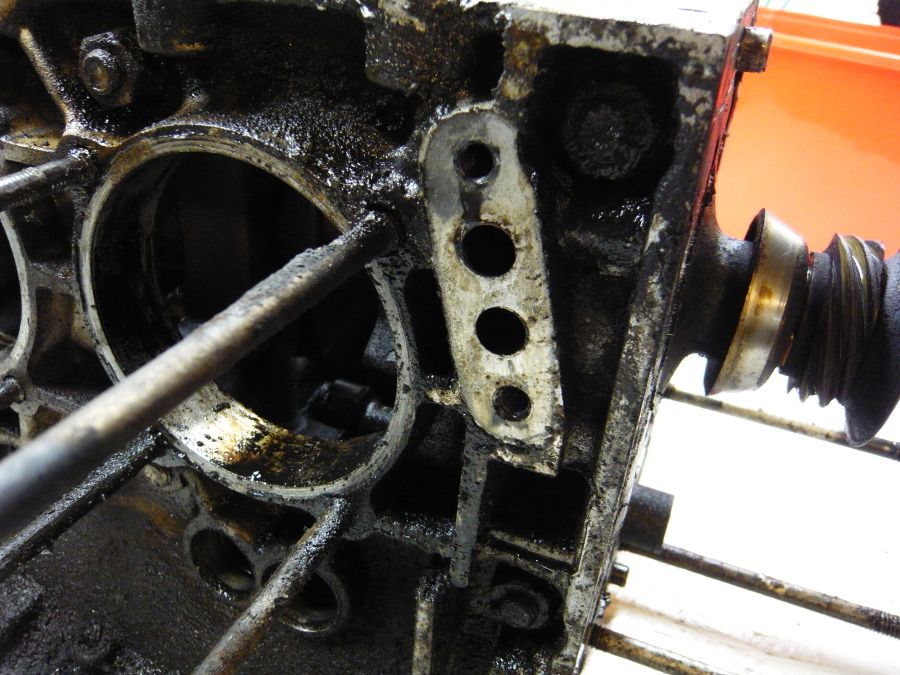

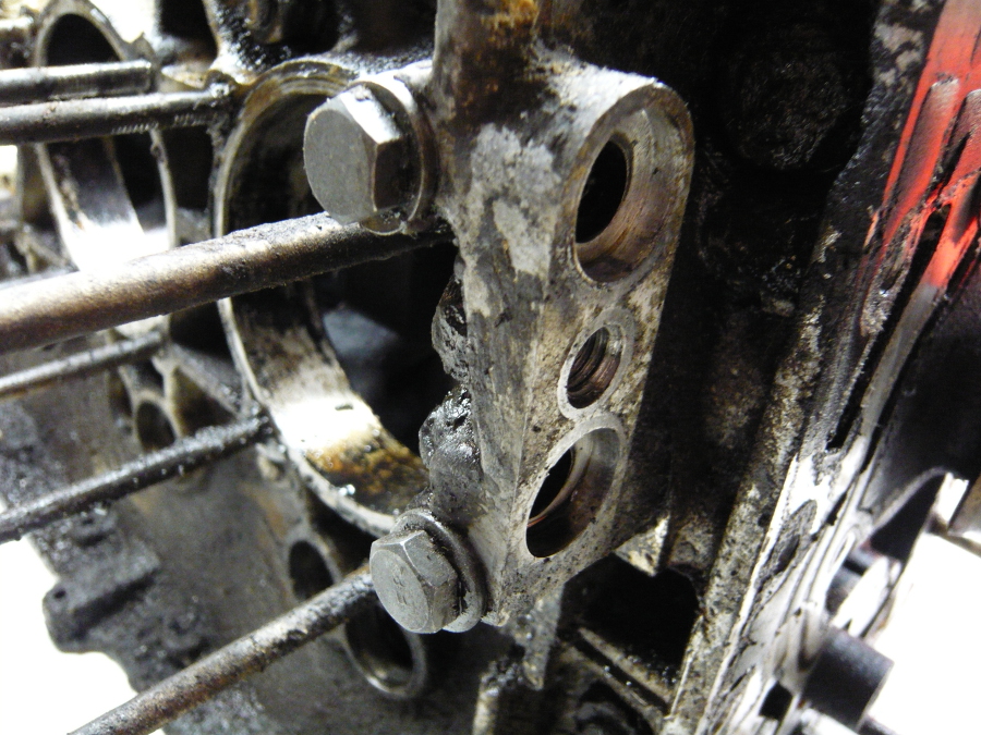

This part is the oil cooler adapter. I could have taken it off at any point during the disassembly, but both the 1965 Corvair Chassis Shop Manual and Bob Helt's The Classic Corvair say to leave this connected until this point. By the way, these manuals are fabulous. For dolts like myself they're really a fantastic resource. If you do a Corvair conversion yourself, be absolutely sure to get them. They're both in print.
And .. removed.

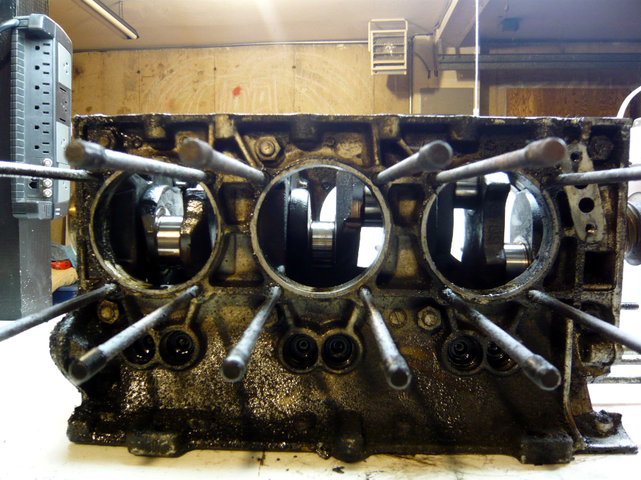

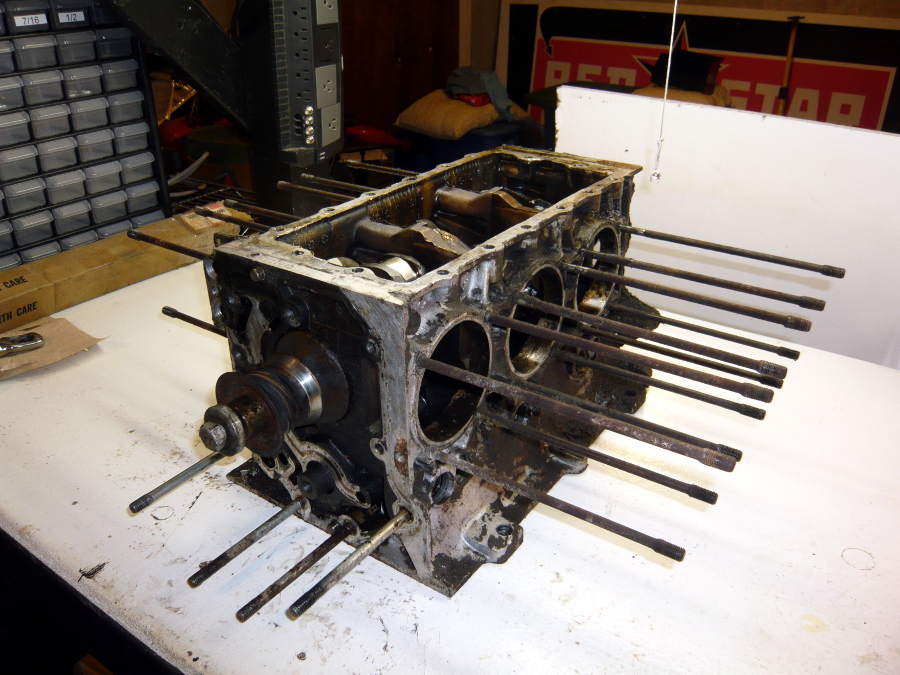

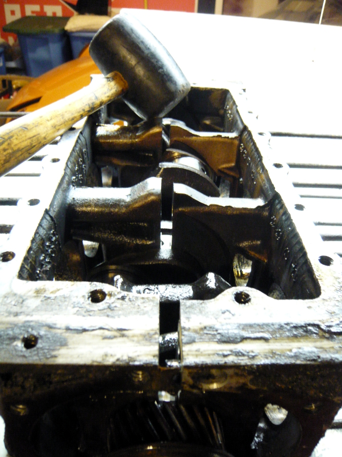

Now it's time to split the case. Here's a side view clearly showing the eight through-studs and corresponding nuts that hold the hemispheres together. Four on top, four sort of in the middle. Just before removing them I made sure to remove the bottom bolt that holds the oil pickup to the case.

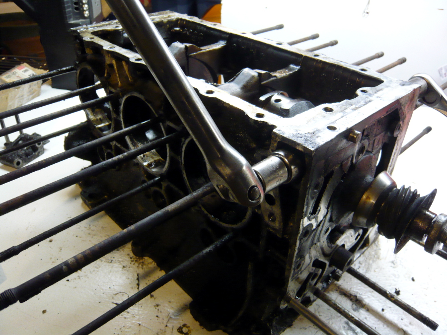

Having the motor on the bench sure makes this part straightforward. Using a ratchet and a long socket wrench, each comes off in turn with a little effort. No crazy stuck nuts like the ones holding the head.

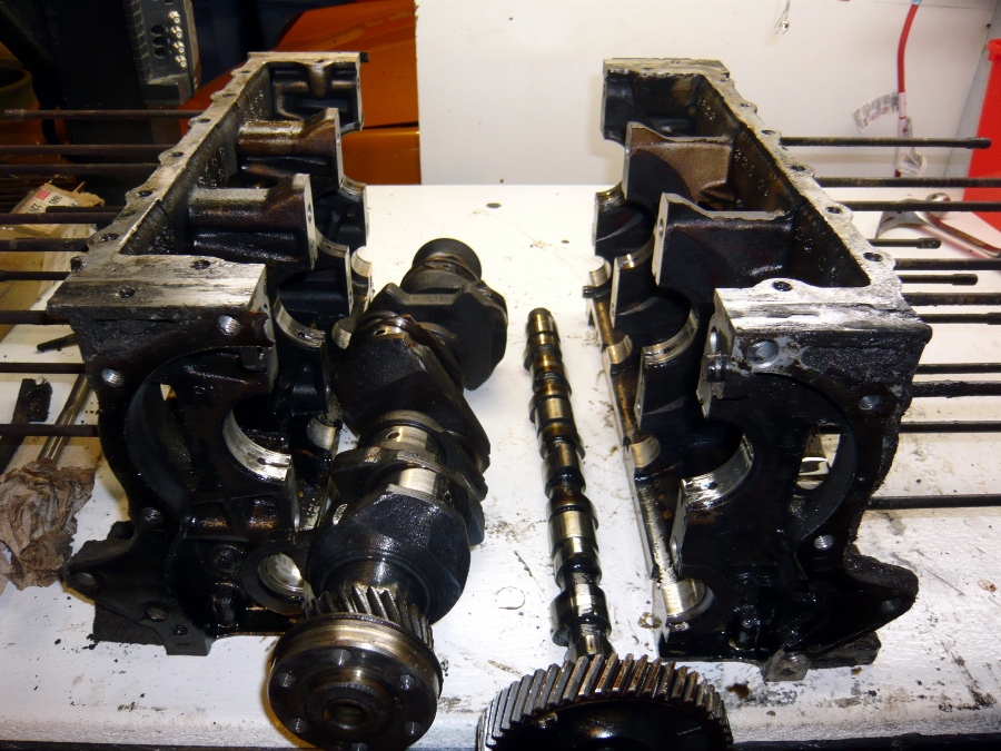

Now the big moment. A slight tap with a rubber mallet along the top edge of the inside of the case and it just pops apart. It took very little effort.
In fact, it popped apart a little too readily. The manual says to prop the bottom of one half of the case with a 2x4 to push one side of the engine higher than the other. That way you lift the free half and leave the crank and cam in place on the other side. This is to prevent the crank and cam from just spilling out onto the floor. Just as I reached for the wood, it split right open. Whoops.

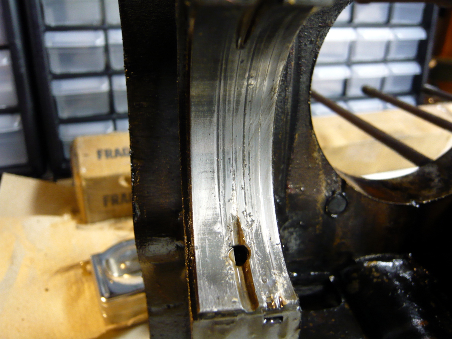

Yeach. This crank bearing is scored all to hell. The opposite side is also. The rest of them look like they have normal wear.
