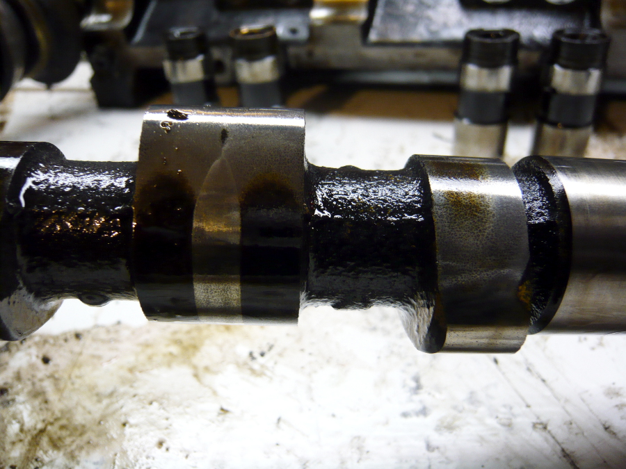

Moving along with a close-up of cam wear. This doesn't matter as the cam and cam gear will be replaced.

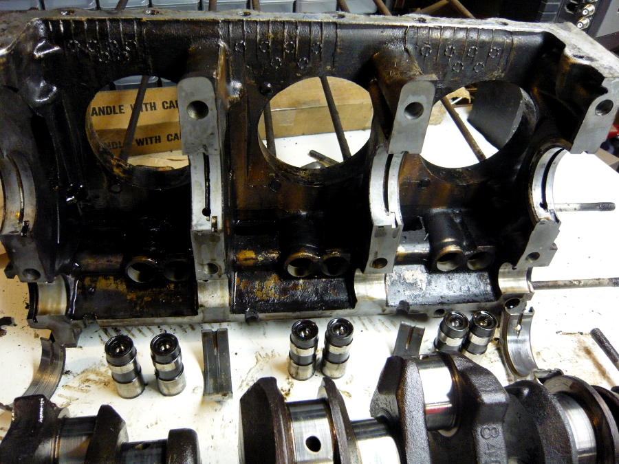

A glamor shot of the starboard half of the engine with the hydraulic lifters and crank bearings removed, which I'll catalog and keep for reference. Note that the Corvair engine does not use cam bearings. Instead, the cam rides only on the oil between the cam and the engine case. I might have the cam surfaces coated with Teflon before re-assembly, assuming this case checks out. Before getting that far I'll get the case hot tanked and checked for cracks with Zyglo (thanks, Relentless!). That's coming up next.

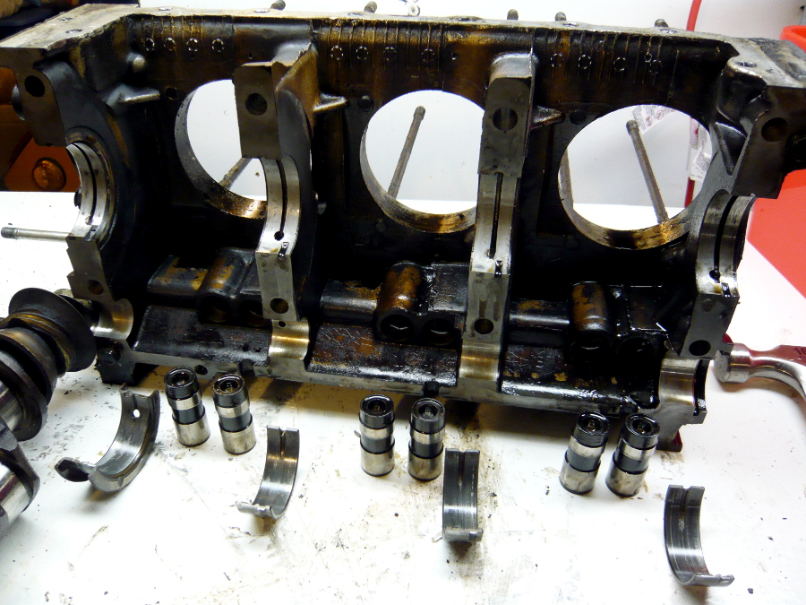

The corresponding glamor shot of the port side of the engine. This is the end of disassembly. Next up: finding a suitcase full of money to get the rebuild parts and checking and prepping the parts I already have.
