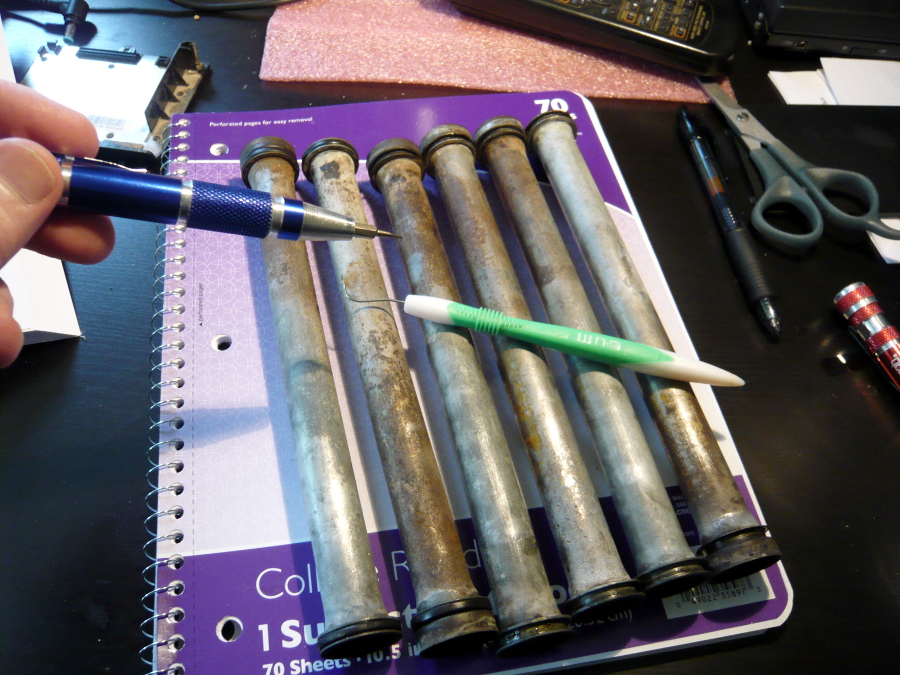

Today I cleaned the crap out of the pushrod tubes, but I still plan to soda blast them and powder coat them.

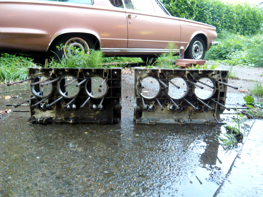

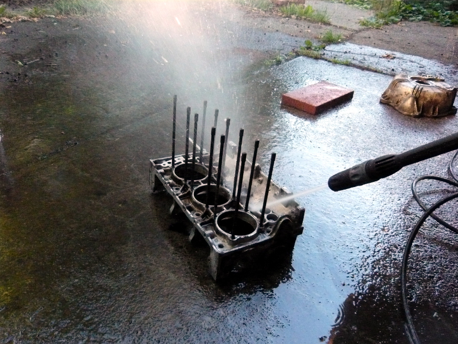

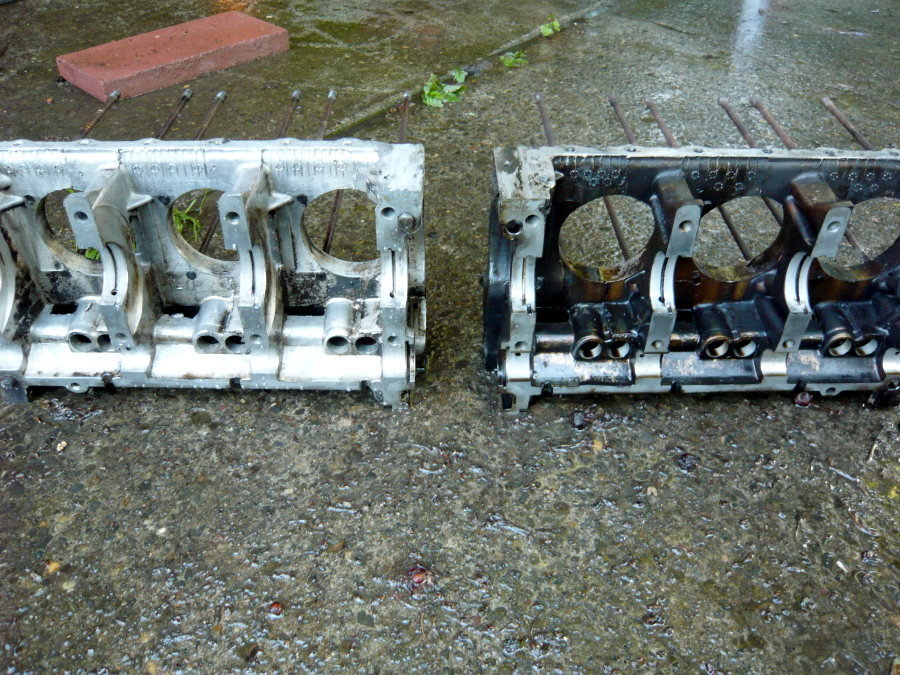

It was super nice out this evening so I pulled out the Easy-Off and the power sprayer and hosed down the engine cases. They're going to the machine shop tomorrow. Here's the before and after shots. Remember, this is just a once-over to make it easier for the machine shop.
