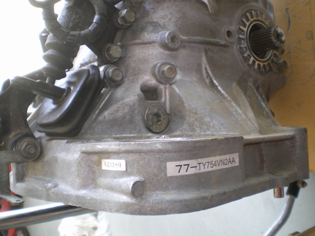

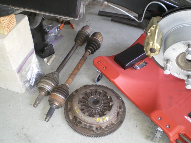

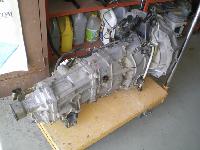

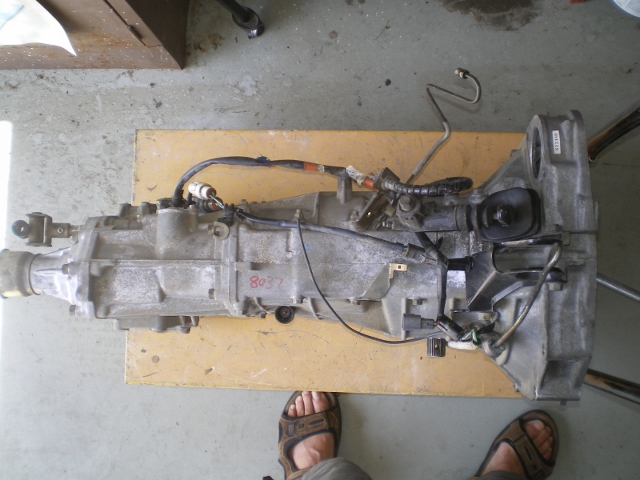

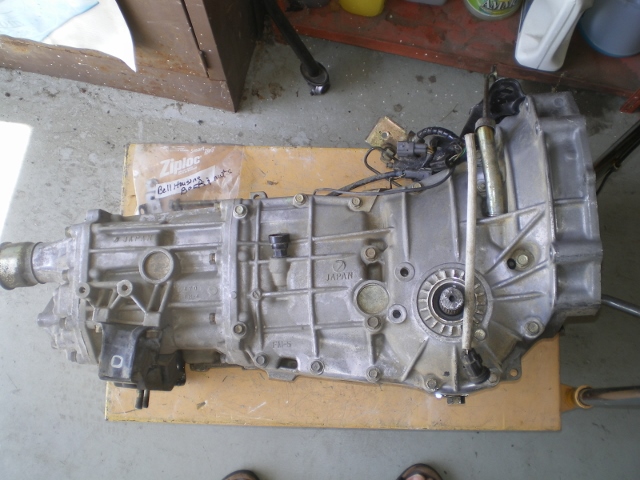

Yippie (IMG:style_emoticons/default/piratenanner.gif) Picked up a tranny from an 03 WRX 2.0T, 74K miles., pressure plate, throw out bearing, some 1/2 shafts he threw in (away). (IMG:style_emoticons/default/biggrin.gif) This will help answer my cradle questions. Bottom line is that the center line off the 1/2 shafts is roughly at the bottom of the heads. Porcharu is sending me some majic flanges in a few weeks, too. (IMG:style_emoticons/default/biggrin.gif) Only one pair left!!!
