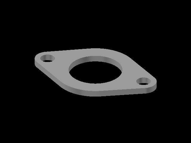

I've been wanting to start familiarizing myself with AutoCAD and this seemed like a good project for this since the intake adapters I'll need are relatively simple.
I started with an intake gasket and scanned it. Then cheated and drew the outline in Illustrator since I can bang that out in about 2 minutes. Then imported that into AutoCAD and did the extrusion. It's pretty boring at this point. Gotta measure my actual intake port size, the OD of the throttle bodies, and decide on the height of the adapters I need/want. Then I'll start working on the actual tapered tube portion.
