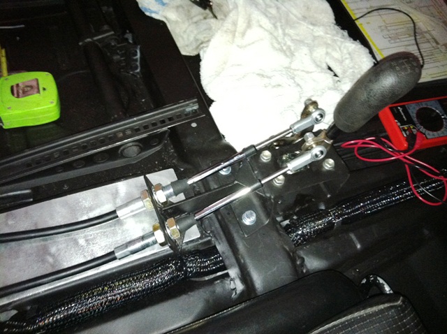

I want to order some push/pull cables for my shifter set up but I must have my hat screwed on bass ackwards. I want cables that have these threaded bulkhead ends (circled below) on both ends. I think. (IMG:style_emoticons/default/blink.gif) I don't want one end unsecured. TIA

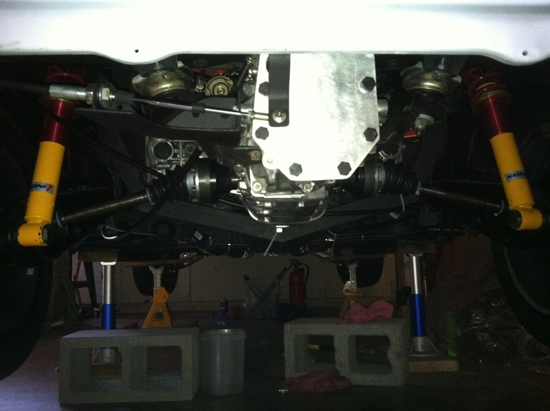

here is a pic of what bob used
http://www.914world.com/bbs2/index.php?showtopic=110974 (IMG:http://www.914world.com/bbs2/uploads/post-194-1284050225.jpg) and here is what zaney used http://www.914world.com/bbs2/index.php?sho...4994&st=100 (IMG:http://www.914world.com/bbs2/uploads/post-1738-1314415888.jpg) (IMG:http://www.914world.com/bbs2/uploads/post-1738-1314422334.jpg) and what dbcooper used http://www.914world.com/bbs2/index.php?showtopic=102887 (IMG:http://www.914world.com/bbs2/uploads_offsite/i379.photobucket.com-2618-1268145997.6.jpg) (IMG:http://www.914world.com/bbs2/uploads_offsite/i379.photobucket.com-2618-1268145998.7.jpg) |
