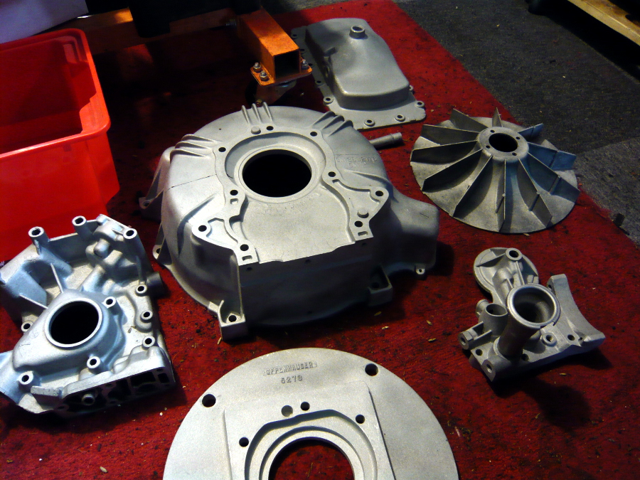

Some minor progress happening today. The machinist cleaned and bead-blasted all of the aluminum and magnesium parts and they look super.

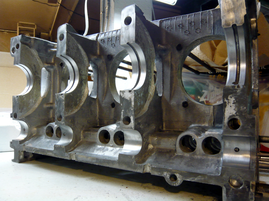

He ran the case halves through the parts washer but we opted not to bead blast the case hemispheres until we know for certain that the case tests out okay. He inspected for cracks and deformations and none were found. So I cleaned and very lightly polished the cam and crank journals to get some clean readings. I'm also having the old cylinders cleaned up so I can run a head stud torque test and then sell them off.

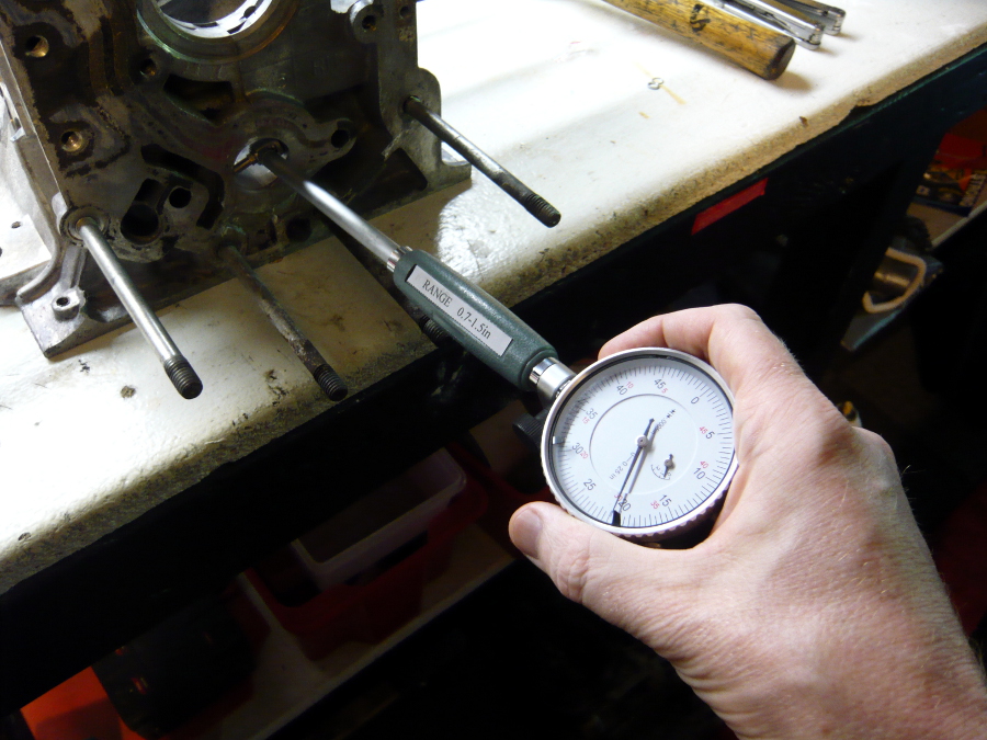

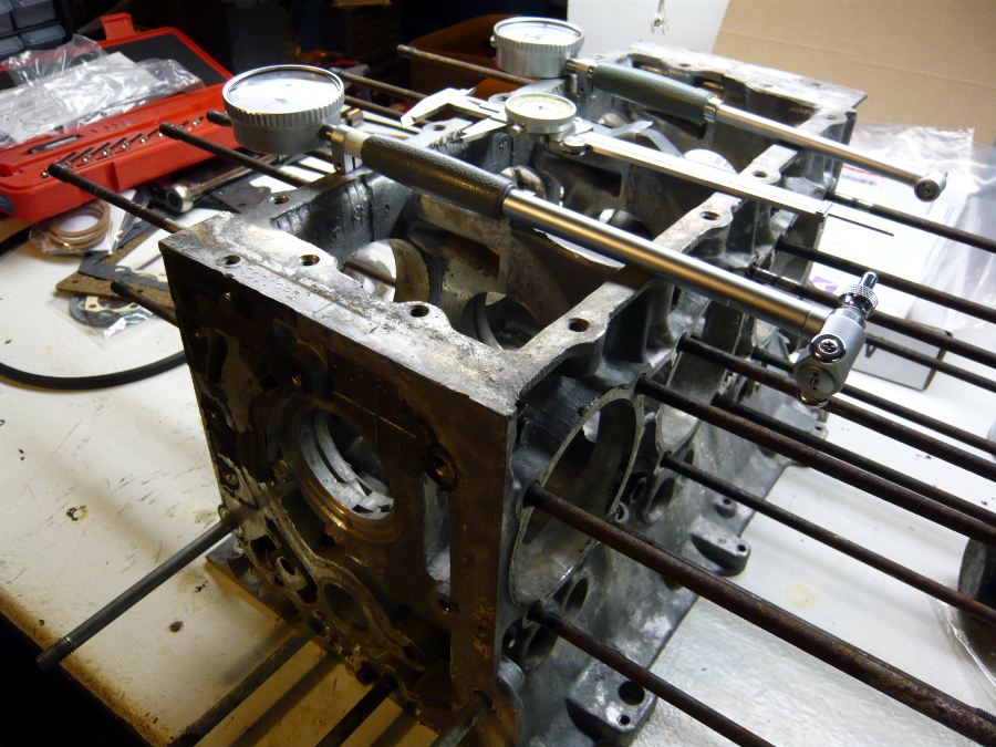

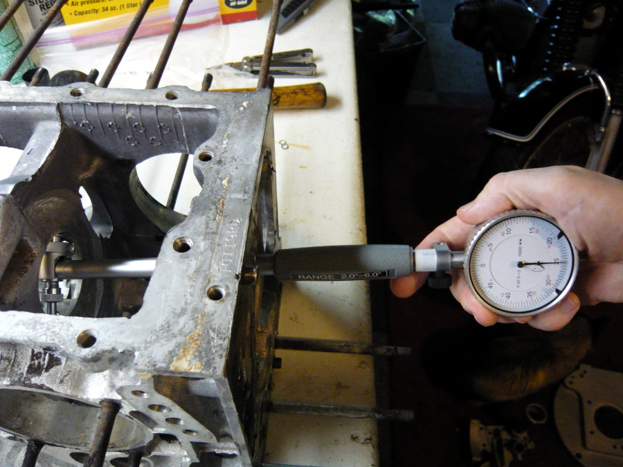

The engine build process requires bolting up and then disassembling the case hemispheres many times, and this is the first. Using the old case studs I torqued them ogether and made sure all was even:
Then I used a pair of dial bore gauges to see how much variance there was in terms of side-to-side distance and out-of-roundness. Since the cam rolls directly in the journals without the aid of bearings, I thought for sure these would be way off. It turns out that there was less than half a thousandth deformation, which is right in spec. I'm a touch amazed by that. The crank journals also measured no more than a half thousandth, so I'm super lucky. For a moment I thought about having the case insides lapped, but figuring that it might throw off the crank bearing clearance I'll just clean them with a razor blade and leave them be.
Next up is the head stud torque test. If the case can pass that, then it's a good donor. More on that when the cylinders return.
