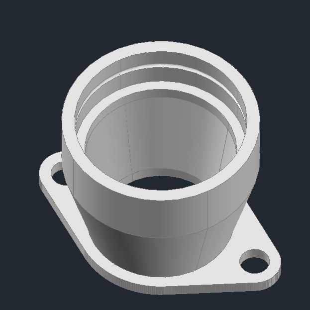

Finished the intake drawing (I think). Now I need to find someone who can print a prototype for me.

McMark   Finished the intake drawing (I think). Now I need...   Aug 9 2013, 01:15 AM
jimkelly   will those Polaris fuel injectors provide enough f...   Aug 9 2013, 06:48 AM
McMark   The injectors are pretty standard. So I was alrea...   Aug 9 2013, 10:39 AM
polo classic   Do you know what distance is from the throttle bod...   Aug 9 2013, 12:33 PM
McMark   Not sure. I drew up 'shorties' because on...   Aug 9 2013, 01:59 PM
McMark   Ahhh, thats makes more sense. ;) I expect it runs....   Aug 9 2013, 04:29 PM
McMark   Prototype printing underway (not by me). :boing:   Aug 9 2013, 07:28 PM
McMark   All done an ready to ship to me. :boing:   Aug 9 2013, 11:09 PM
euro911   Cool. What is the material, Mark?   Aug 10 2013, 01:09 AM
jimkelly   why the groove seen from top? is it a two piece p...   Aug 10 2013, 04:17 AM
jpnovak   I hope Mark doesn't mind my response. I am pr...   Aug 10 2013, 06:18 AM
Krieger   Very cool to see the cutting edge printing edge a...   Aug 10 2013, 09:27 AM
McMark   Thanks for chiming in Jamie. I didn't know if...   Aug 10 2013, 09:39 AM
