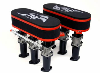

Do you know what distance is from the throttle body to the valve on the OEM Porsche high butterflies throttle bodies?
From looking at the Rothsport versions, it looks like the manifolds are around twice the height of the throttle bodies
(IMG:http://www.914world.com/bbs2/uploads_offsite/rothsport-racing.com-13650-1376073558.1.jpg)

polo classic   Do you know what distance is from the throttle bod...   Aug 9 2013, 12:33 PM
McMark   Not sure. I drew up 'shorties' because on...   Aug 9 2013, 01:59 PM
McMark   Ahhh, thats makes more sense. ;) I expect it runs....   Aug 9 2013, 04:29 PM
