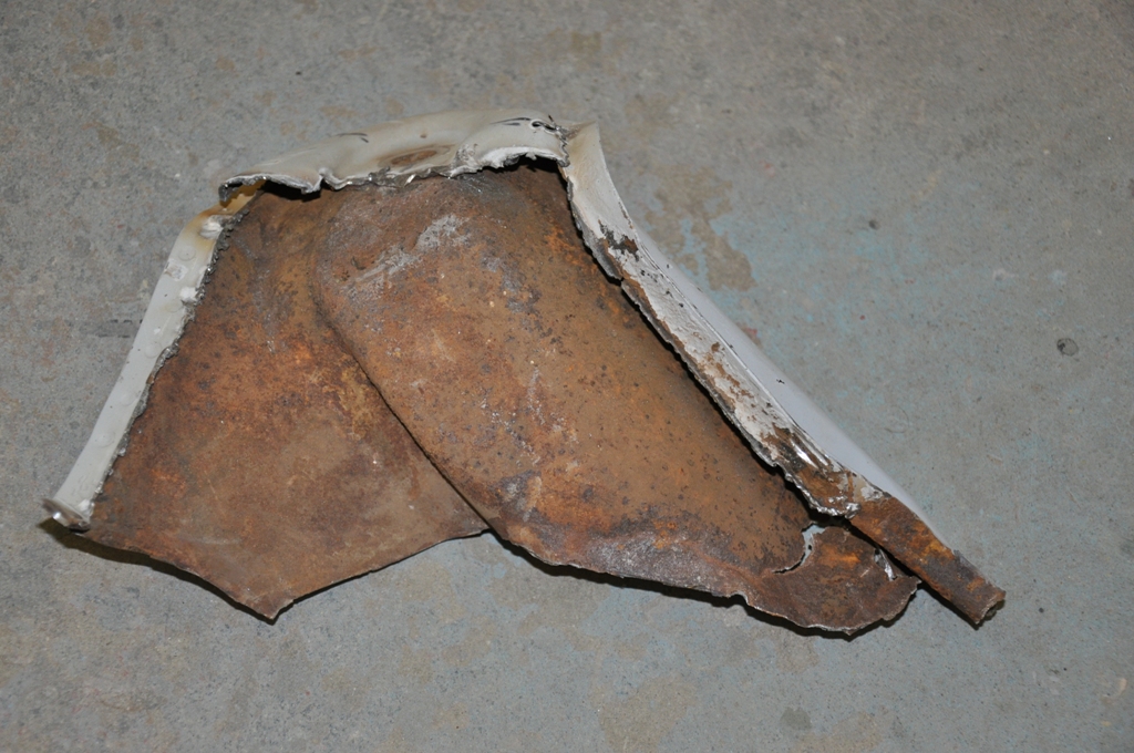

I'm sure this is a regular thing with our cars. replaced the Passenger sided completely and used rust encapsulator inside the drivers side. Here's what the inside looked like, a lot of rust in the bottom for sure.

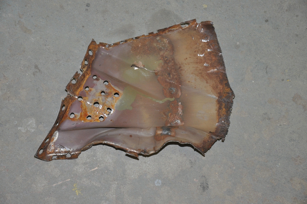

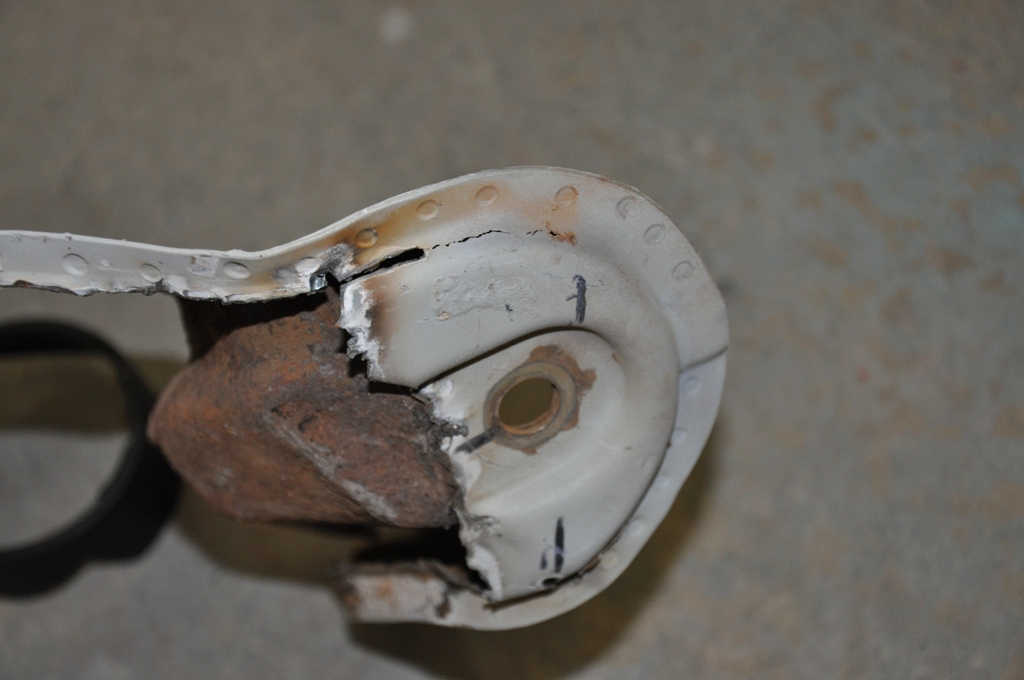

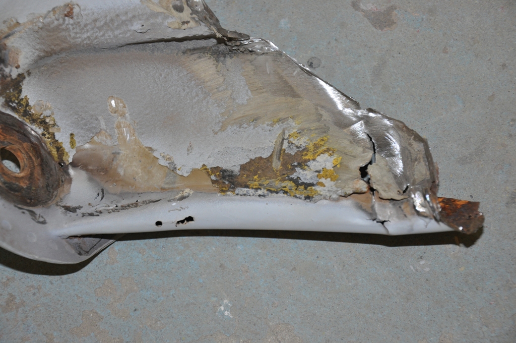

sean_v8_914   here is another example of what happens when we st...   Aug 13 2013, 07:50 AM
sean_v8_914   i really want to do some CFR raised mounts on the ...   Aug 13 2013, 07:52 AM
naro914   Everything...and I mean everything, got cut out an...   Aug 13 2013, 08:00 AM
naro914   oh, and fyi, there was NO rust anywhere in there. ...   Aug 13 2013, 08:04 AM
