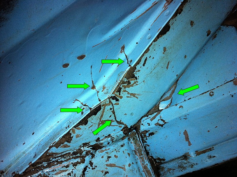

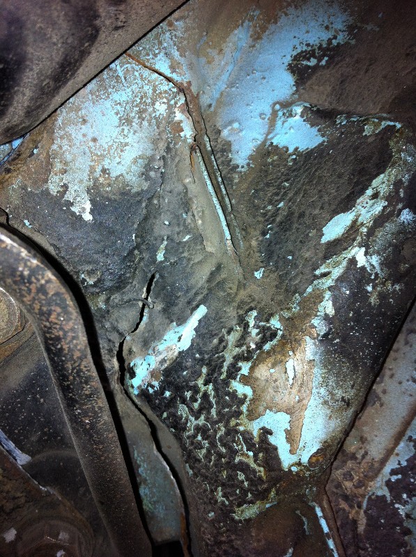

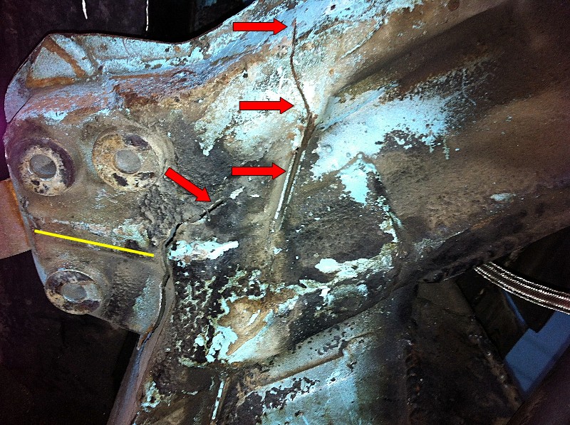

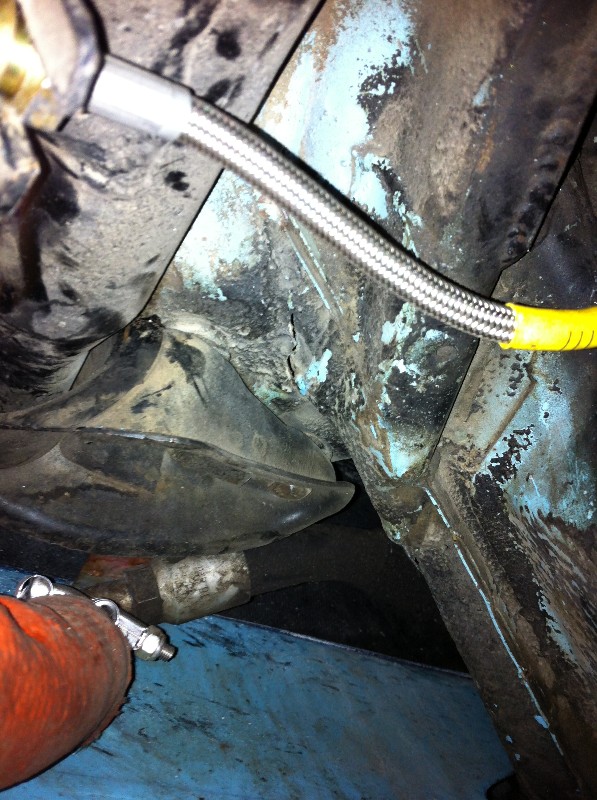

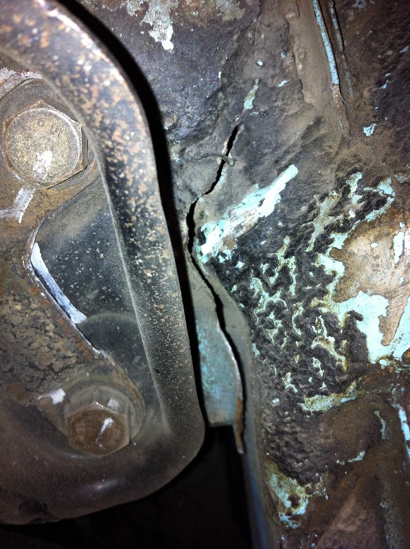

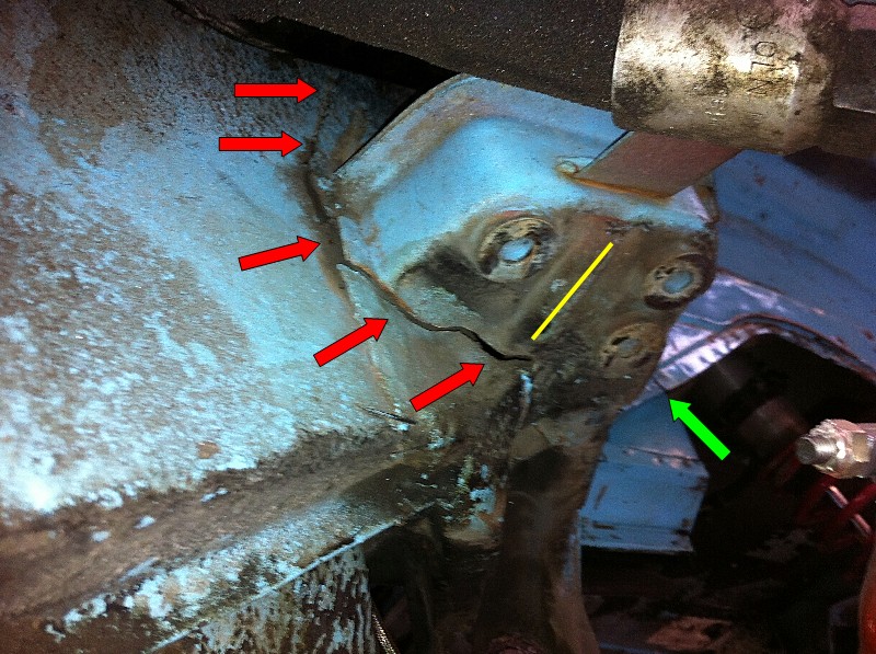

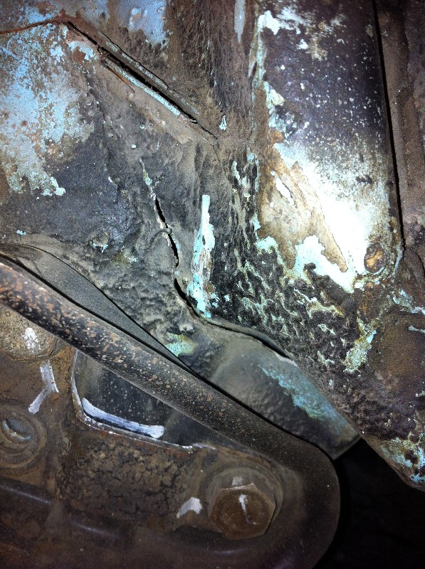

Yes, get your cars on a lift and check it over.... A couple years ago, I was planning to scrape all the undercoating off Papa Smurf a couple weeks after I had just run my last PCA Club Race of the year...
To my surprise I found this:
Which after further investigation, became this:
I've since replaced EVERYTHING with the Tangerine Racing raised rear pickup points kit.

sean_v8_914   here is another example of what happens when we st...   Aug 13 2013, 07:50 AM
sean_v8_914   i really want to do some CFR raised mounts on the ...   Aug 13 2013, 07:52 AM
naro914   Everything...and I mean everything, got cut out an...   Aug 13 2013, 08:00 AM
naro914   oh, and fyi, there was NO rust anywhere in there. ...   Aug 13 2013, 08:04 AM
