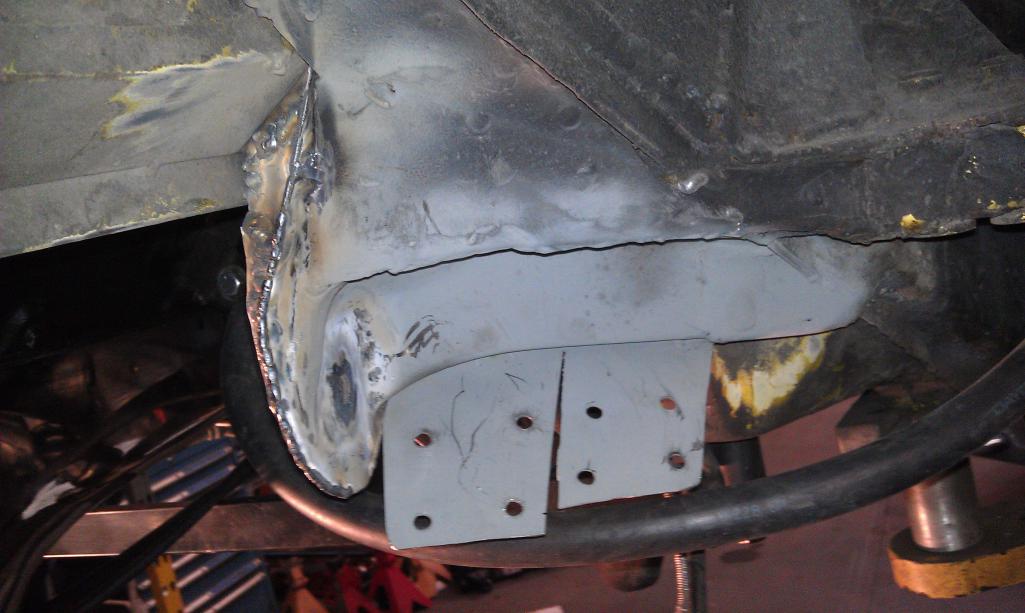

I've just welded on some suspension ear re-inforcements from Tangerine Racing.. I'm looking to put in a Suby engine so figured it was wise..
(IMG:http://www.914world.com/bbs2/uploads_offsite/i1235.photobucket.com-13282-1376257919.1.jpg)
Before I slapped on the primer, I thought I'd just go over the whole thing again with a cup brush on the grinder, and to my surprise, found this 'little' hole lurking on the underside..
(IMG:http://www.914world.com/bbs2/uploads_offsite/i1235.photobucket.com-13282-1376257920.2.jpg)
OK, so my repair job looks a bit of a dog's dinner but it's solid to say the least. I would say the car I'm restoring generally has a 'normal' amount of rust, not excessive and certainly repairable for a novice like me. But before I removed the paint from the ear there were no signs of any holes...
(IMG:http://www.914world.com/bbs2/uploads_offsite/i1235.photobucket.com-13282-1376257920.3.jpg)
Now I don't like to stir, but the whole thing did get me wondering how many other 914s are out there being driven unwittingly with potential issues like this..I'm sure suspension mounts with holes like thiese can't be safe surely?! Next time you get a chance, you might want to have a quick check of your own.

YOU NEED TO CONNECT THE LOWER RIBS!
you cant stop there or it will rip where teh reinforcement ends

QUOTE(sean_v8_914 @ Aug 12 2013, 07:22 AM) *
Sean...
Are you sayin to weld up the drain hole?
bulitt
post Aug 13 2013, 02:31 AM
Achtzylinder
Posts: 4,189
Joined: 2-October 11
Member No.: 13,632
QUOTE(914_teener @ Aug 12 2013, 09:47 PM) *
Sean...
I believe he is saying when you reinforce the ear alone it just moves the potential failure point to the two ribs that extend to the outer suspension ear. Chris has said this also. So in this pic from Sean you will see the two flat pieces of metal hanging down. I believe he wraps them around the rib and welds them on as reinforcement.
This ties the ear to the body.
