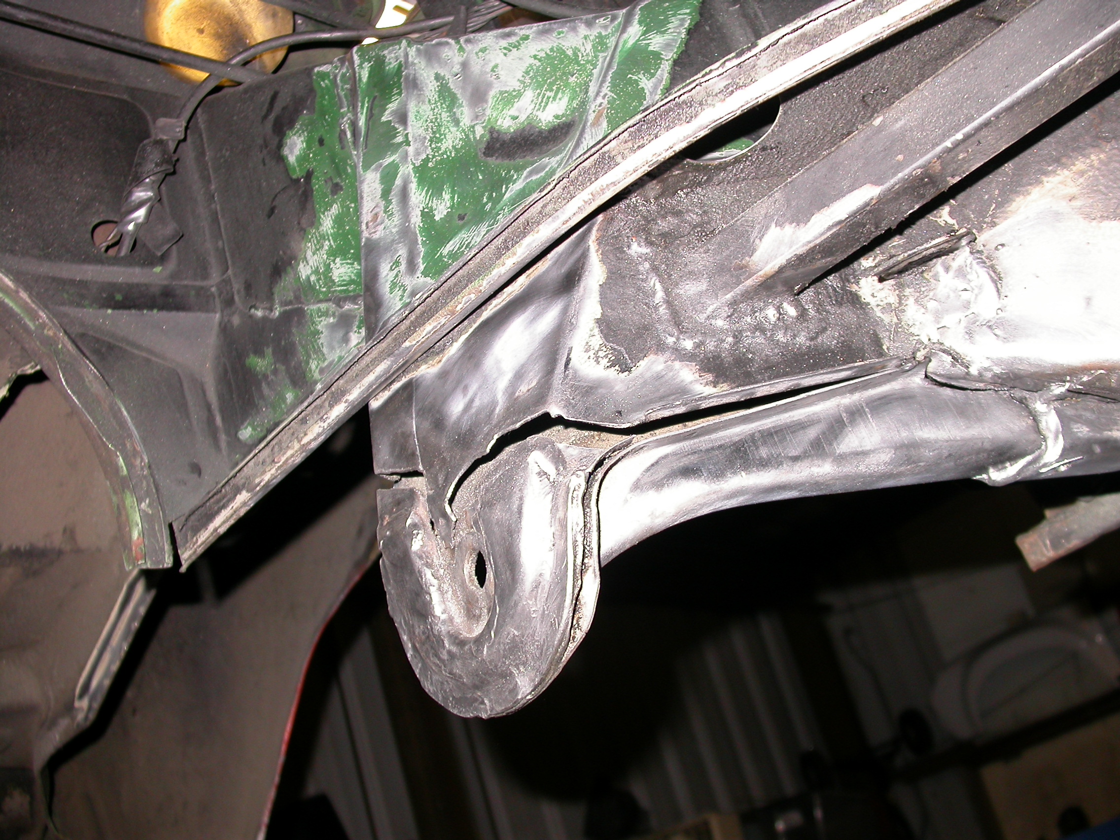

here is another example of what happens when we stop short of a complete reinforcement of this area

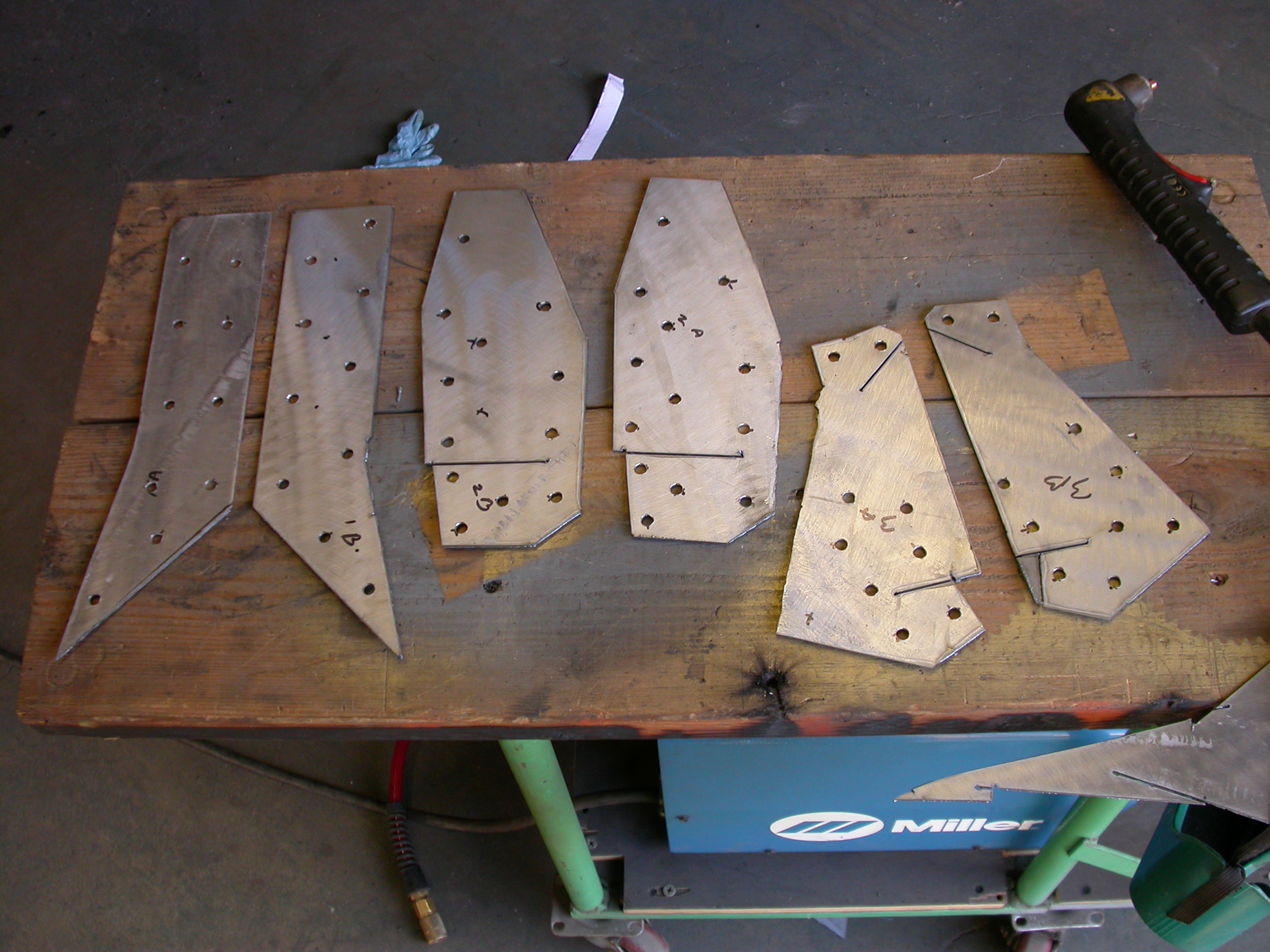

front rib, back rib, under long up to shock tower, seam welded, re do spot welds
note that this ear is not rusty inside. fat sticky tires did this...and a guy that knows how to make them stick of course.

sean_v8_914   yes, it wraps around to the inside. i do both ribs...   Aug 13 2013, 07:41 AM
OllieG   yes, it wraps around to the inside. i do both rib...   Aug 13 2013, 09:29 AM
sean_v8_914   here is another example of what happens when we st...   Aug 13 2013, 07:50 AM

naro914   Everything...and I mean everything, got cut out an...   Aug 13 2013, 08:00 AM
naro914   oh, and fyi, there was NO rust anywhere in there. ...   Aug 13 2013, 08:04 AM
