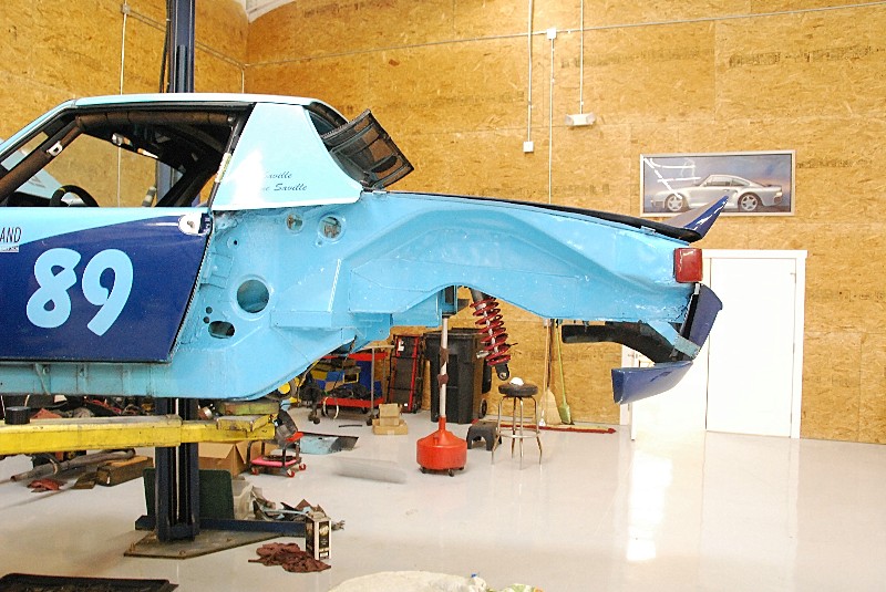

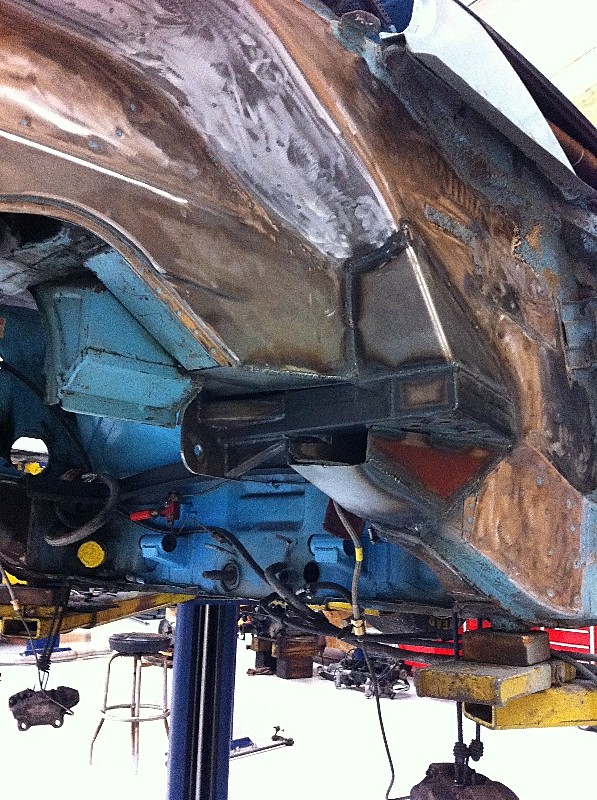

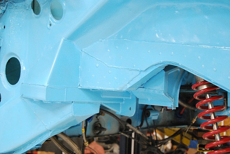

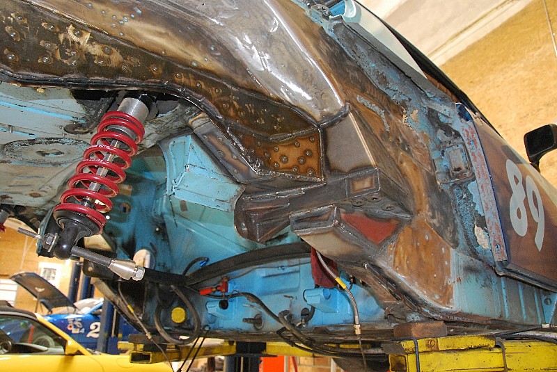

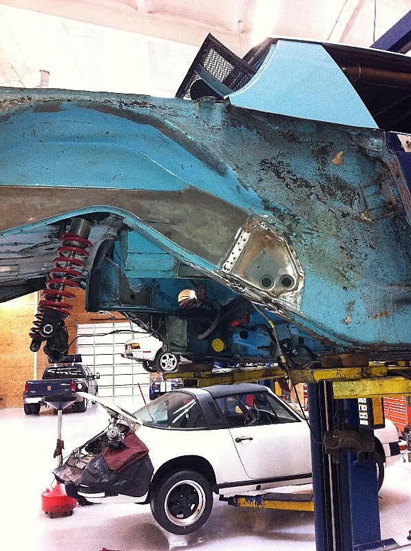

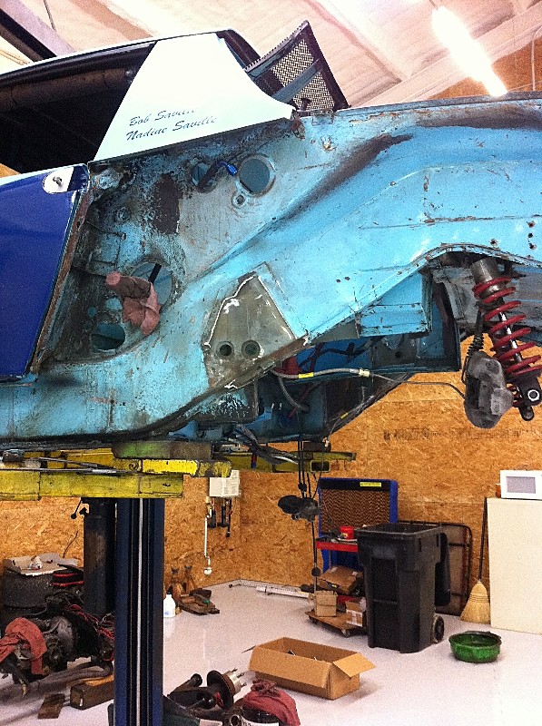

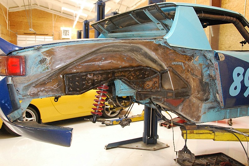

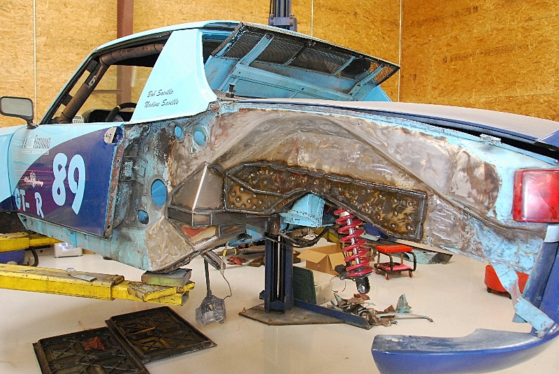

Everything...and I mean everything, got cut out and replaced with Chris' system:
After everything is cut out, weld in the kit, plus the stiffening plates for the wheel well area.

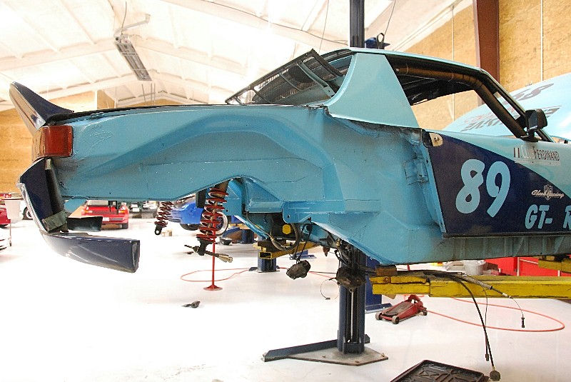

All painted and pretty!

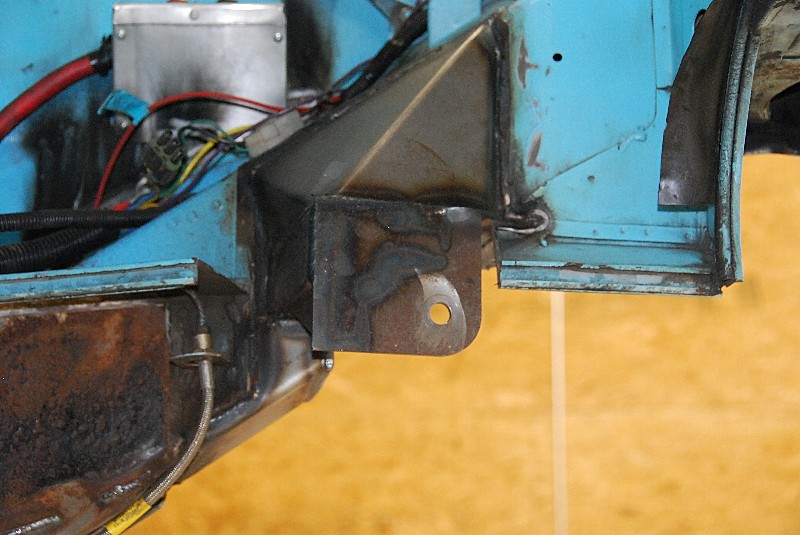

sean_v8_914   YOU NEED TO CONNECT THE LOWER RIBS! you cant s...   Aug 12 2013, 08:22 AM

sean_v8_914   both lower ribs connect to back of ear   Aug 12 2013, 08:29 AM
OllieG   both lower ribs connect to back of ear Very goo...   Aug 12 2013, 08:41 AM

sean_v8_914   yes, it wraps around to the inside. i do both ribs...   Aug 13 2013, 07:41 AM
OllieG   yes, it wraps around to the inside. i do both rib...   Aug 13 2013, 09:29 AM

naro914   oh, and fyi, there was NO rust anywhere in there. ...   Aug 13 2013, 08:04 AM
