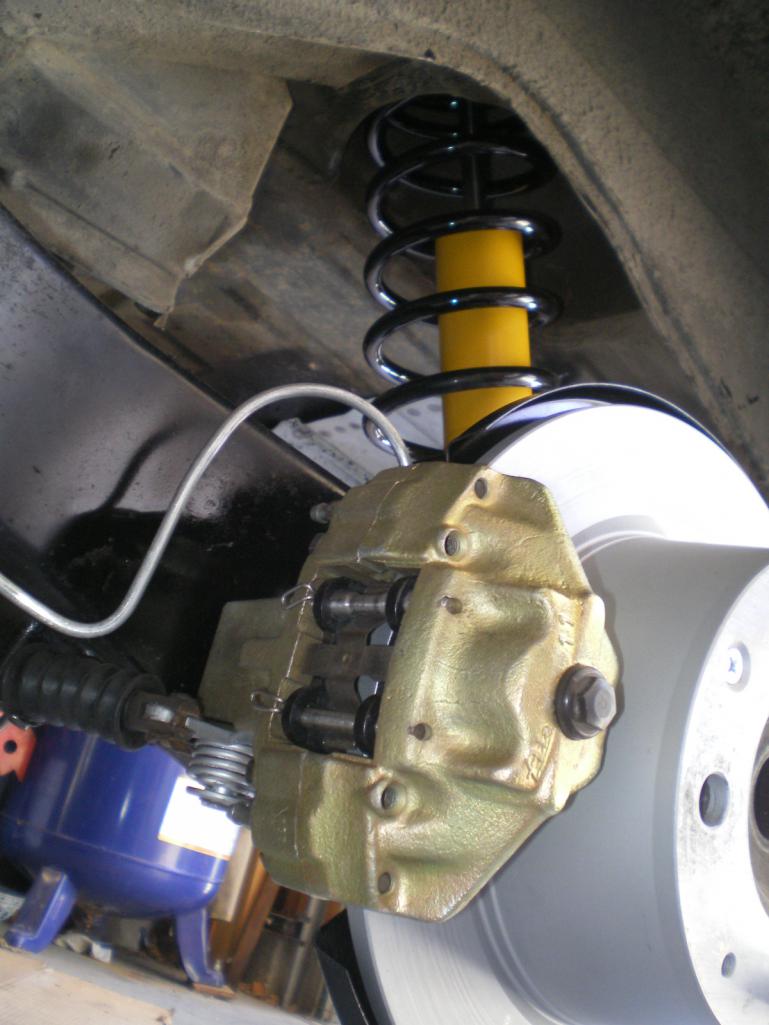

76-914   Here's some of Eric's product   Aug 13 2013, 05:51 PM
