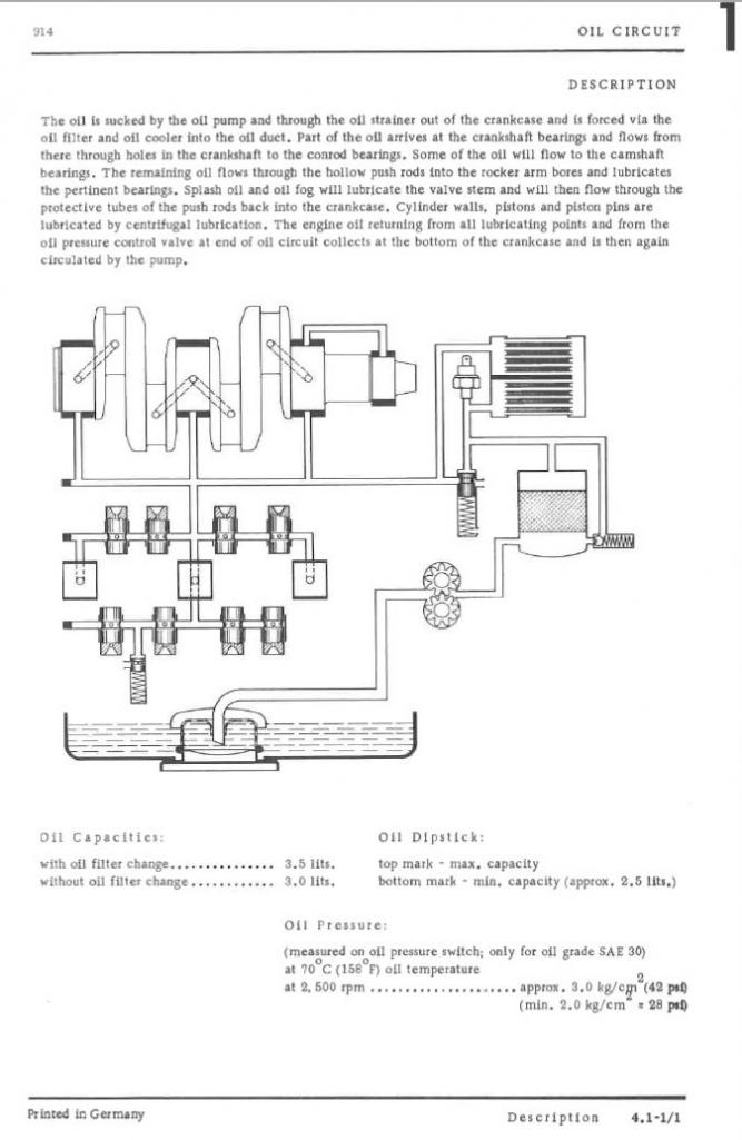

I would like to design a dry-sump type of system for my race car.
One thing I have found is that diagrams that show how the stock system works and how to modify it for other parts (coolers, dry sump, "full flow",etc) are hard to find.
So I made this diagram in Visio (CAD-like) so I can move parts around and ask the proper questions.
Does anyone have any suggestions or comments about making the diagram 100% correct before I start trying to modify it?
(IMG:http://www.914world.com/bbs2/uploads_offsite/i366.photobucket.com-10819-1376598242.1.jpg)
I could provide the original file, but not too many out there have visio.
My next step is to get out a spare case so I can see EXACTLY where these parts go, exactly what any adapter might look like, and identify where all of the galley plugs would be in the diagram.

Is this what you need?

motorvated   You labeled the oil filter bypass incorrectly.   Aug 16 2013, 06:45 AM

Dave_Darling   You're not going to remove the cooler from the...   Aug 17 2013, 11:01 PM
ClayPerrine   You're not going to remove the cooler from th...   Aug 17 2013, 11:14 PM
stugray   The next stage is remote oil filter bracket with r...   Aug 18 2013, 12:40 AM
