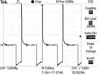

Finally got to upload this.
This is the power at the L-Jet injector terminals. The channel is obviously reversed. You can see that the injector is triggered at 12v and the spikes are created by the injector inductance.
The injection interval is 13ms and the L-Jet injects 2 times per stroke (every revolution) so this picture is at 4615 RPM.
Enjoy.

r_towle   Cool, but where is the voltage?   Aug 16 2013, 04:34 PM
Valy   Cool, but where is the voltage? The voltage is t...   Aug 16 2013, 05:08 PM
stugray   Valy, Thanks for the scope capture. It sure looks...   Aug 16 2013, 10:41 PM
Valy   Valy, Thanks for the scope capture. It sure look...   Aug 16 2013, 11:47 PM
