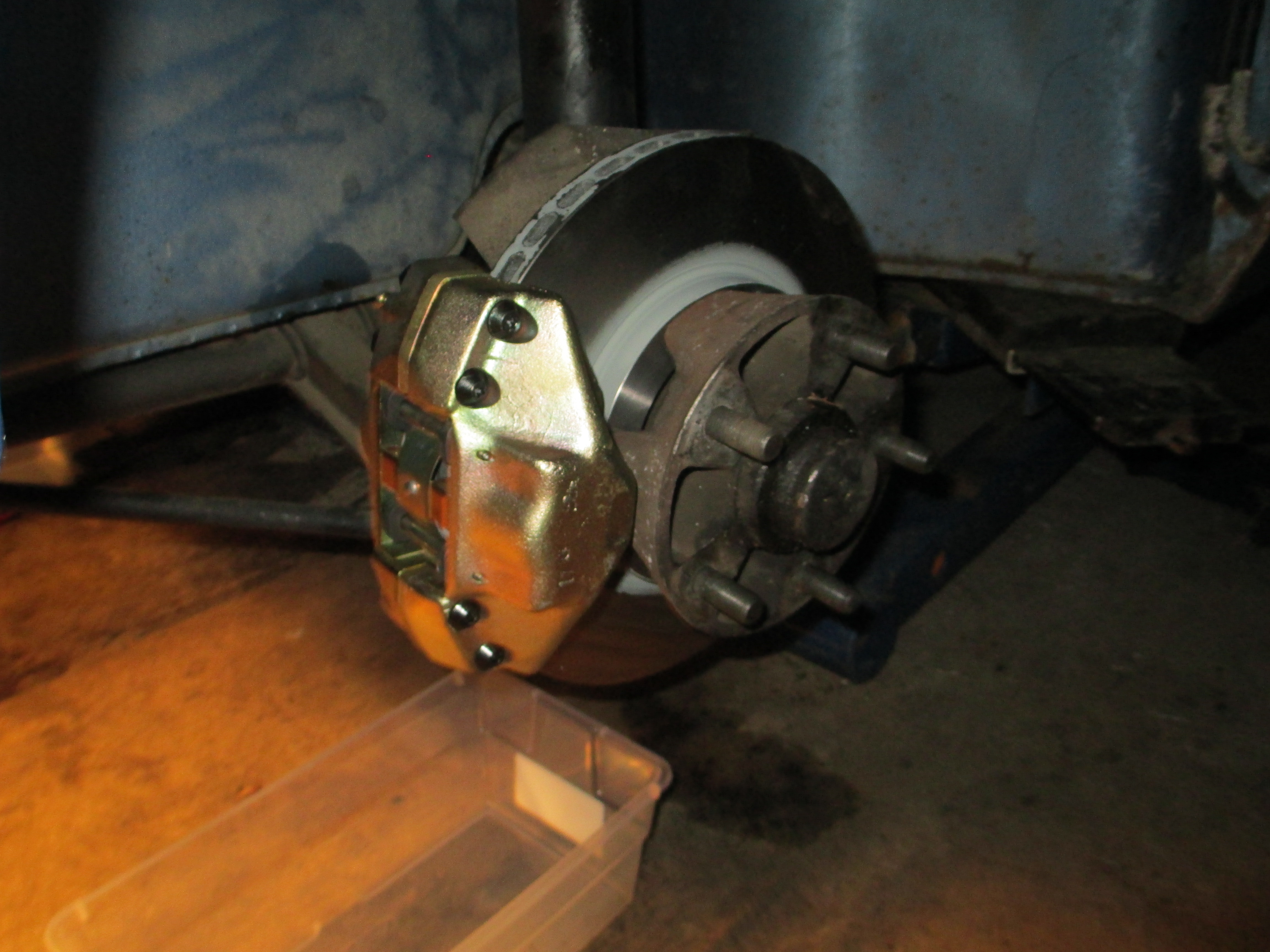

Made some progress today. Huge thanks to Marcus for coming down today & helping. I owe you bud (IMG:style_emoticons/default/beerchug.gif) . We swapped out my Master cylinder for a 19mm one. Reinstalled the front suspension. Installed my newly restored PMB brake calipers. I'd already replaced my front rotors. So my front end had a nice upgrade. Not only with the nice 5lug SC front end. But the new rotor's, Porterfield pads, Turbo tie rods & the restored calipers (IMG:style_emoticons/default/piratenanner.gif) . I also put on my new speed bleeders. Then spent a while bleeding the brake system.
With that done I am on to pulling the drivetrain. I've got a few gaskets to replace. Then swapping the old tailshift for a newer sideshift converted to cableshift. The drivetrain will be coming out this week sometime. Attached thumbnail(s) |
