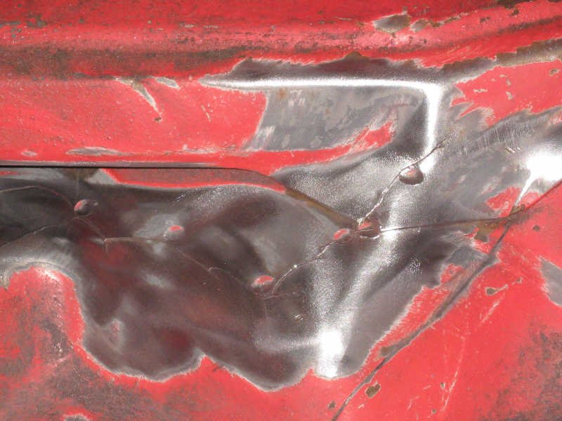

Eric_Shea   :agree: I've seen pictures of a bad bushing li...   Aug 19 2013, 08:56 AM
sean_v8_914   right along th spot weld line   Aug 19 2013, 10:27 AM
