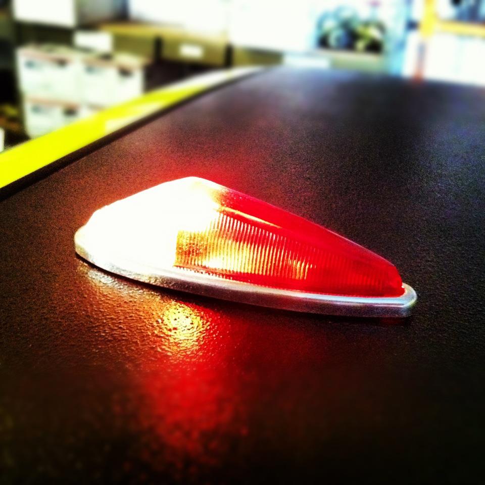

Like the roof blinker?
All sixes had those too... (IMG:style_emoticons/default/blink.gif)
(IMG:http://www.914world.com/bbs2/uploads_offsite/sphotos-a-dfw.xx.fbcdn.net-1110-1377661045.1.jpg)
