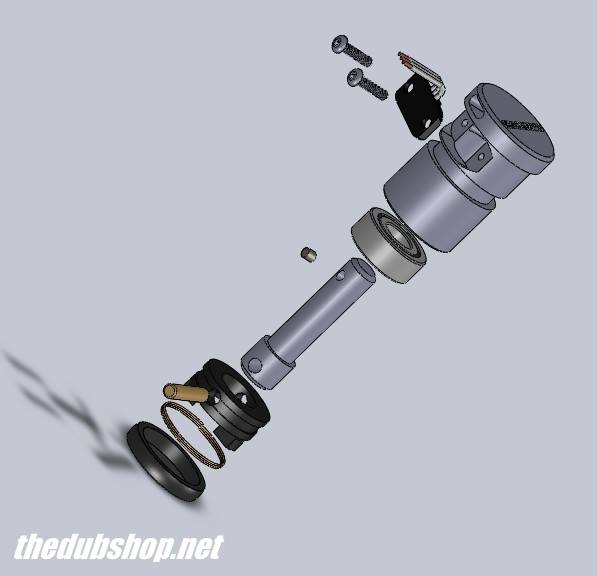

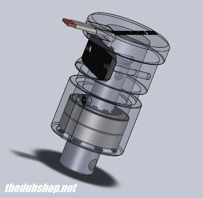

My new project is a Mini Cam Sync for sequential fuel and spark. There isn't a good solution so I'm making one.
Here where my first thoughts

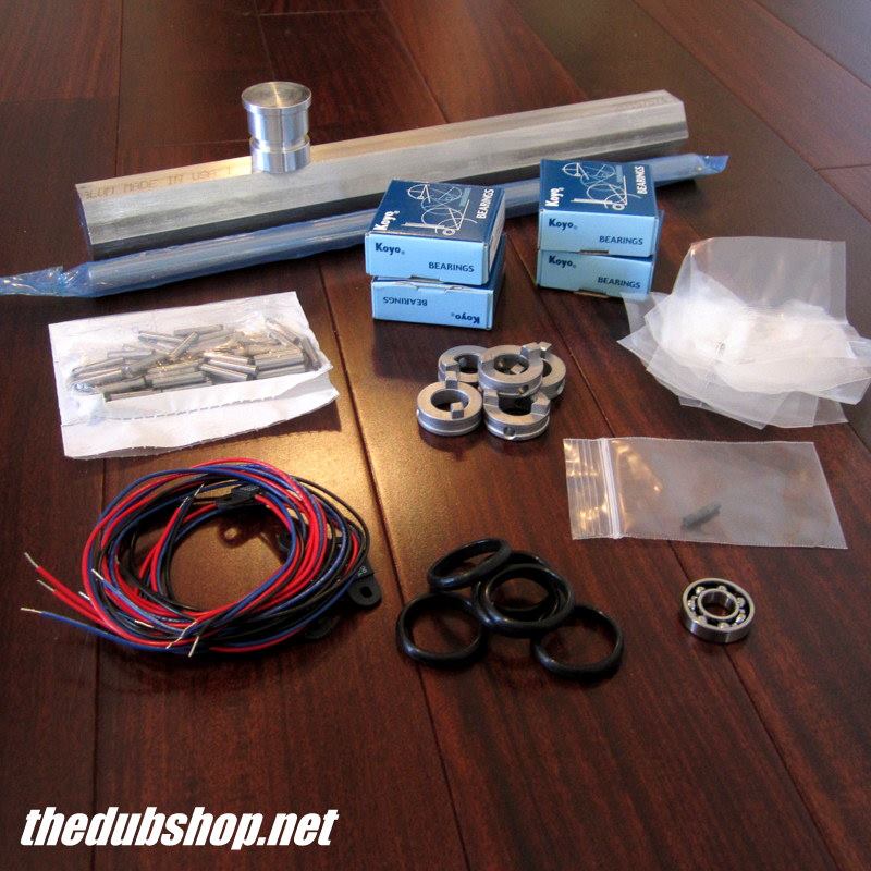

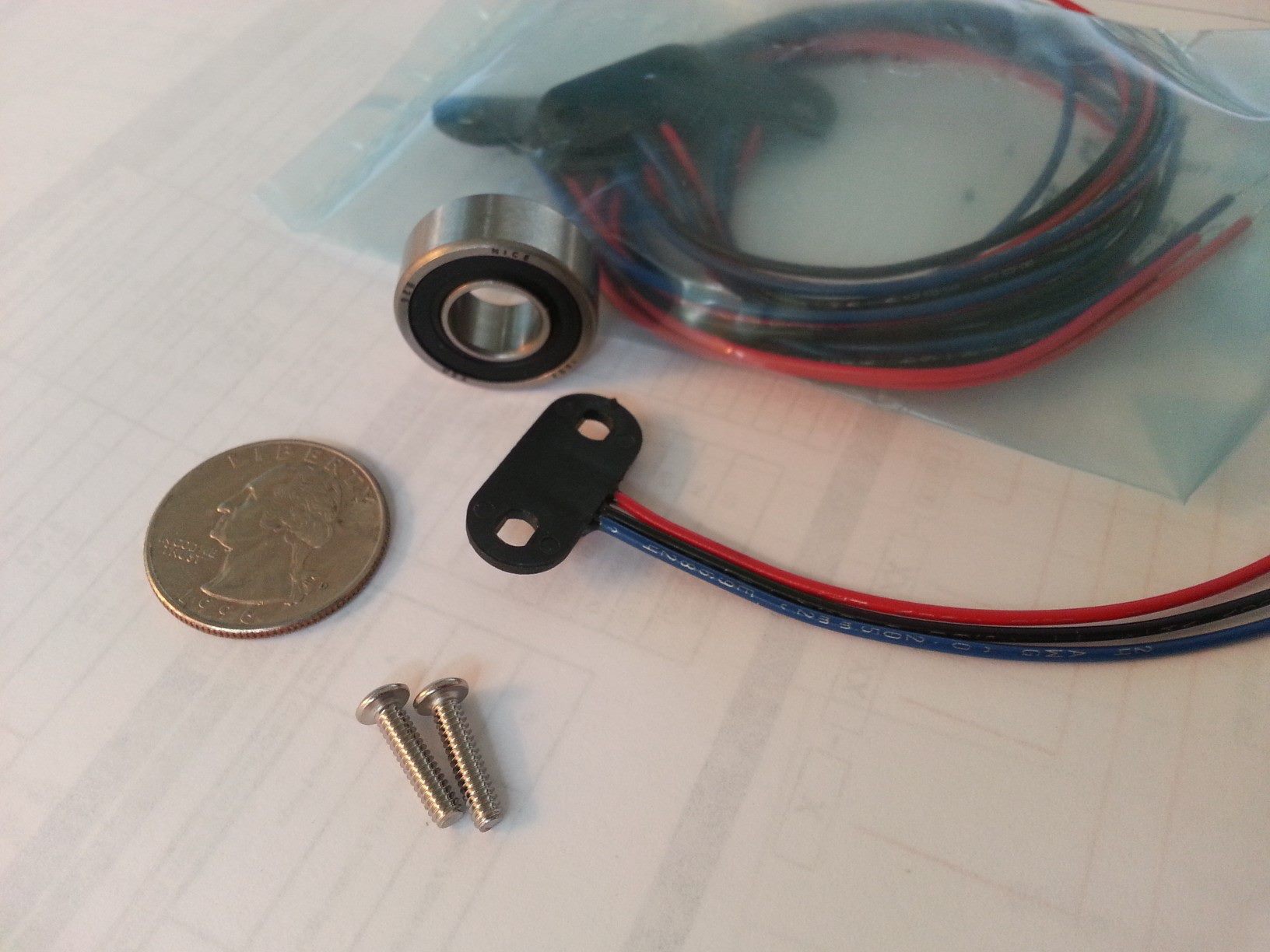

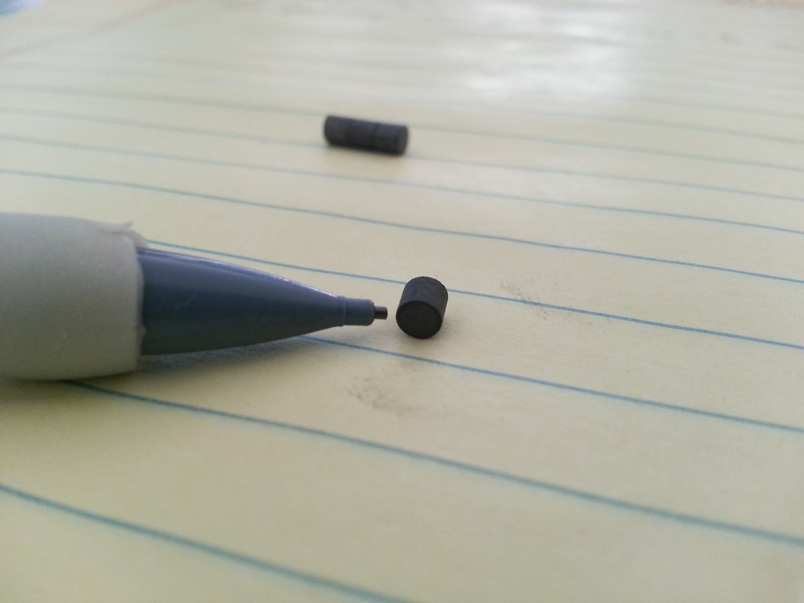

Gathering parts for the first prototypes.

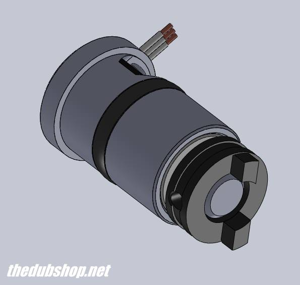

I have made some changes since these drawings. Mainly using dual bearings to better support the shaft to keep it straight, added in some retaining clips to hold stuff together instead of relying on everything to press fit and added in the factory oiling instead of using sealed bearings.
So here is where I'm at right now. Still need to change a couple little things and then send off files in exchange for parts (IMG:style_emoticons/default/biggrin.gif)
