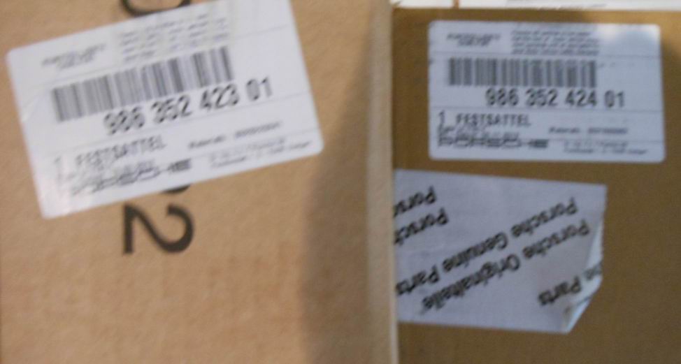

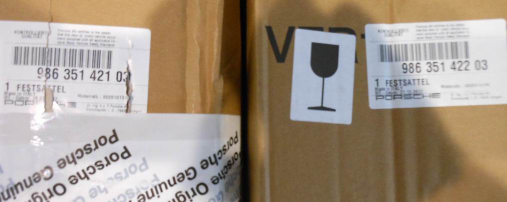

CptTripps   So here I go digging up an old thread, and digging...   Aug 30 2013, 01:28 PM
Luke M   I just checked my calipers and this is what I have...   Aug 30 2013, 04:00 PM
CptTripps   I think you may have a set of fronts on the rear.....   Aug 30 2013, 05:15 PM
Luke M   From the Pelican site. http://www.pelicanparts.co...   Aug 30 2013, 05:38 PM
Jeff Hail   From the Pelican site. http://www.pelicanparts.c...   Aug 30 2013, 06:01 PM
amallagh   What happens if you use the 996 part number rear c...   Mar 17 2019, 06:58 PM
Jeff Hail   and pads   Aug 30 2013, 06:10 PM
CptTripps   Hmmm... I've got another set on the way. So I...   Aug 30 2013, 07:08 PM
