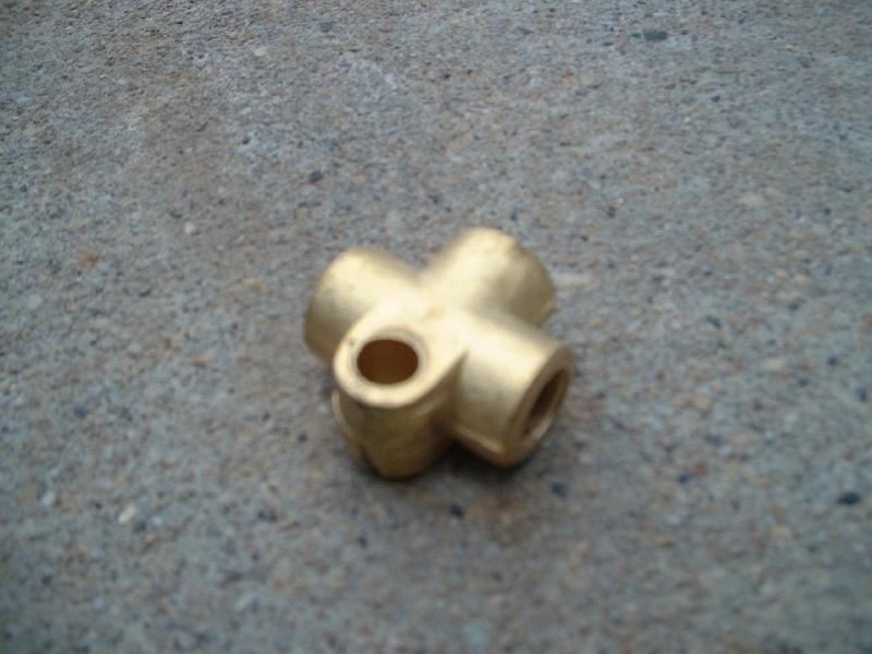

I have a couple good proportioning valves if you want to try a different one.
I also have one of these if you want to try it (warning Andy shot to follow): (IMG:style_emoticons/default/laugh.gif)
