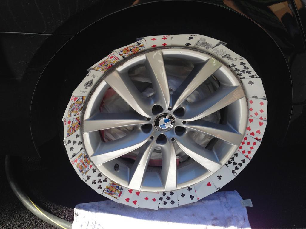

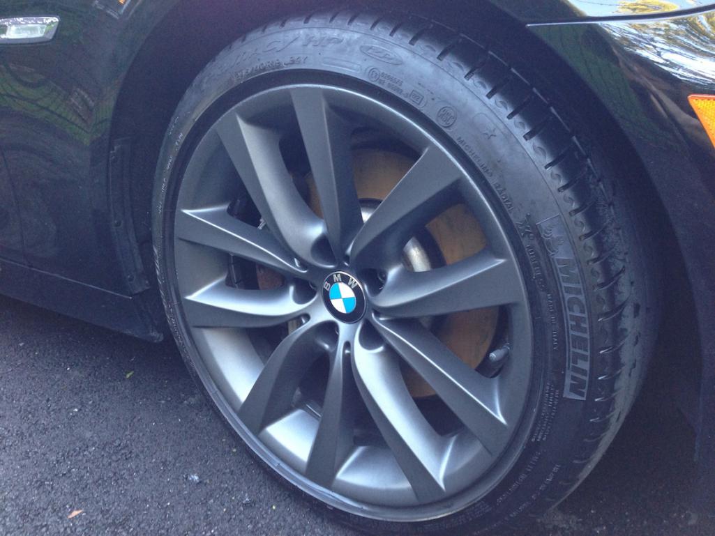

PlastiDip on the rims on my BMW tonight...to see how they'd look and hold-up in a real-world environment.
It seriously only took about 45min for the prep and application. A deck of cards works real well to keep the spray off of the tires.
4-5 coats and I was in business. I only used 2 cans, and these rims are 19" and pretty complicated with a lot of surface and nooks/crannies. I'm guessing you could get away with 2-3 cans and have plenty left over on standard 17" rims.
