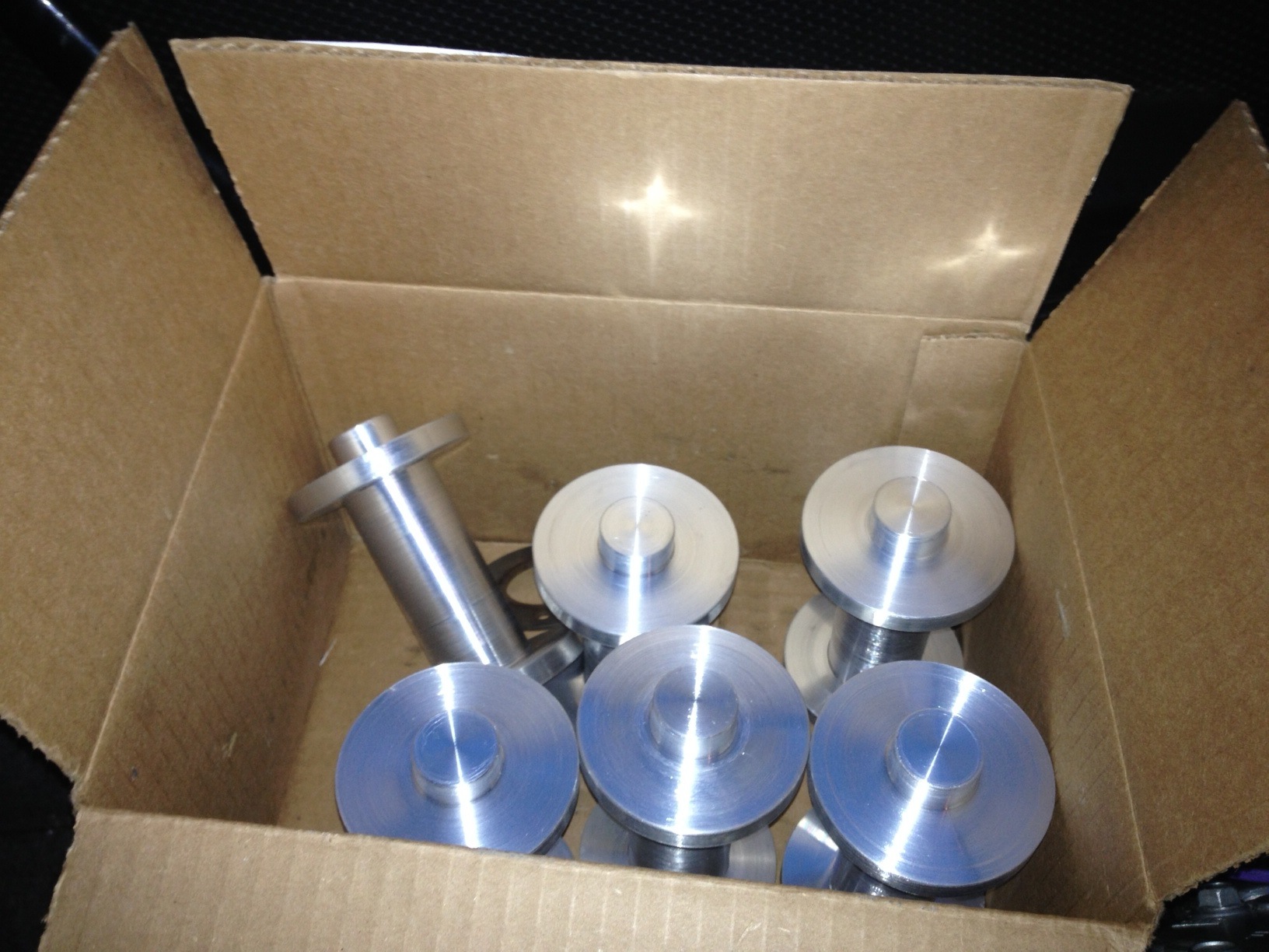

Just an update. I made a batch of extra adapters that I'd sell to anyone interested. Each would include the necessary hardware. Pulley not included. $85 shipped conus I apologize for the crappy pics.
I am also putting together at least two "kits" that I'll be selling shortly which includes the drive pulley, compressor, mount, hardware and everything necessary to mount a compressor on top of the motor. Stayed tuned for that.

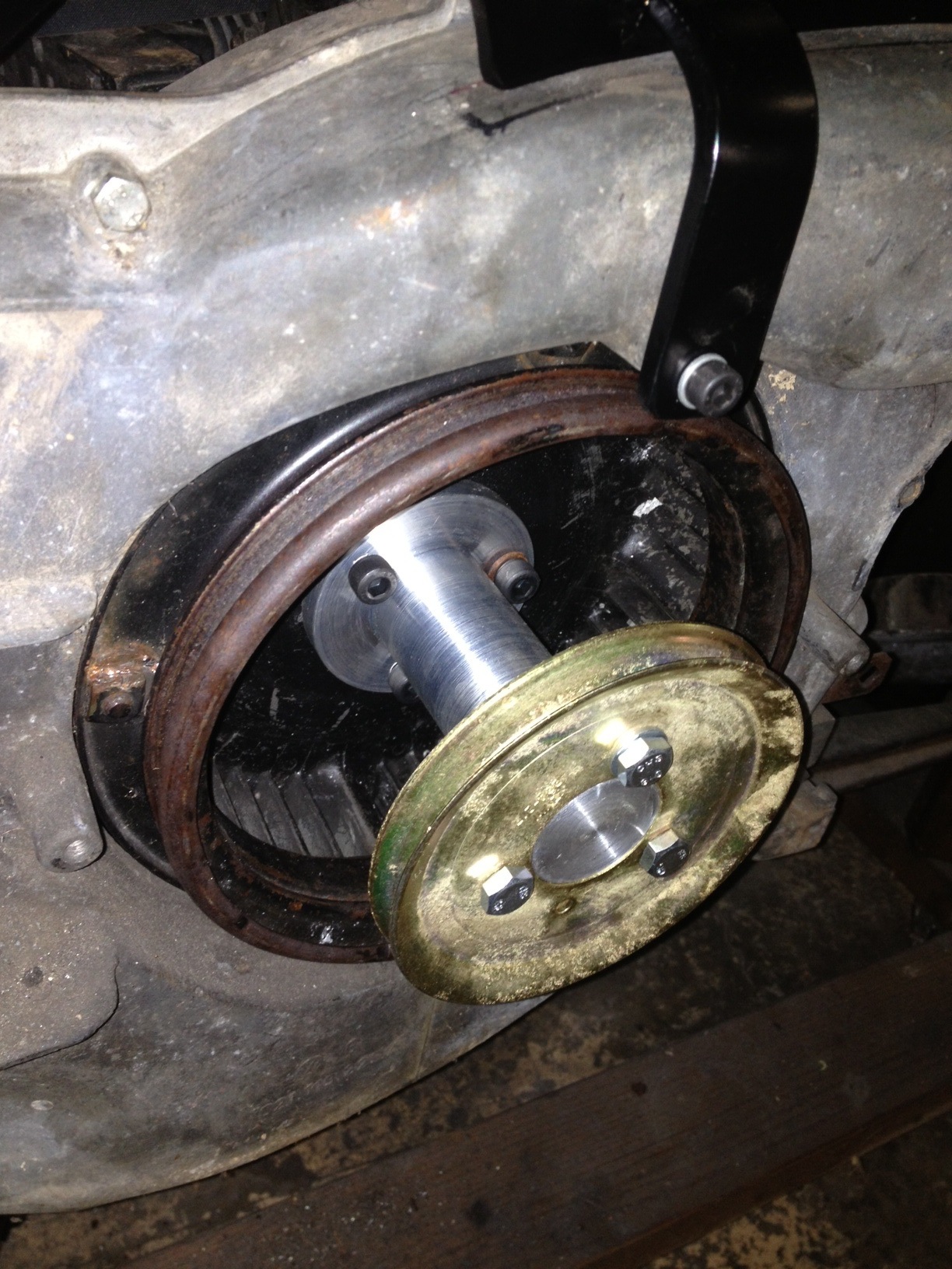

dlee6204   I made some progress on my A/C pulley. As I state...   Nov 25 2012, 04:12 PM

dlee6204   Not a big update but I did finish the pulley adapt...   Jan 24 2013, 07:51 PM
