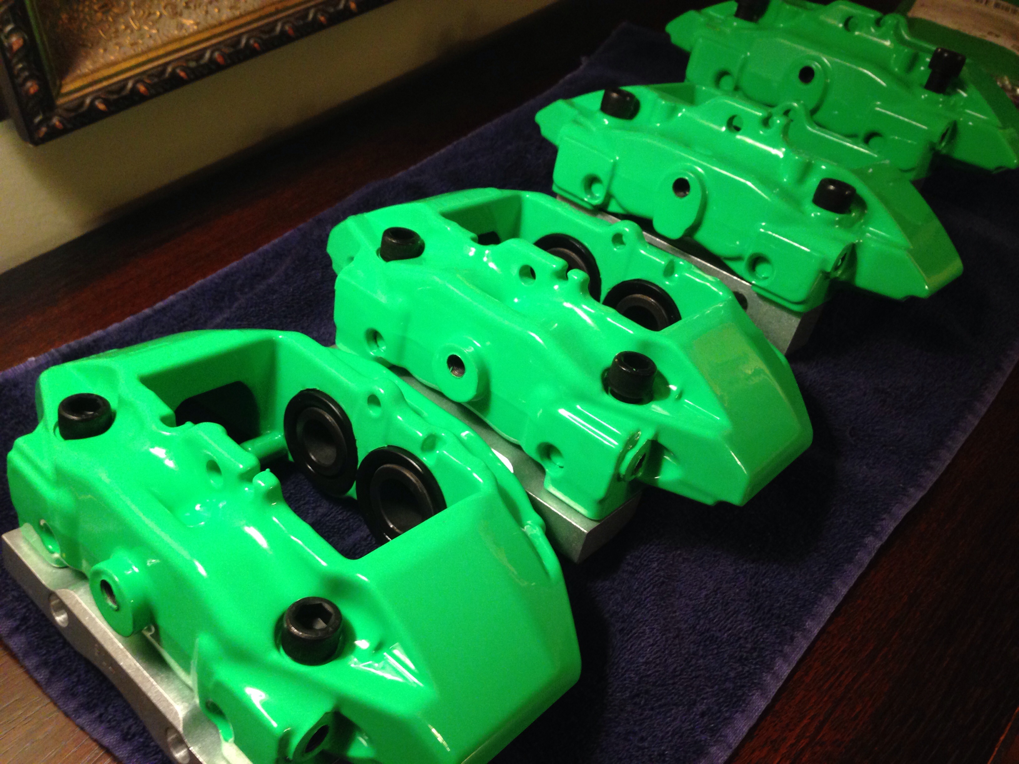

Got the calipers sorted last night. Started rebuilding them, and realized I was missing one seal. Doh! Called the PC place and they have it. :whew:
Also realized I put the wrong adapters on the wrong calipers too. So that'll get fixed tonight.

CptTripps   Got the calipers back from powder-coating. They lo...   Sep 11 2013, 10:59 AM

Chris H.   Dude those calipers look like candy. Wow.   Sep 12 2013, 04:18 PM
CptTripps   Dude those calipers look like candy. Wow. They ...   Sep 12 2013, 09:10 PM

CptTripps   The calipers were powder-coated...the "PORSCH...   Sep 25 2013, 09:01 AM
