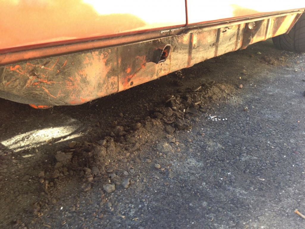

Started working on the flares today. Marked everything out before I take it to a friend's to weld them up.
Took the rockers off and the car lost about 11lb. Holy crap.
