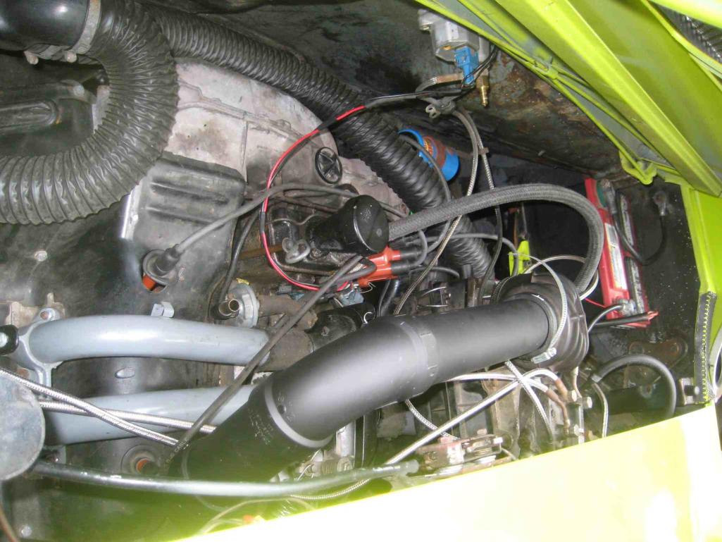

I finally got to drive my 914 again! (IMG:style_emoticons/default/mueba.gif) (IMG:style_emoticons/default/biggrin.gif) Back in June I was having fits with the L-Jet system that was on my car so I decided it was time to tackle a project I was wanting to do for some time, a CIS conversion.
I retrofitted a CIS Basic system to my stock 1.8L engine using parts from various VWs and Mercedes and today I fired it up for the first time and was able to take it for a long drive. It felt AWESOME. Smooth reliable power all the way to redline. It has a nice growl to it too. (IMG:style_emoticons/default/evilgrin.gif) I'm quite impressed. I still have to make some small adjustments but at least now I can get back to driving the car daily and the best part, NO MORE JACKSTANDS! I'm going to drive the snot out of the car this week to get the system dialed in and hopefully next weekend I will take it for a day drive in the mountains. (IMG:style_emoticons/default/driving.gif) More details and pics to come later.
The cat is happy too!

So, how did you guys transition from the boot on the intake air sensor to the throttle body? This pic looks like black ABS pipe

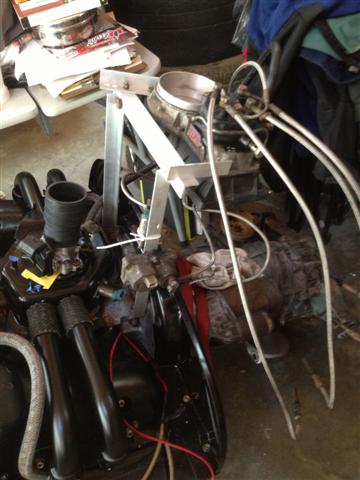

but I can't, yet, find a good way to get to the throttle body. I'm trying to get to a 2L throttle body in pic below:
The mixture system is not in final position for installation; this is to hopefully see if I/we can get the motor running out of the car.
2 more questions:
Do you have "stock" fuel lines or SS fuel lines? Any problems with adequate flow of fuel thru the lines to the fuel distributor?
What initial adjustments were needed to make the system run on a motor? Was it just bolted on and it ran?
