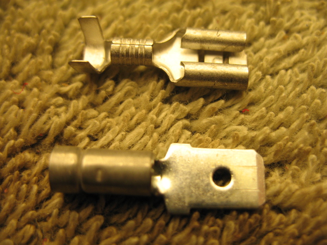

fwiw - the male spade has a different, double crimp, than the female.
seems the male also requires a different crimp tool ??
any idea where to get male spades with same double crimp as female's above ??
I see some on ebay without locking tab but they are made in china
