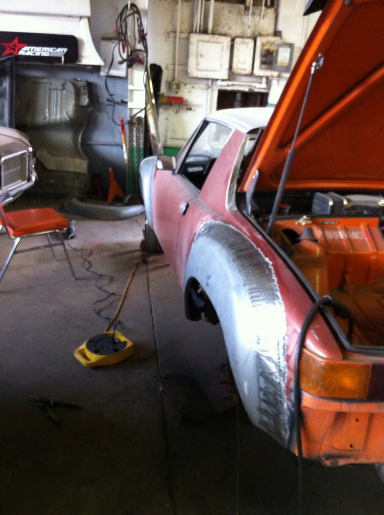

CptTripps   Started working on the flares today. Marked everyt...   Sep 14 2013, 04:26 PM
CptTripps   Flares are on...time for some banging and bondo th...   Sep 19 2013, 08:15 AM
Chris H.   Wow that looks great. Did you do those yourself?   Sep 19 2013, 10:16 AM

CptTripps   Flares on 8 days after taking possession. You gu...   Sep 20 2013, 06:59 AM

CptTripps   Most of the gaps between welds are under 1/2...   Sep 22 2013, 07:13 AM
CptTripps   Worked on welding up the gaps today. My welder too...   Sep 22 2013, 04:25 PM
jimkelly   what wire are you using? .025 easy grind? gloss s...   Sep 22 2013, 04:34 PM
CptTripps   I was using .23-eg, but honestly, I found .30 easi...   Sep 22 2013, 07:20 PM
