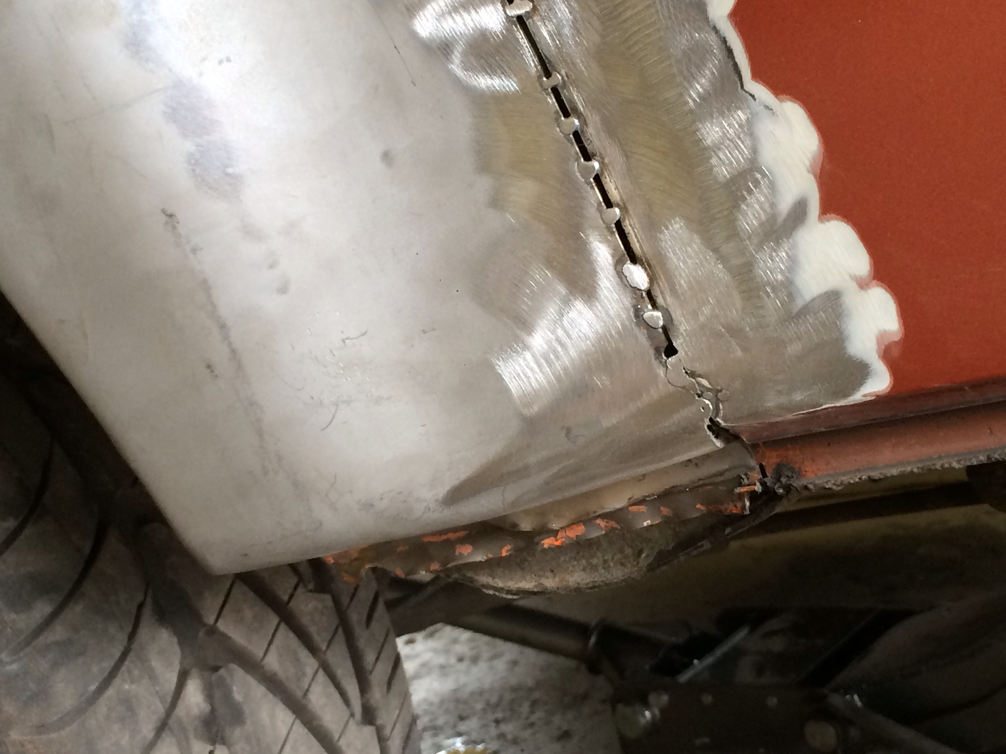

Today's delima: Should I weld all these gaps, or use AllMetal to fill them?

strawman   As someone who has done the trailing arm reinforce...   Sep 21 2013, 10:44 PM
CptTripps   As someone who has done the trailing arm reinforc...   Sep 23 2013, 06:37 AM

jimkelly   I think the consensus will be to fully spot the en...   Sep 22 2013, 06:48 AM
McMark   :o Weld it all.   Sep 22 2013, 07:12 AM
CptTripps   Most of the gaps between welds are under 1/2...   Sep 22 2013, 07:13 AM
CptTripps   Worked on welding up the gaps today. My welder too...   Sep 22 2013, 04:25 PM
jimkelly   what wire are you using? .025 easy grind? gloss s...   Sep 22 2013, 04:34 PM
CptTripps   I was using .23-eg, but honestly, I found .30 easi...   Sep 22 2013, 07:20 PM
