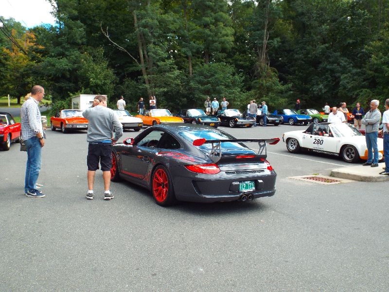

grey black is nice, not sure I am fully sold on it, not sure I am sold on satin finish in general, this grey red combo is somewhat appealing too?
