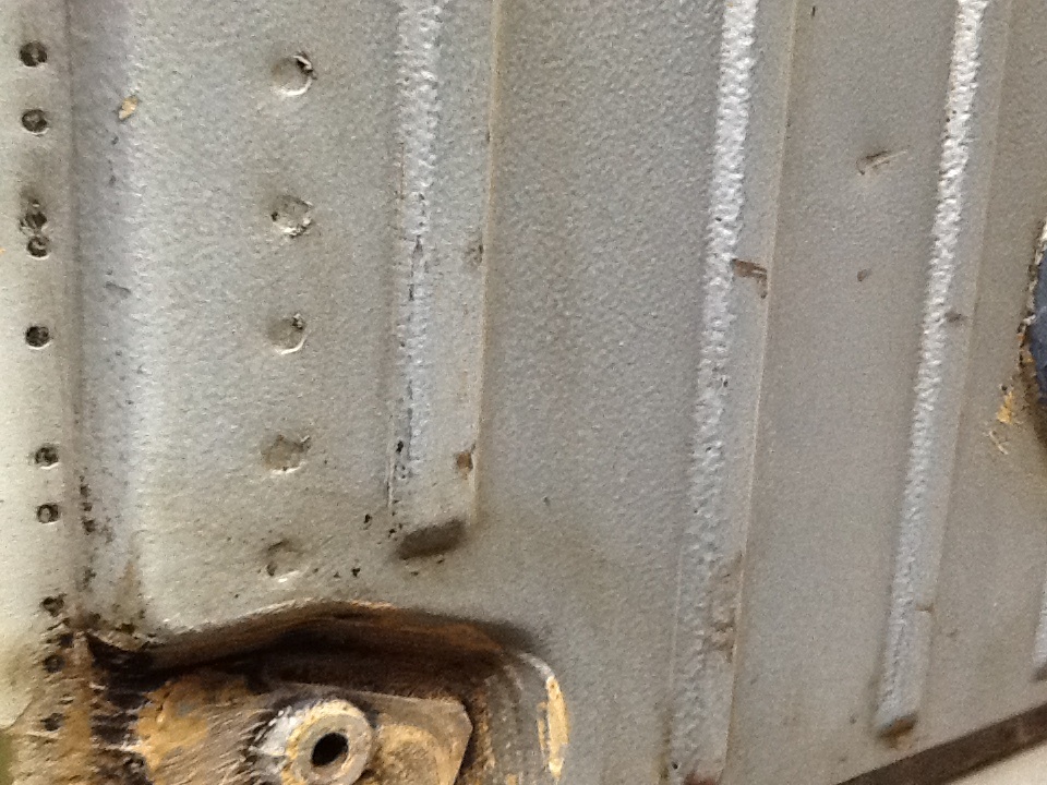

911 have the pebble finish ..914's PVC is pretty smooth with orange peel and sags here and there.

QUOTE(sixnotfour @ Sep 21 2013, 09:55 AM) *

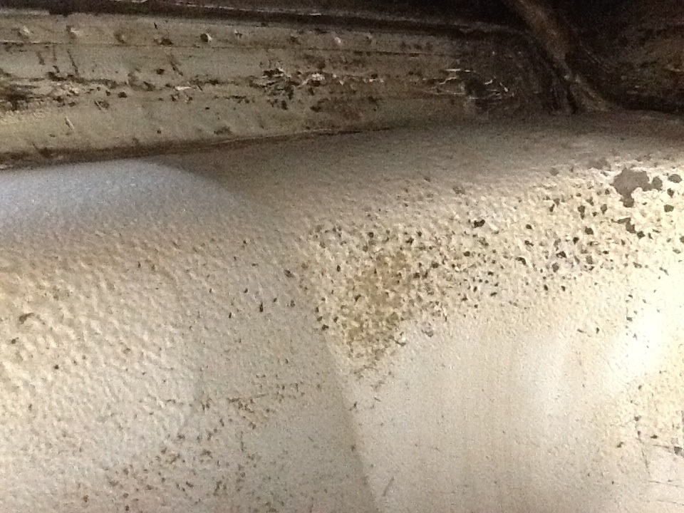

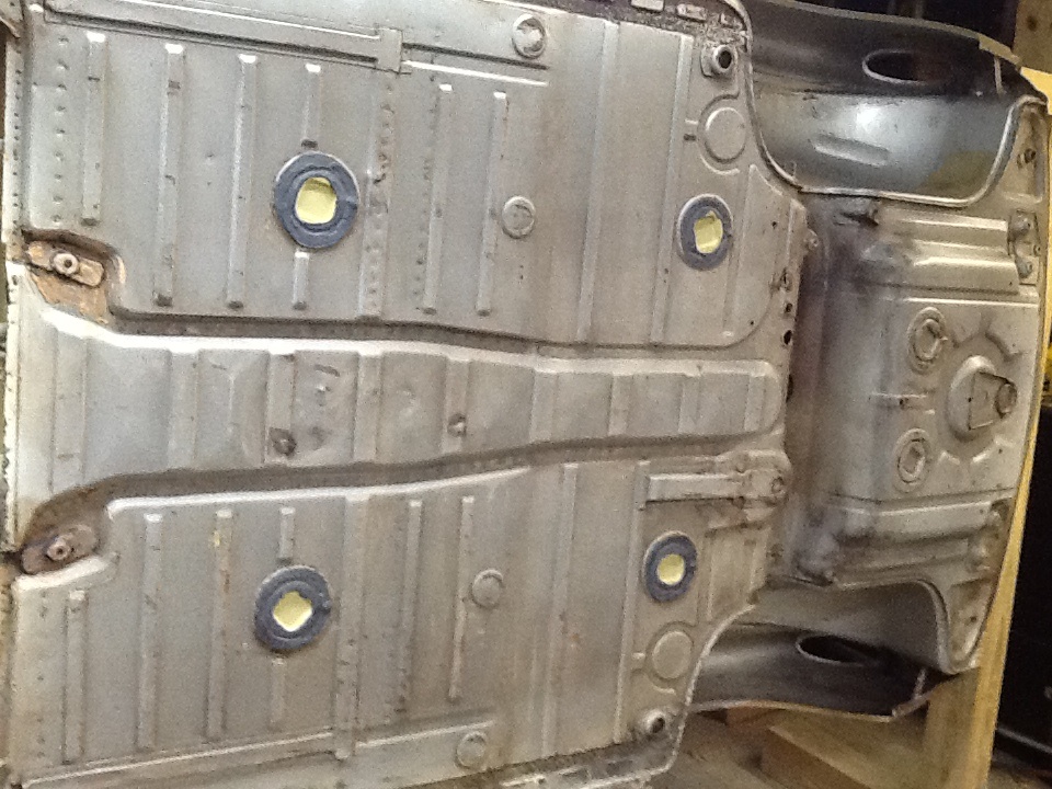

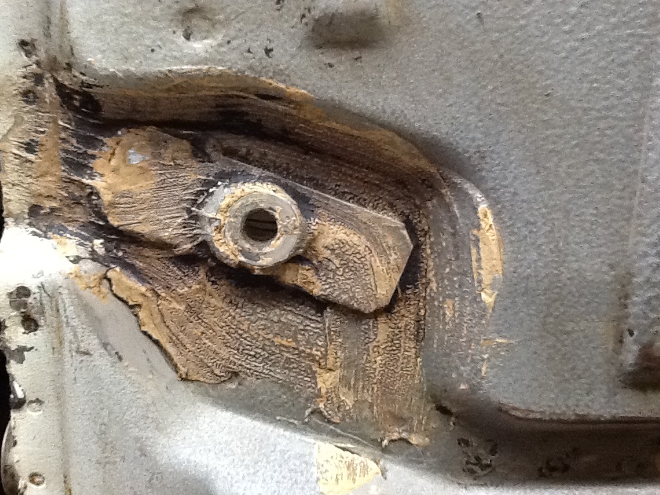

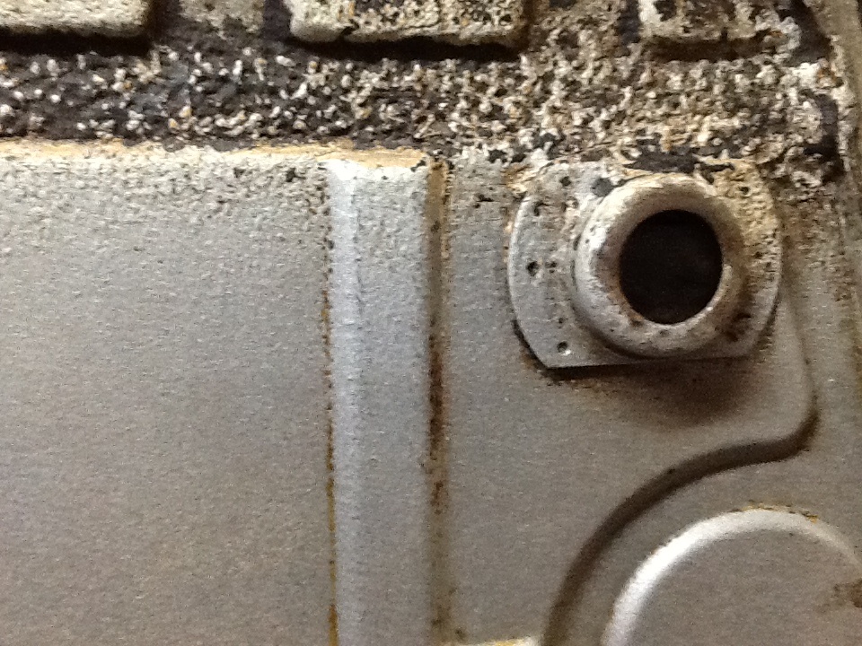

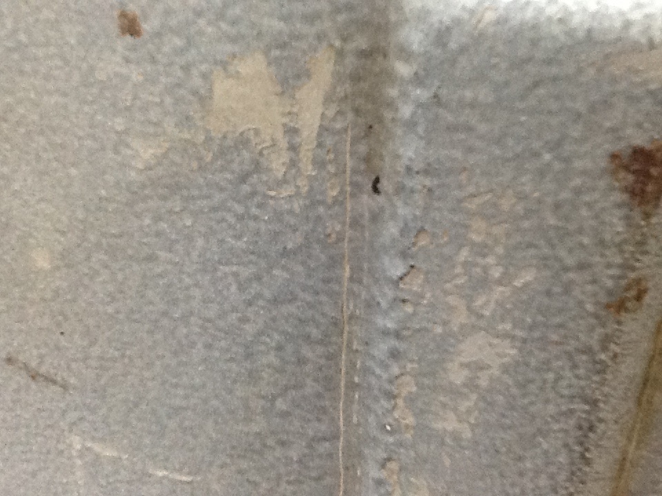

I agree, after cleaning off the black underside of my 72 - 4, this is what I found.
Underside:
Wheel housing:
Floor pan:
Under body:
Paint close And the dove gray primer:
Seam sealer
