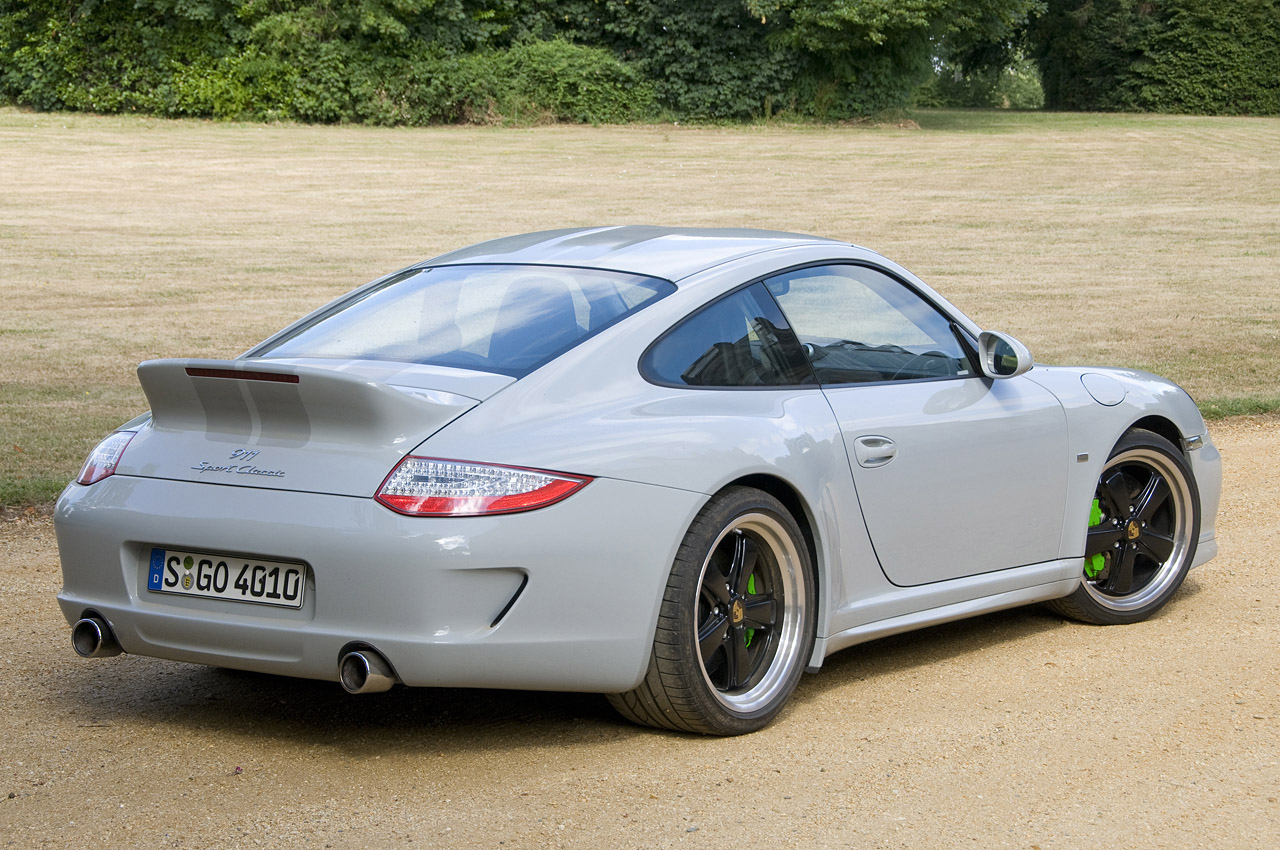

The more I look at it, the more I like "Sport Classic Gray" as a paint choice...kinda like this.
