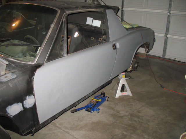

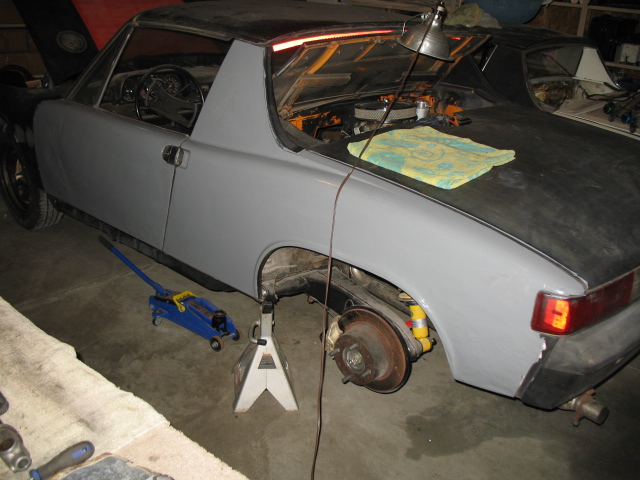

here is what 2 panels of grey gloss rustoleum look like on my car.
I am using it to protect from flash rust temporarily and I wanted to see what grey looked like on my car and it is somewhat close to sport classic grey.
