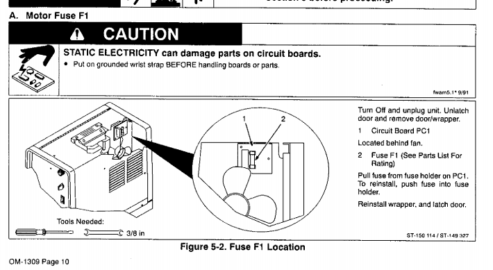

I was using .23-eg, but honestly, I found .30 easier to weld with. (It's all about the settings.)
I'm really not that pleased with the job I'm doing. I think it has something to do with the motor going kaput on me. It was skipping which really messed me up a few times. I'm going to go over the whole thing and grind it all down to smooth. I won't sleep well until I know it's right.
If you are using an extension cord make sure it is sufficient for the welder. An undersize cord will cause the intermittent wire feed you mentioned. Did you also check your wire feed roller tension?
Yup...checked both. The feed motor isn't spinning at all. I'm plugged directly into the wall. (Same plug it's been connected to for almost 10 years.) I think it's just time to get the welder serviced. I bought it used from a welding repair shop, so it's entirely possible it just needs something else. Like...a fuse? (Just found the manual...need to check this when I get home!)
