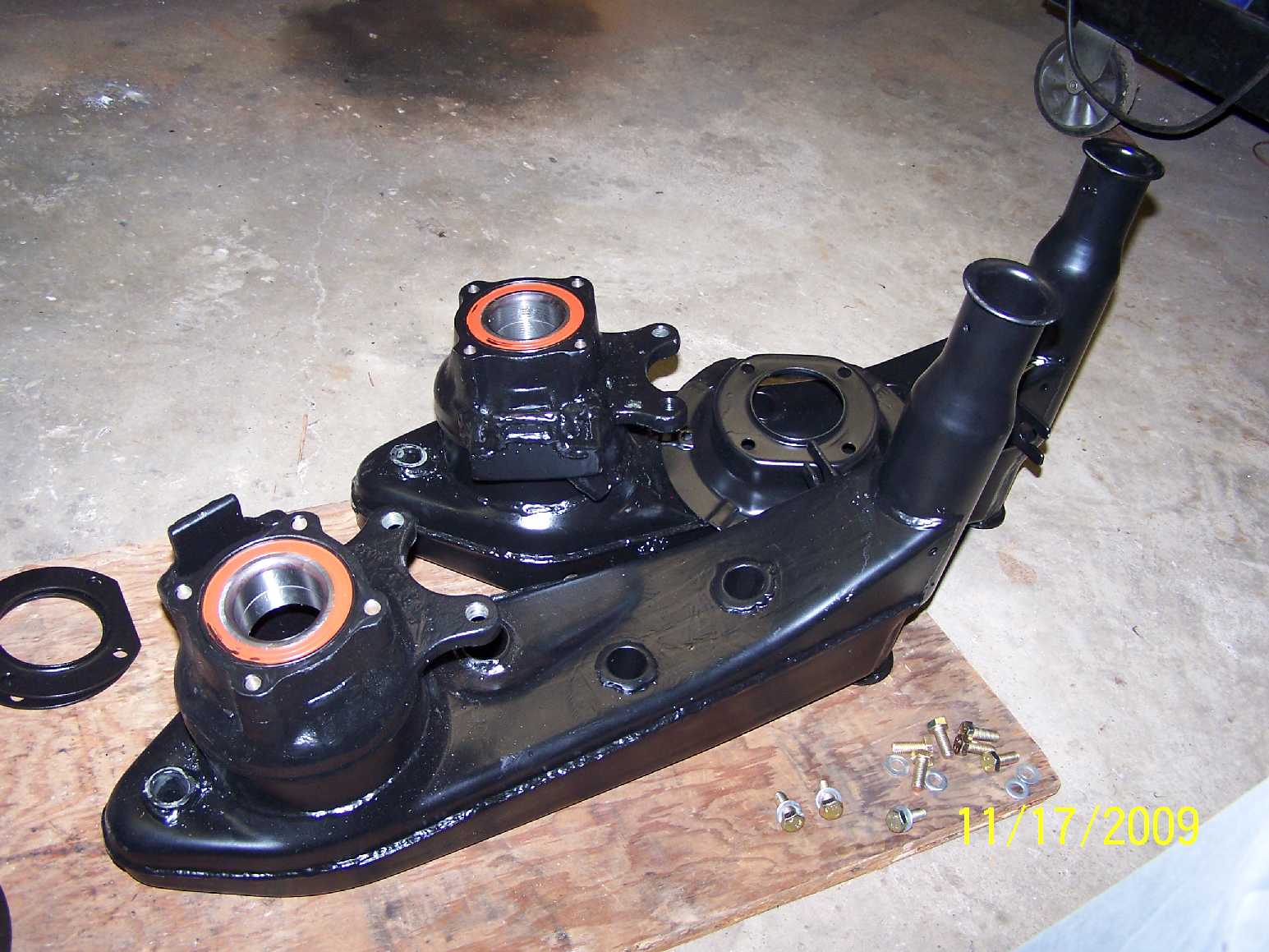

This is what I done to my trailing arms , real easy to do with 1 inch tube, a little fat on the welds , but sound.
Jack

jaxdream   This is what I done to my trailing arms , real eas...   Sep 23 2013, 08:46 AM
CptTripps   This is what I done to my trailing arms , real ea...   Sep 23 2013, 08:53 AM
jaxdream   No . set them up under a small drill press , used ...   Sep 23 2013, 09:07 AM
CptTripps   Got it...only need two. Here' what I came up ...   Sep 23 2013, 09:38 AM
jaxdream   That looks great , if you have the ability to get ...   Sep 23 2013, 09:56 AM
CptTripps   I was thinking about making 2 holes at each side, ...   Sep 23 2013, 10:00 AM
jaxdream   No racing for me either . I just had in mind ( whe...   Sep 23 2013, 10:11 AM
CptTripps   I've got a shit-ton of 1" and 1.5" g...   Sep 23 2013, 10:55 AM
